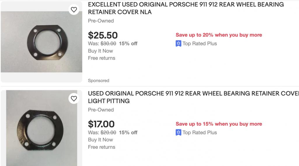

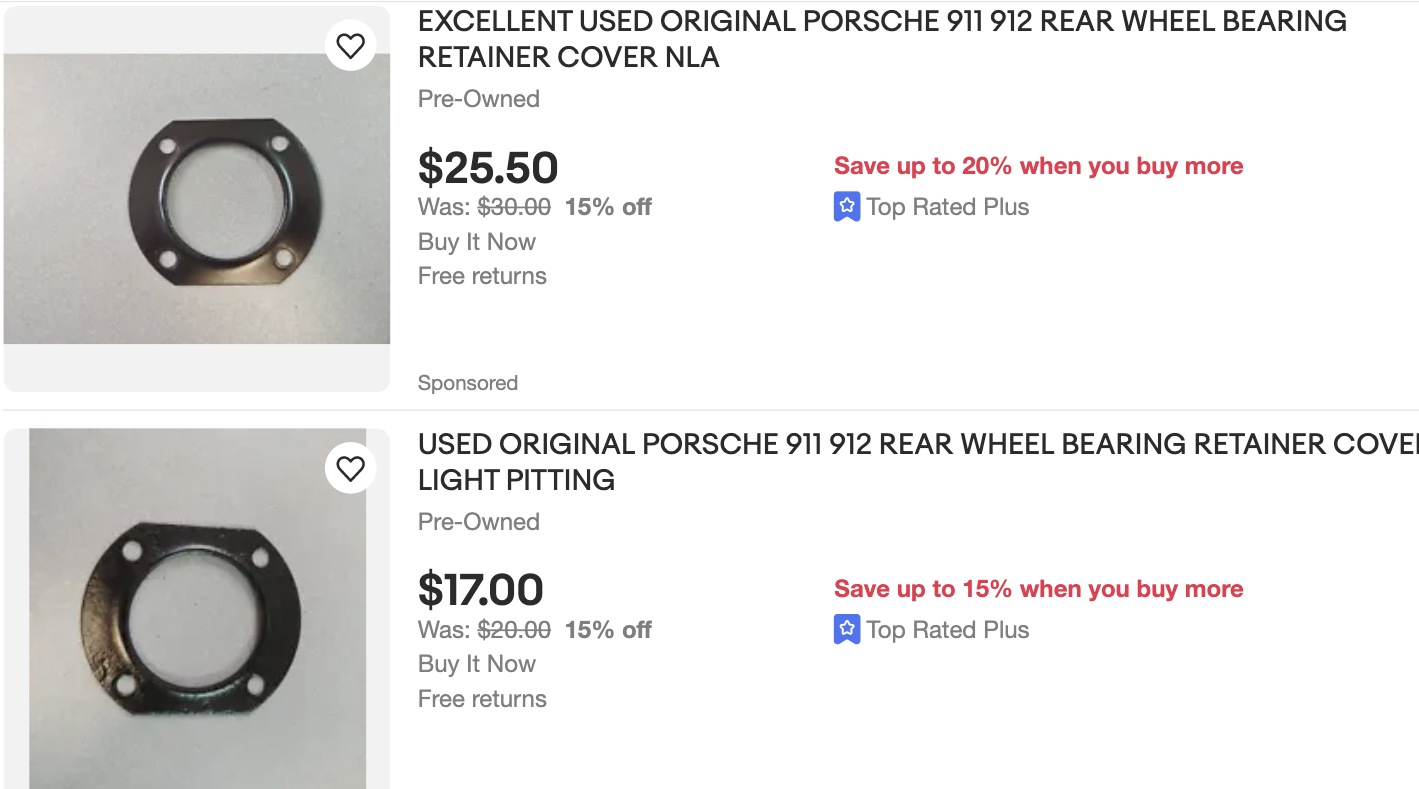

90133156100 is not available. alternatives?
Matt
post Apr 11 2023, 10:00 PM
914-6 GT in waiting
Posts: 20,625
Joined: 19-September 09
Member No.: 10,825
QUOTE(mate914 @ Apr 11 2023, 09:33 PM) *
Matt
Amazon, ebay, ect
