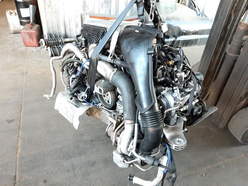

This swap is a possibility for a build I have in mind. One issue is the factory location of the turbo and associated plumbing. It's all left side, at the front of the engine. Not a great spot for fitting in the 914 chassis.
Not that there isn't a way around it but it's not just the width thing.

Or you could just buy a 718 Turbo 4 Boxster/Cayman, Drive it, (they are rocket ships and handle phenomenally) and leave the 914 alone.

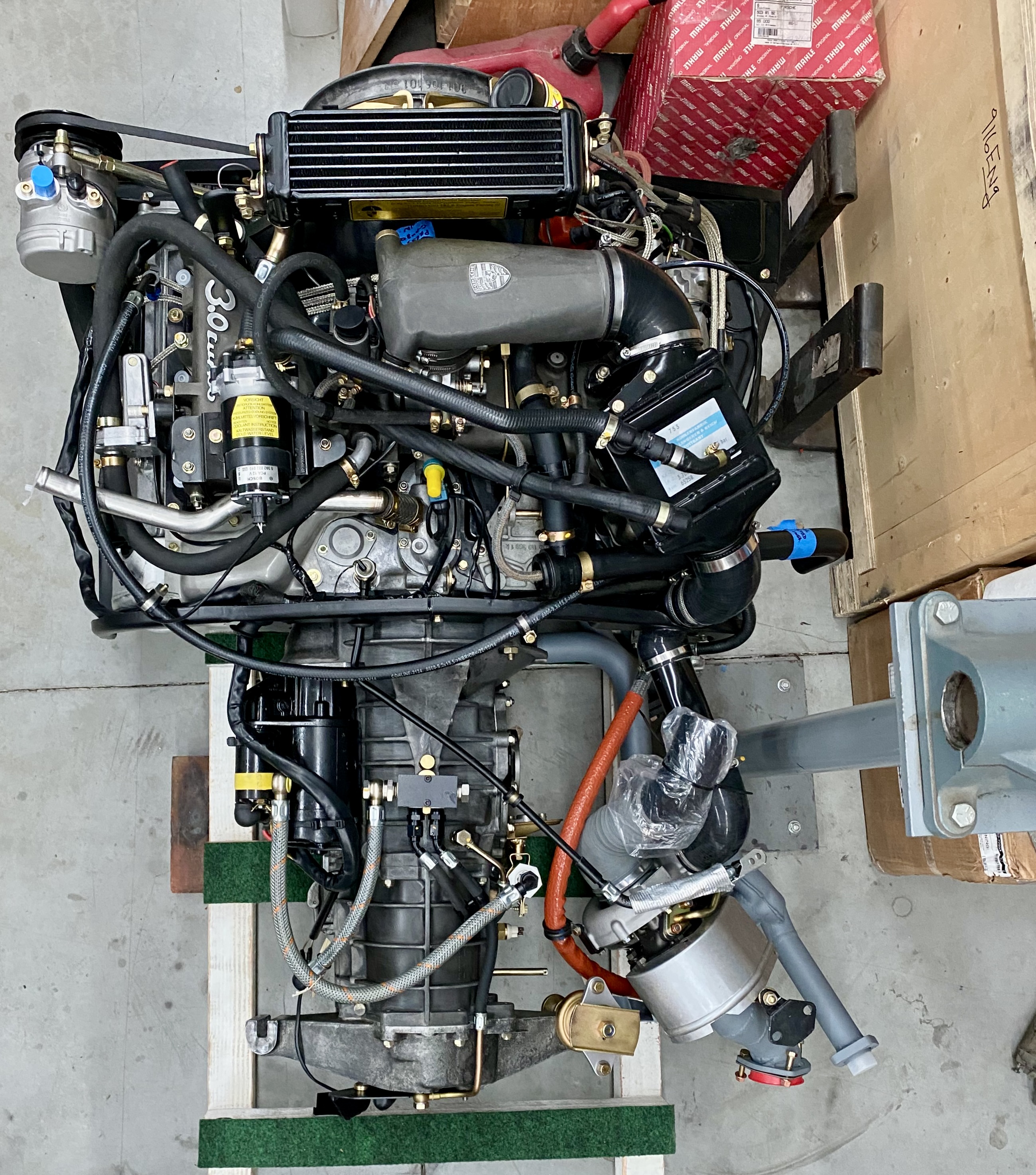

Turbo 914-6 in progress....

QUOTE(aturboman @ May 5 2023, 01:03 PM) *
@aturboman
OK! so where is you build thread for this cool project??

aturboman
post May 5 2023, 01:20 PM
Posts: 151
Joined: 18-October 11
From: CA
Member No.: 13,687
Crankcase and bottom end is different but you can easily turbo an SC engine as well
