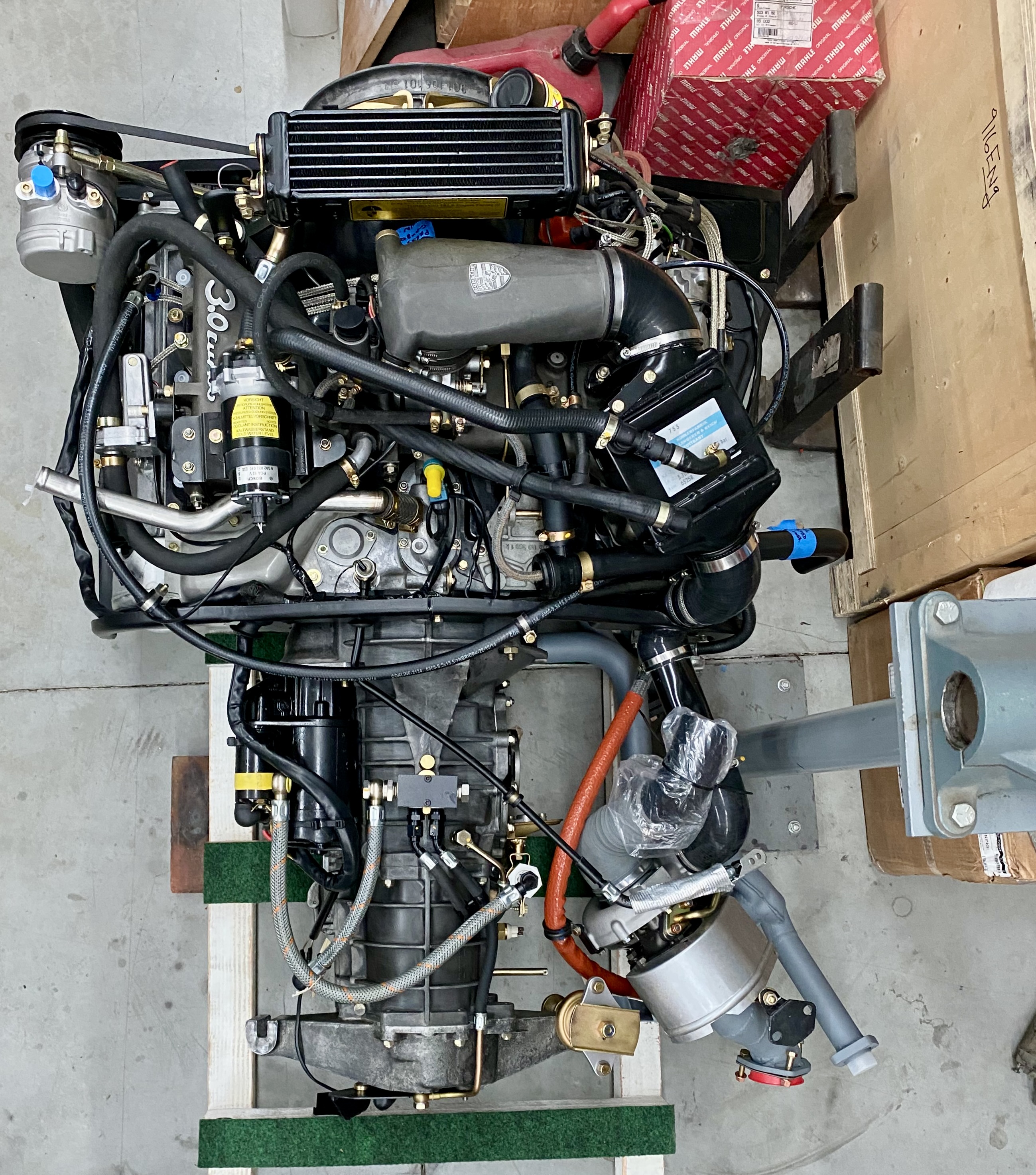

Turbo 914-6 in progress....
burton73
Wow! loving this.
Bob B
DRPHIL914
QUOTE(aturboman @ May 5 2023, 01:03 PM) *
@aturboman
OK! so where is you build thread for this cool project??

aturboman
Crankcase and bottom end is different but you can easily turbo an SC engine as well
