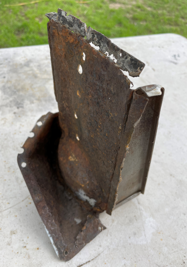

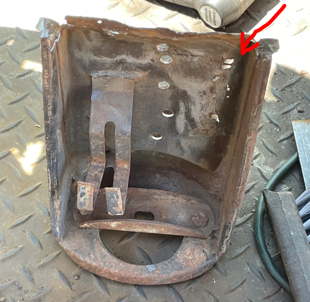

After removing the engine mount from my passenger side (hell hole), I decided it might be fun, as a side project, to try and restore instead of replace this item. Not sure if anyone else has ever tried this (I'm sure they have) but I'm thinking... why not. Famous last words! So, here we go....
View of the engine mount pulled out of my very rusted out '74 LE. Note the rust (red arrow) on the back.
Beginning the process of drilling out the many spot welds around this two-piece, 14 gauge metal part.

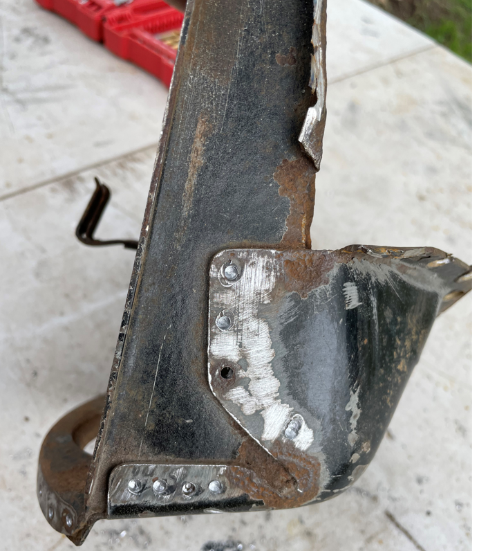

After a bit of drilling, I was finally able to remove the two pieces. These went into a rust removing bath before each piece was individual restored.
Here's the bottom piece with the three facets replaced. I actually used POR-15 in this area before the later reassembly.
Removal of the rusted metal from the top part of the second piece.

After cutting the new 14 gauge sheet metal, measurements where made and a metal brake was used to create the three simple 90 degree bends.
Here's the part welded on. Note the rust holes on the other section.
The bottom section with the metal replaced and welded in.
