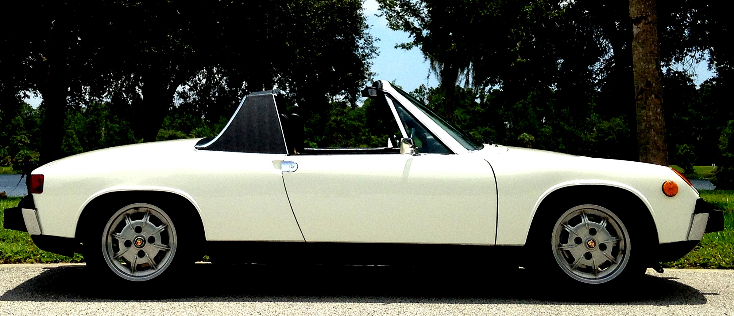

You can always run the Bumperettes from a 75 on the early bumpers for a cleaner look.
Yup.....It's what I've done,
except, be aware the mounting holes are vertical on the 75-76 bumpers,
73-74 front bumperettes are horizonal .
meaning drilling extra holes. (IMG:style_emoticons/default/dry.gif)
it's ok on my front bumper, it was previously was in some form of accident with the original bumperette .
slightly dinged up,
the 75-76's bumperette from 75-76 Cali, REAR bumper covered pretty good.
Literati914

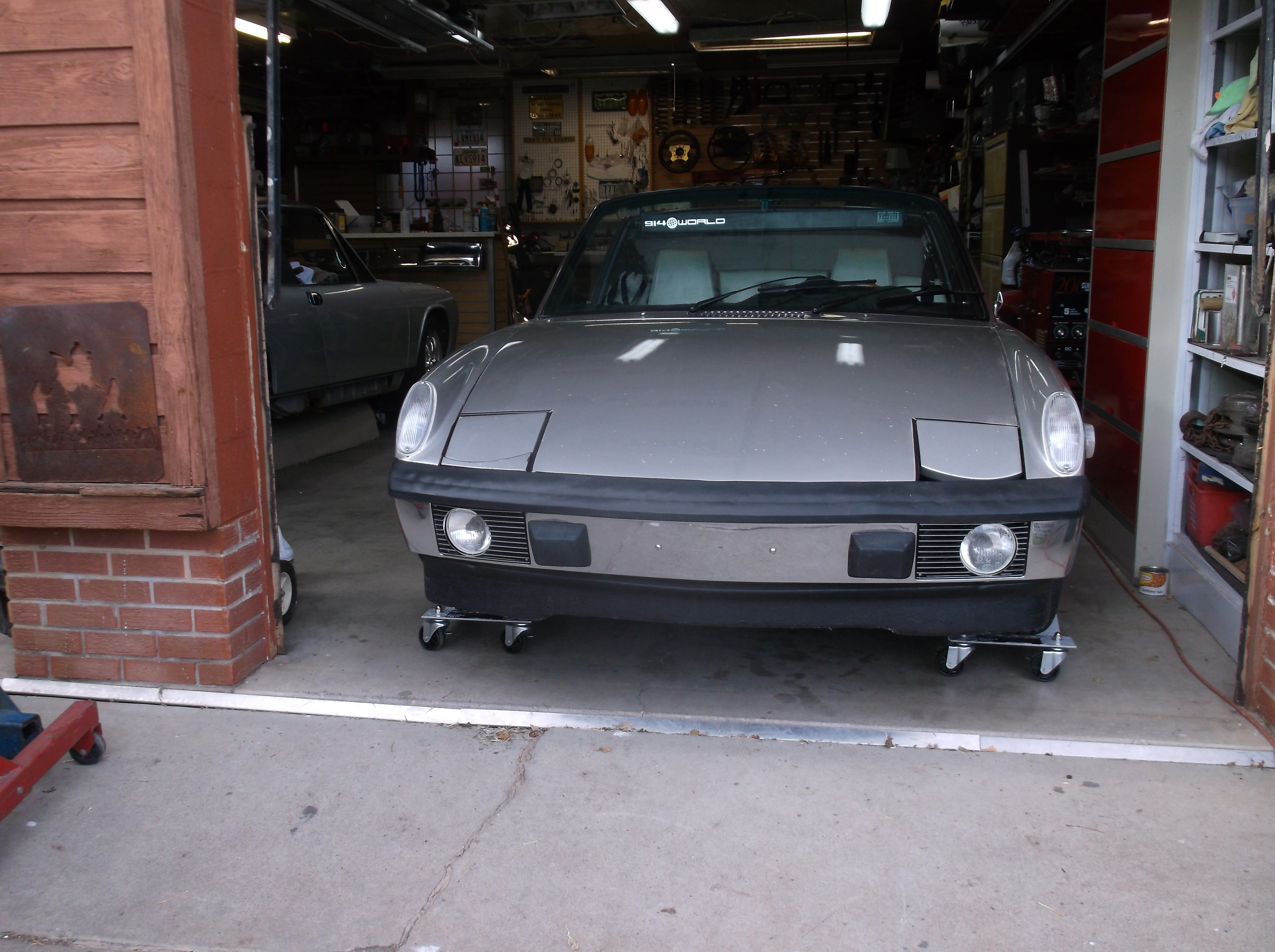

I have a '74. Due to my VERY limited garage space, I put a set of shorter '74 rear bumperettes on the front of my car. They fit perfectly and it takes a very critical eye to notice they are rears on the front. Therefore, I see no reason why fronts would not fit on the rear perfectly.

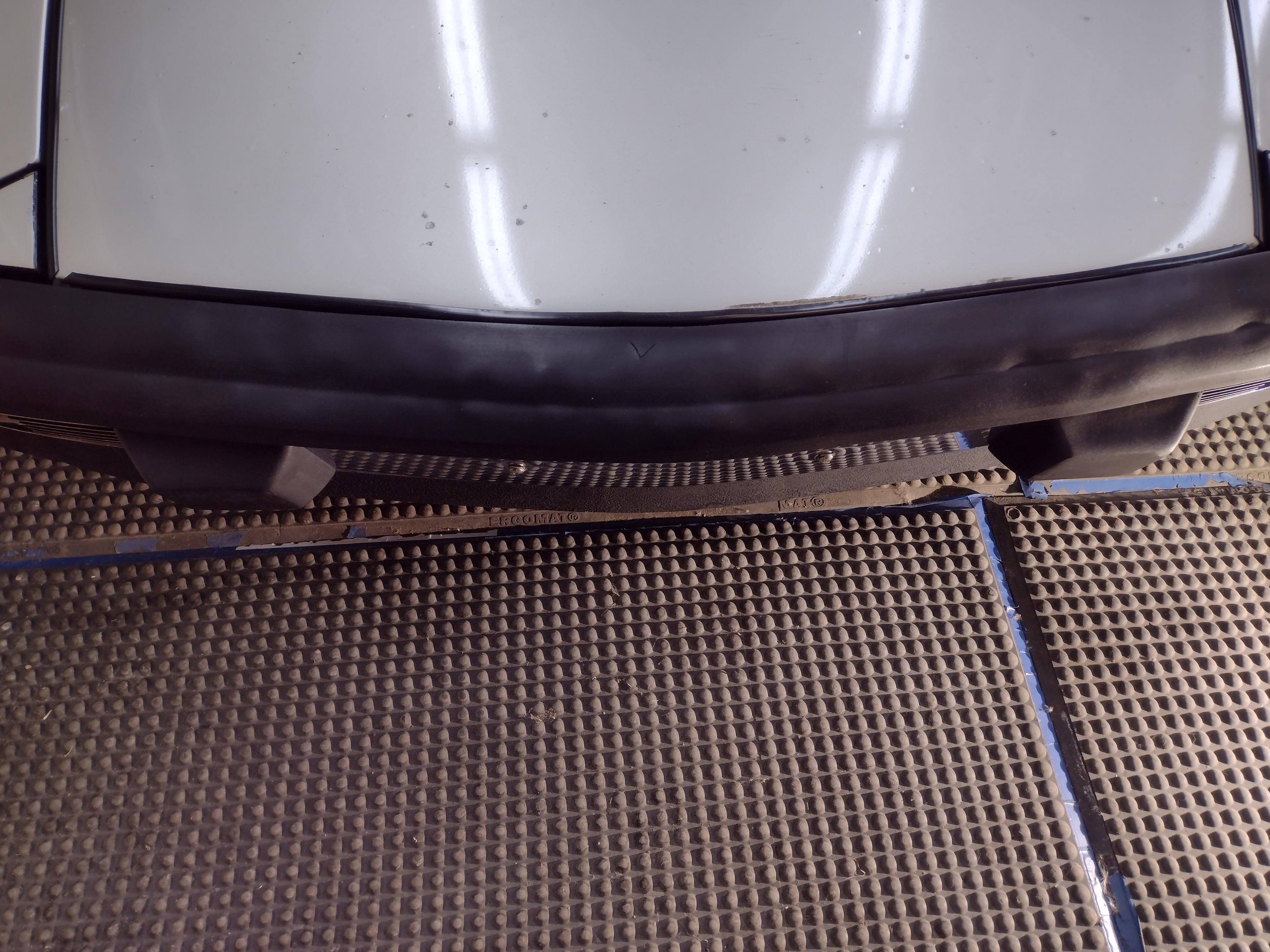

Without a vertical overhead view, it appears the rear bumperettes mounted on the front don't have much extension to provide desirable protection? I value the length of the original front "tits' on my 73 that have prevented a potentially damaging bump or 2 in practice, although I did have to replace one that was damaged. (IMG:style_emoticons/default/confused24.gif)

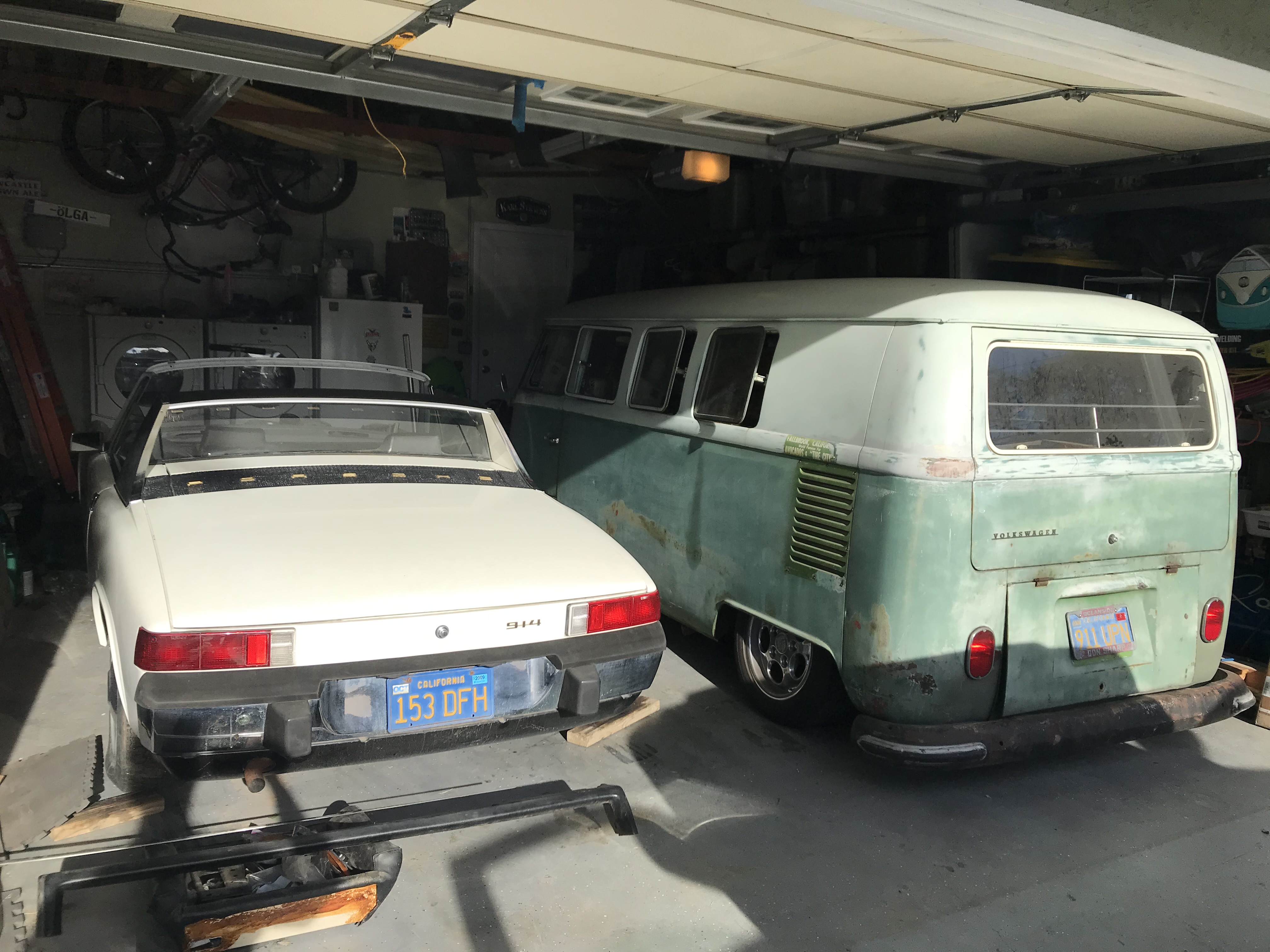

My car came with this set up, closer together than a stock 74. I like the look of this location better than the factory spot. Not sure if they are front or rears, my car is a 71 so shouldn’t have them
That closer spacing is interesting.. since I have a bumper to mod anyway I'm gonna give that some consideration, thanks for the pic, it'll be handy for comparison!

overhead view.
Barley 1/4 space between front curvature of bumper and a straight level on Bumperettes

QUOTE(majkos1 @ May 26 2023, 12:35 PM) *
overhead view.
Not much protection there. (IMG:style_emoticons/default/bootyshake.gif)
