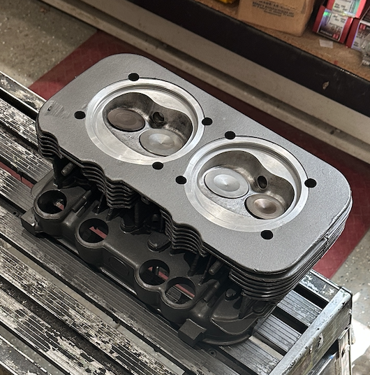

I am happy with the way the Cerakote went on and how it covered.I am liking the color too. The prep was pain staking as the cylinder still felt sticky like a wax. The acetone and a deep bristle brush seem to take care of that. And now to wait 5 days for curing ....Cheers

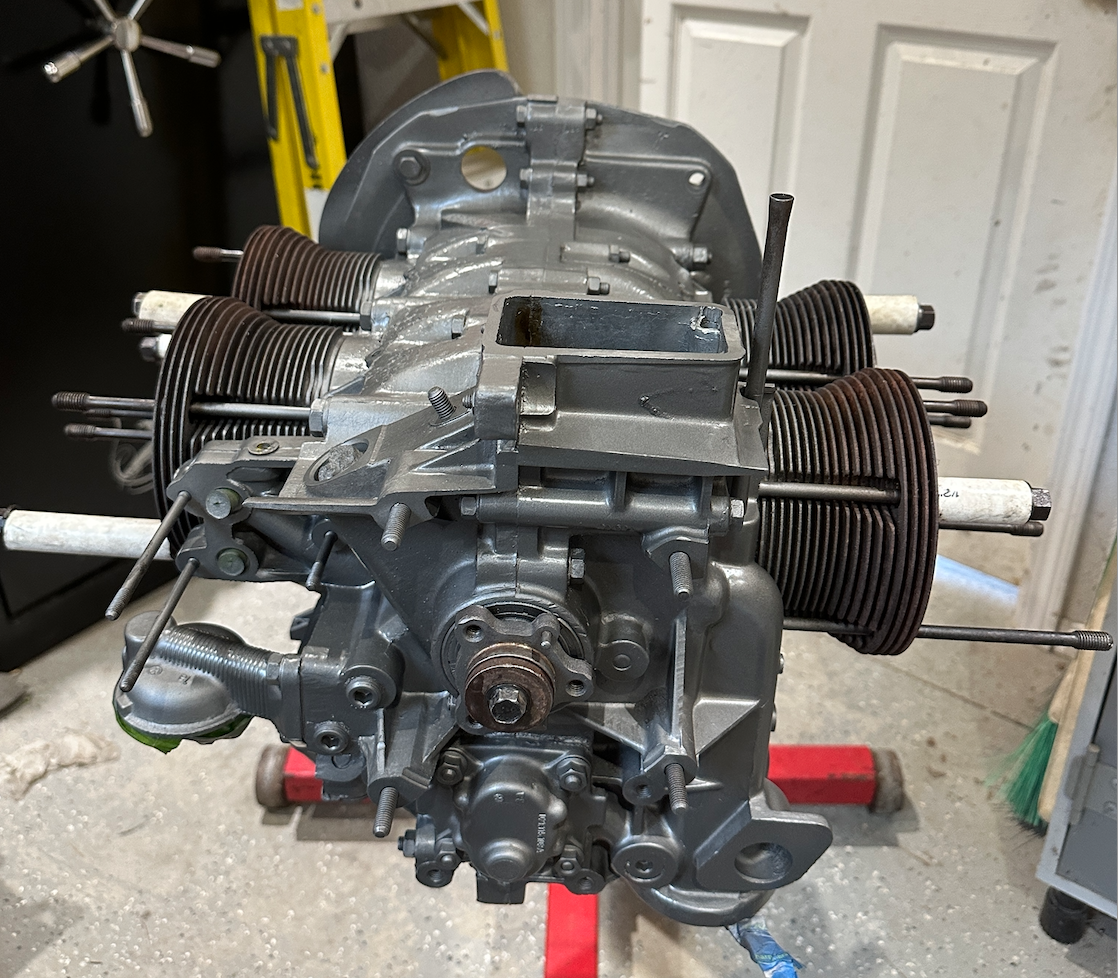

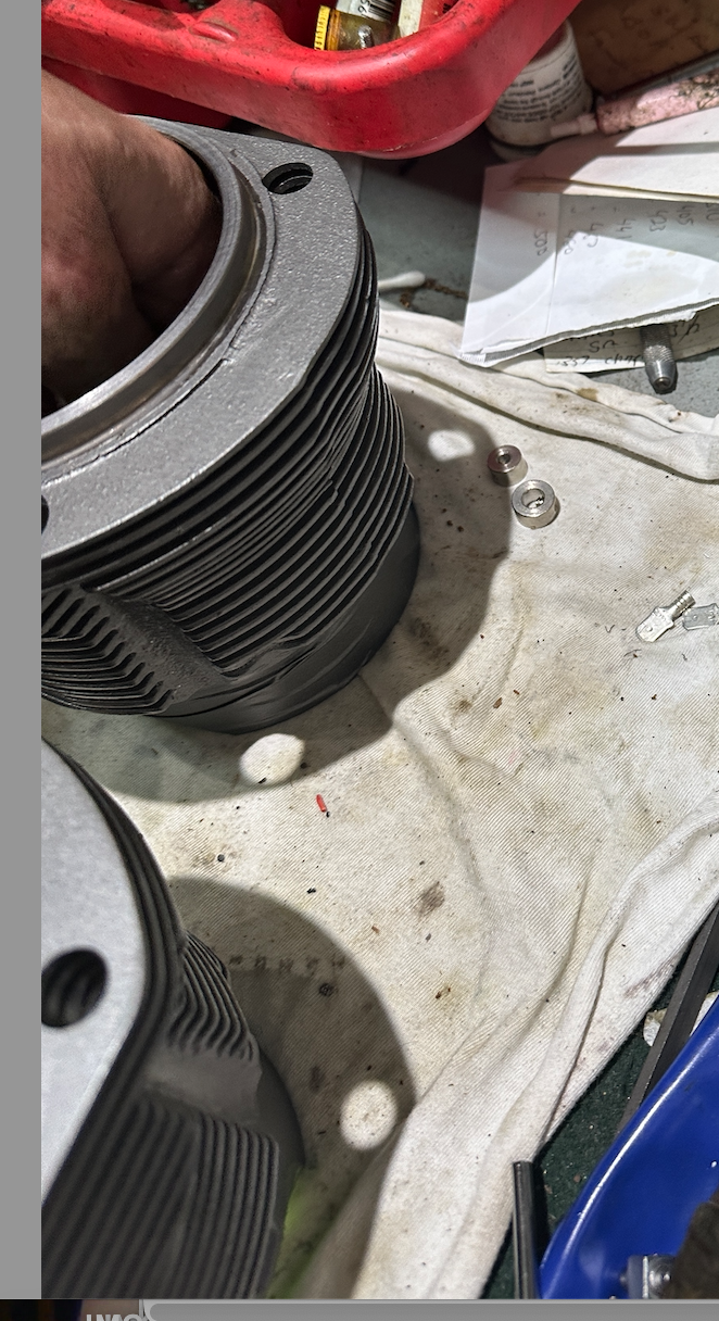

WOOHOO...I got the case Cerakoted today. The 4 oz was just enough to get the job done (less the trans side of the case) Had I not been so generous on the heads and cylinders , there is more that enough in the sample 4oz size. I did use an old set of jugs to keep the paint of the register so I did not have to mask...This works out well..pics to follow in 25 hours cure time or sooo....
-Cheers

here: Charcoal gray transfer CeraKote
