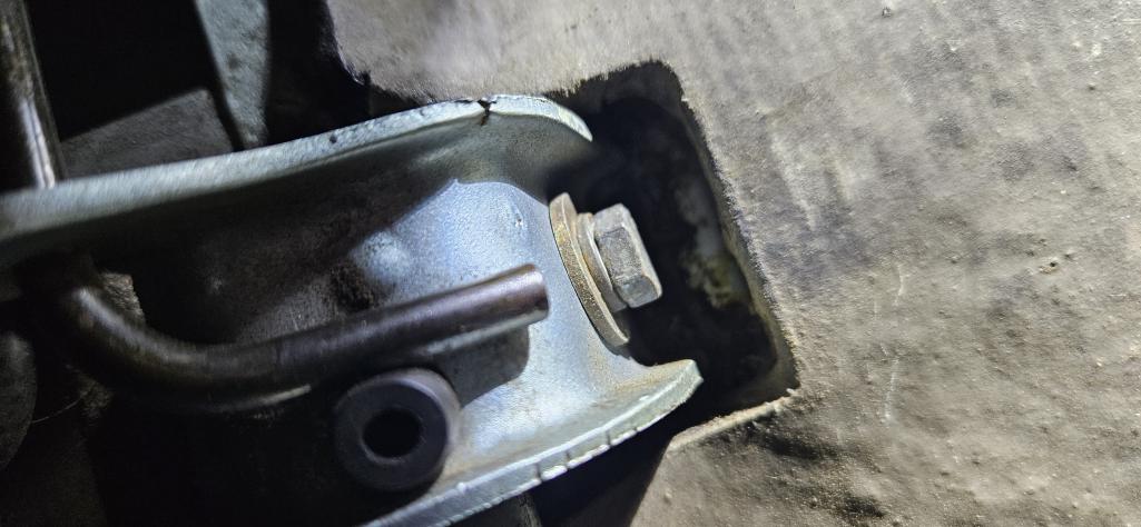

Here is what I have on my 74 1.8L.

QUOTE(L-Jet914 @ Jul 23 2023, 11:26 PM) *
QUOTE(mcswiggs @ Jul 23 2023, 03:43 AM) *
‘..not sure’ - not ‘now sure’…. Sorry.
Lovely, that’s perfect, thanks very much.
