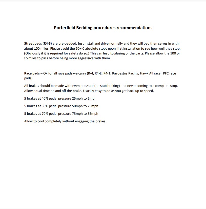

MM1
post Jul 24 2023, 11:28 AM
914 obsession continues
Posts: 619
Joined: 9-May 18
From: Thousand Oaks, CA
Member No.: 22,105
Re: Porterfield R4-S brake pad OFFICIAL break-in procedure.
I recently installed Porterfield R4-S pads on my 914 V-8 (along with a new 19mm master cylinder). Please note it has the BMW 320 caliper conversion on the front. Yes, the 19mm master feels good to me (subjective preference) and the brakes improve with nearly every stop as I am nowhere near the 100 mile (apparently correct "no-hard-brake") break-in procedure. For reference, the very old and leaky 19mm master cylinder would easily lock up the BMW 320 front calipers with only a bit more than moderate-to-firm pressure.
My research showed that a "standard" break-in procedure is incorrect.
As hearsay from the "interwebs" is useless, I just contacted Porterfied directly after reading this thread. I requested the official break-in procedure for R4-S pads. Below is the text from said .pdf as well as a screen shot of the .pdf Porterfield just sent me:
" Porterfield Bedding procedures recommendations
Street pads (R4-S) are pre-bedded. Just install and drive normally and they will bed themselves in within
about 100 miles. Please avoid the 60+-0 absolute stops upon first installation to see how well they stop.
(Obviously if it is required for safety do so.) This can lead to glazing of the parts. Please allow the 100 or
so miles to pass before being more aggressive with them."
The text above is included so you can copy and paste it to all of your friends (since you don't have the time to call Porterfield), who have already glazed their "parts" with the "standard" break-in procedure. (IMG:style_emoticons/default/blink.gif)

We always bed Porterfields. We're their second largest retailer. And I've spoken with Porterfield about the pre-bed pad scenario. I asked how they pre-bed them and they simply state it's not needed. Basically, the friction numbers come in at a lower temperature. We don't necessarily agree that an "un-bedded pad" is "pre-bedded" but... therein lies what some call "heresay". It never hurts to bed your pads as there are other benefits that come along with it.
Bedding the pads seasons the rotors. Fact.
Bedding the pads breaks in the new caliper seals. Fact. and,
Bedding the pads decreases the stopping times... even on "pre-un-bedded" Porterfields.
We've never, ever glazed a pad. That's our "real world experience" not from the interwebs.
