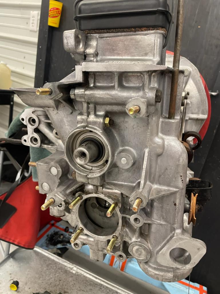

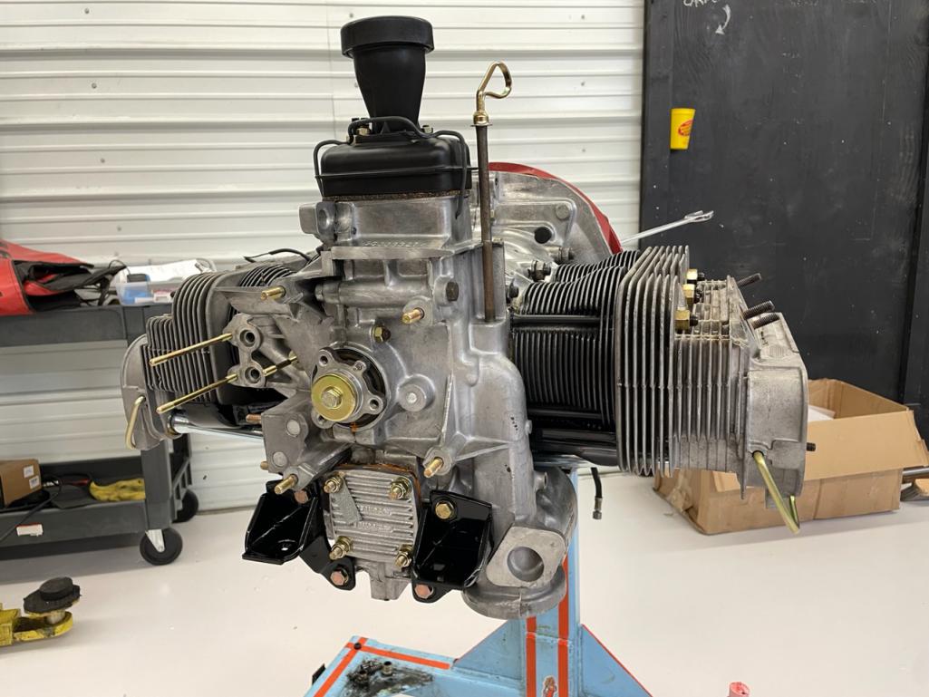

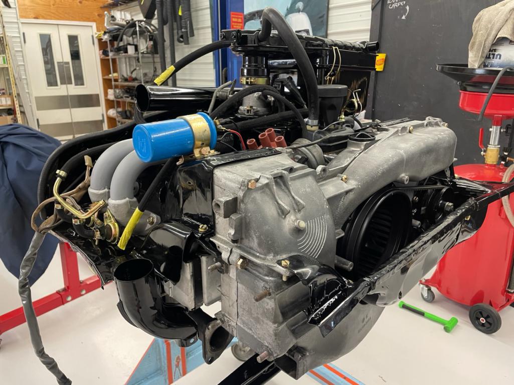

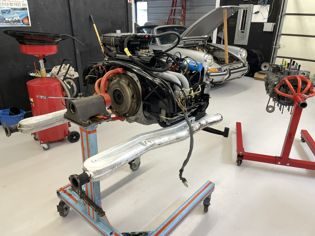

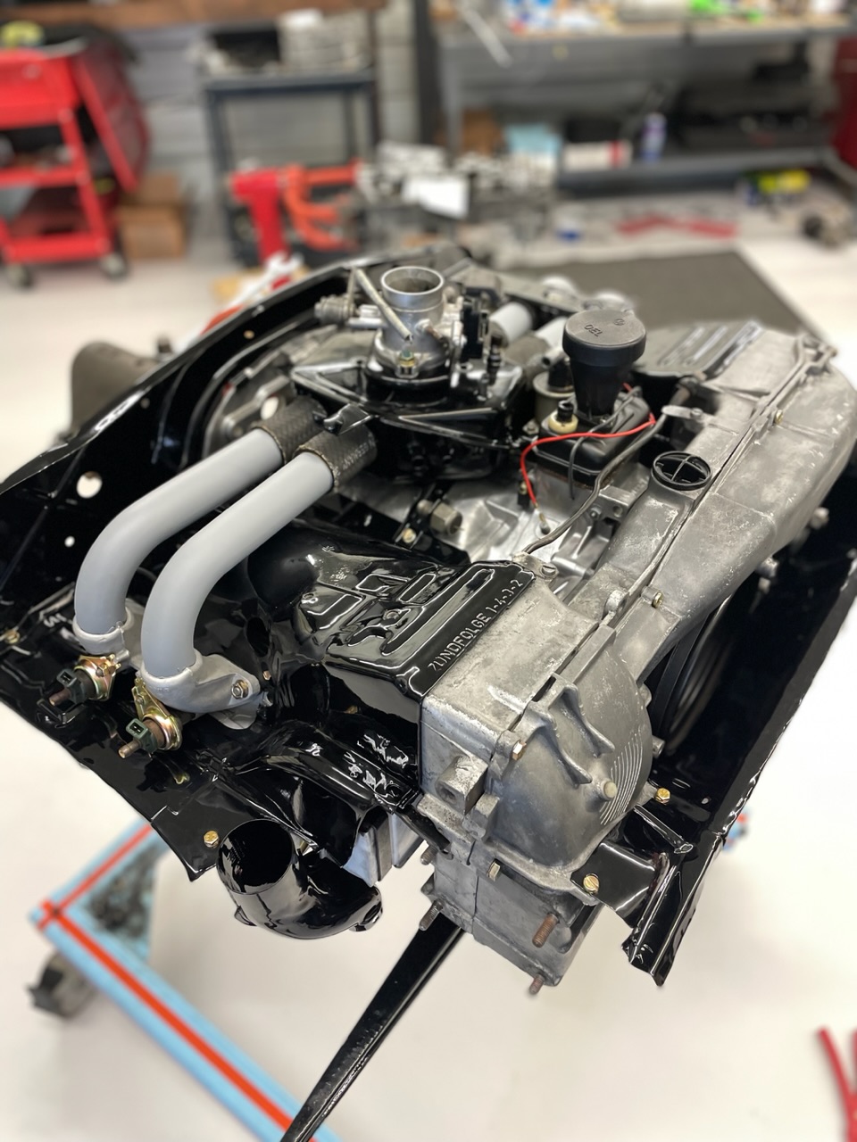

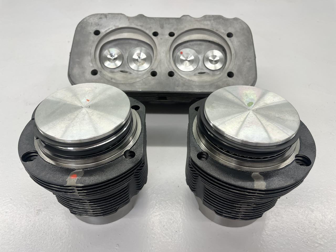

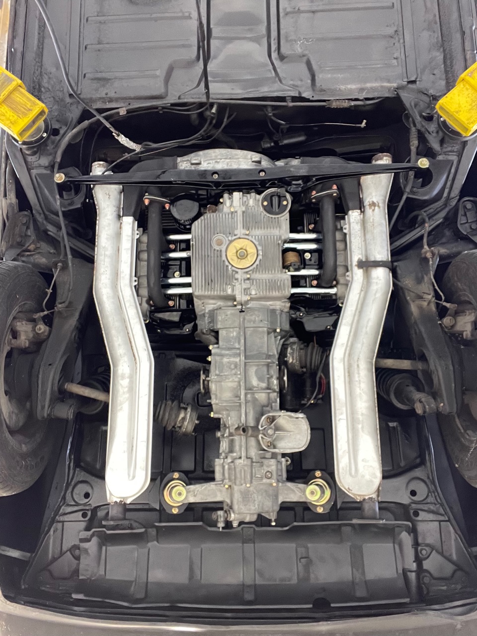

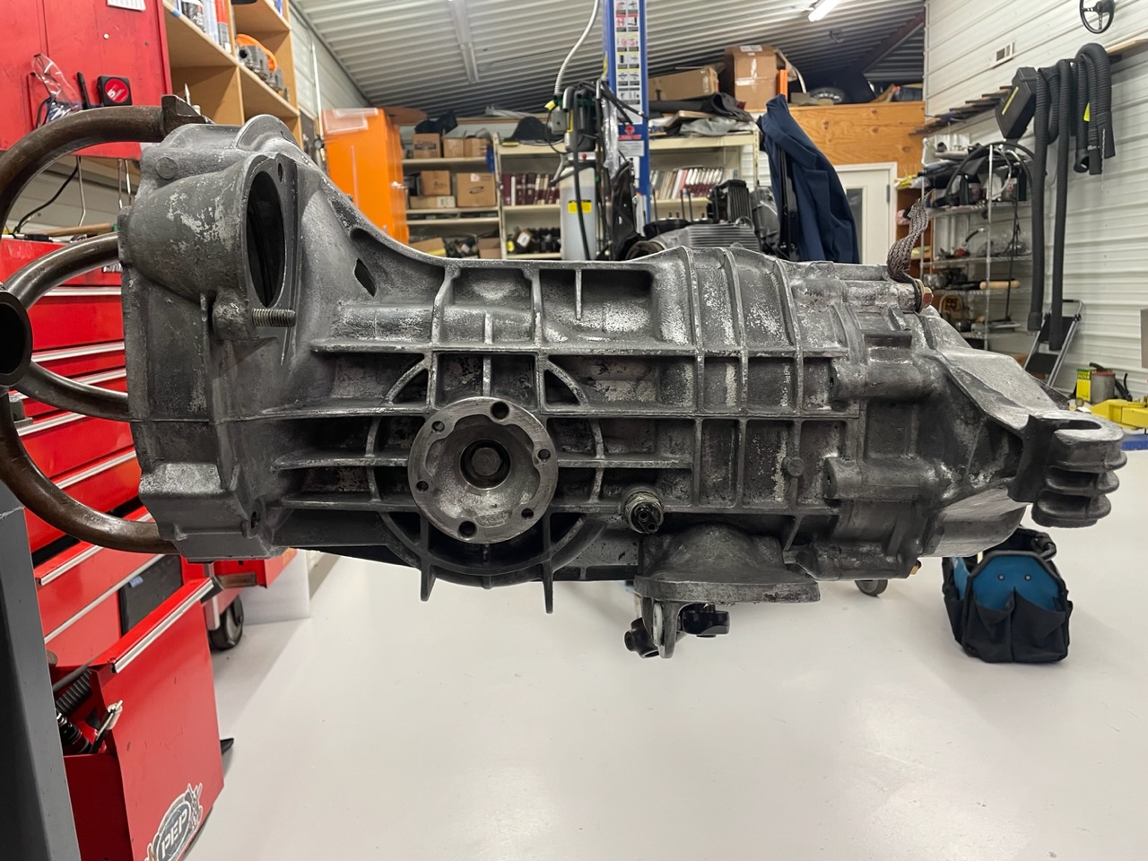

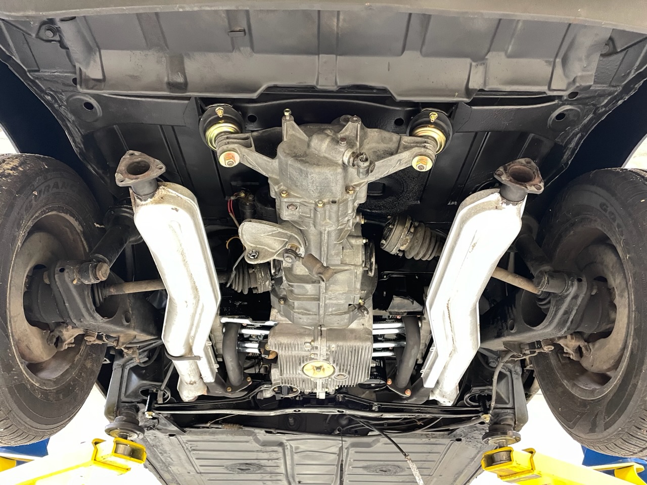

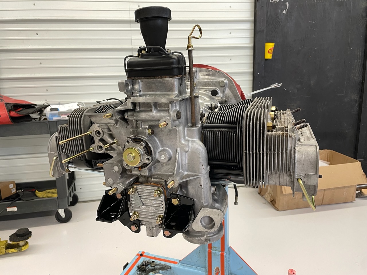

I recently acquired my first 914. It’s a 75 2.0 that is mostly original. Here are some photos of my recent rebuild for those who would like to browse!Attached Image Attached Image

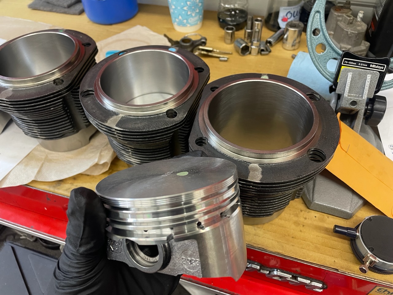

Original cylinders bored 1mm over. Keith black mercury pistonsAttached Image

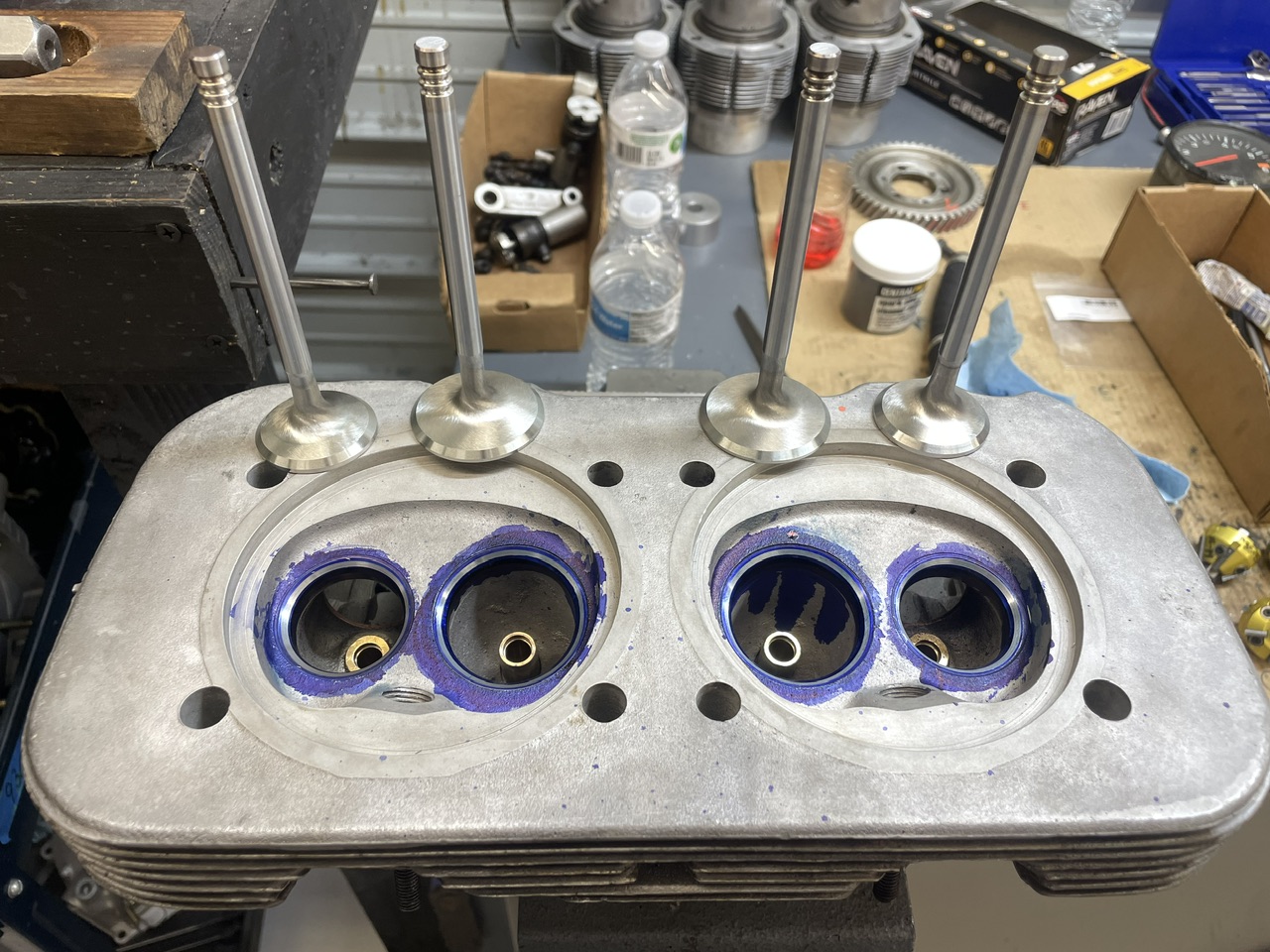

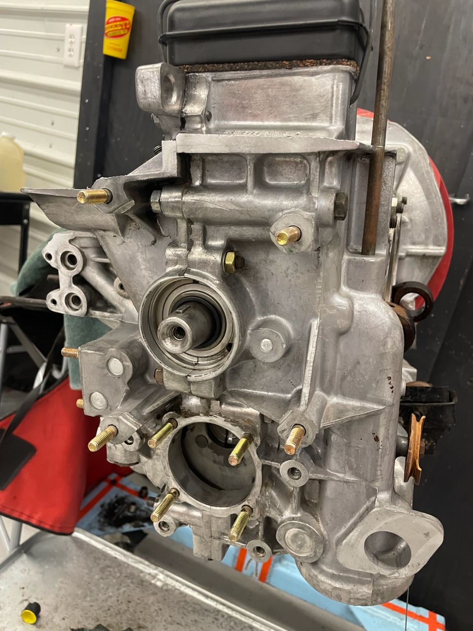

Neway valve job SI valvesAttached Image

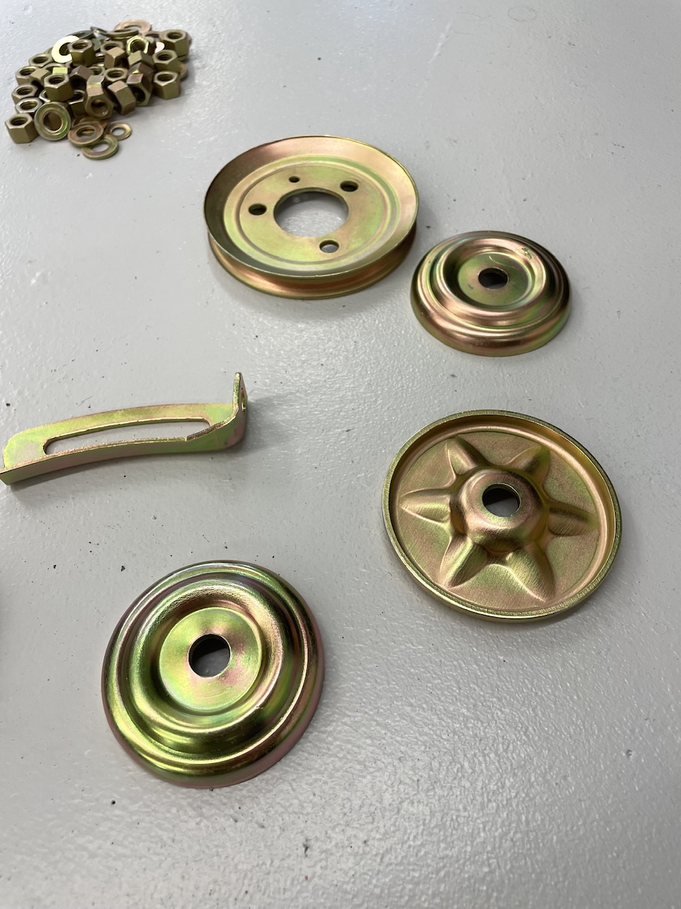

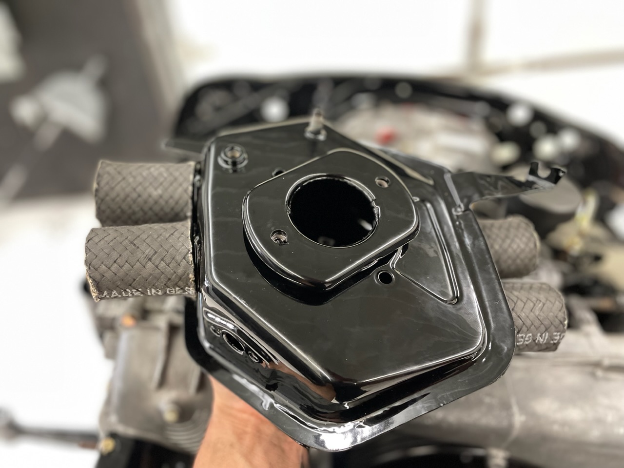

Yellow zinc everything because I LIKE it!!Attached Image

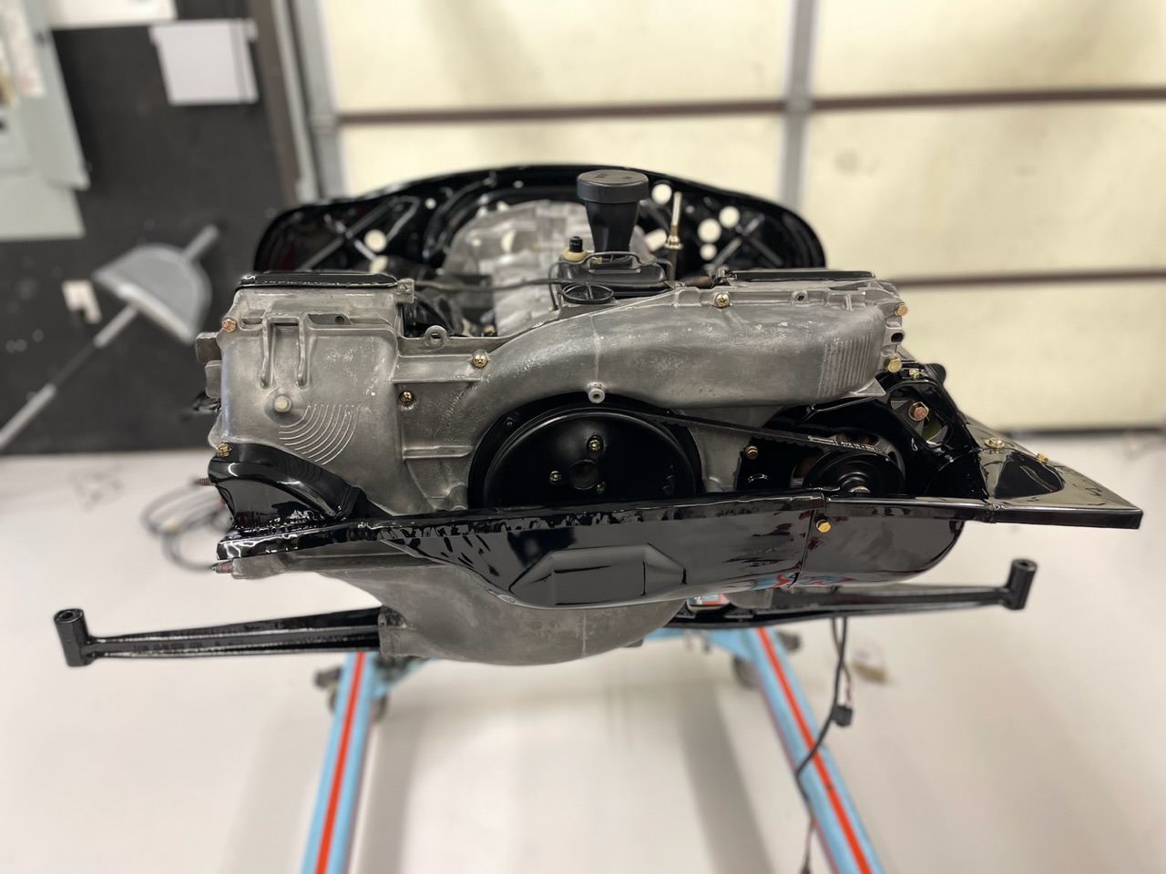

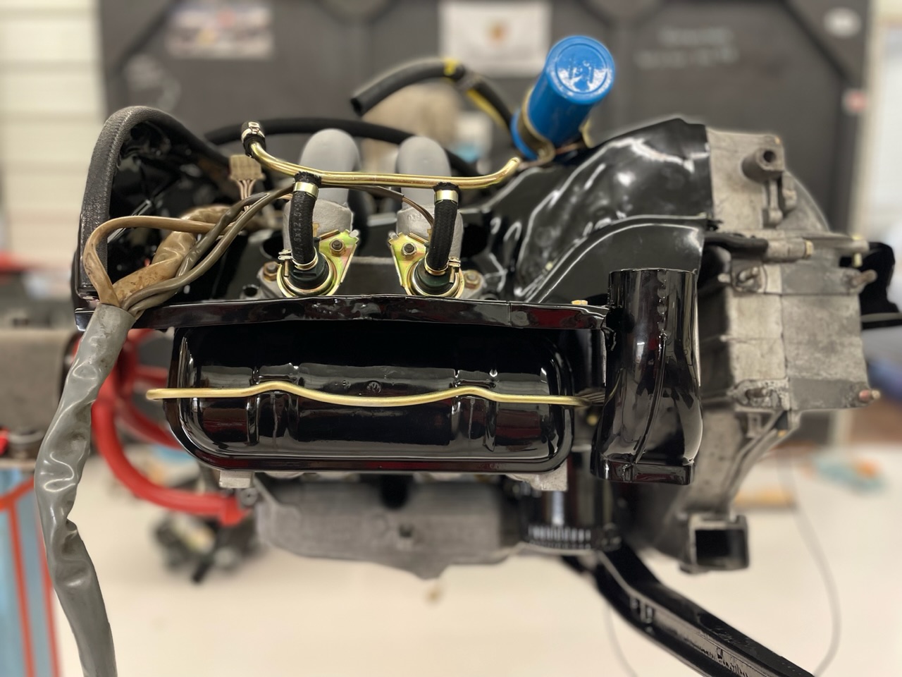

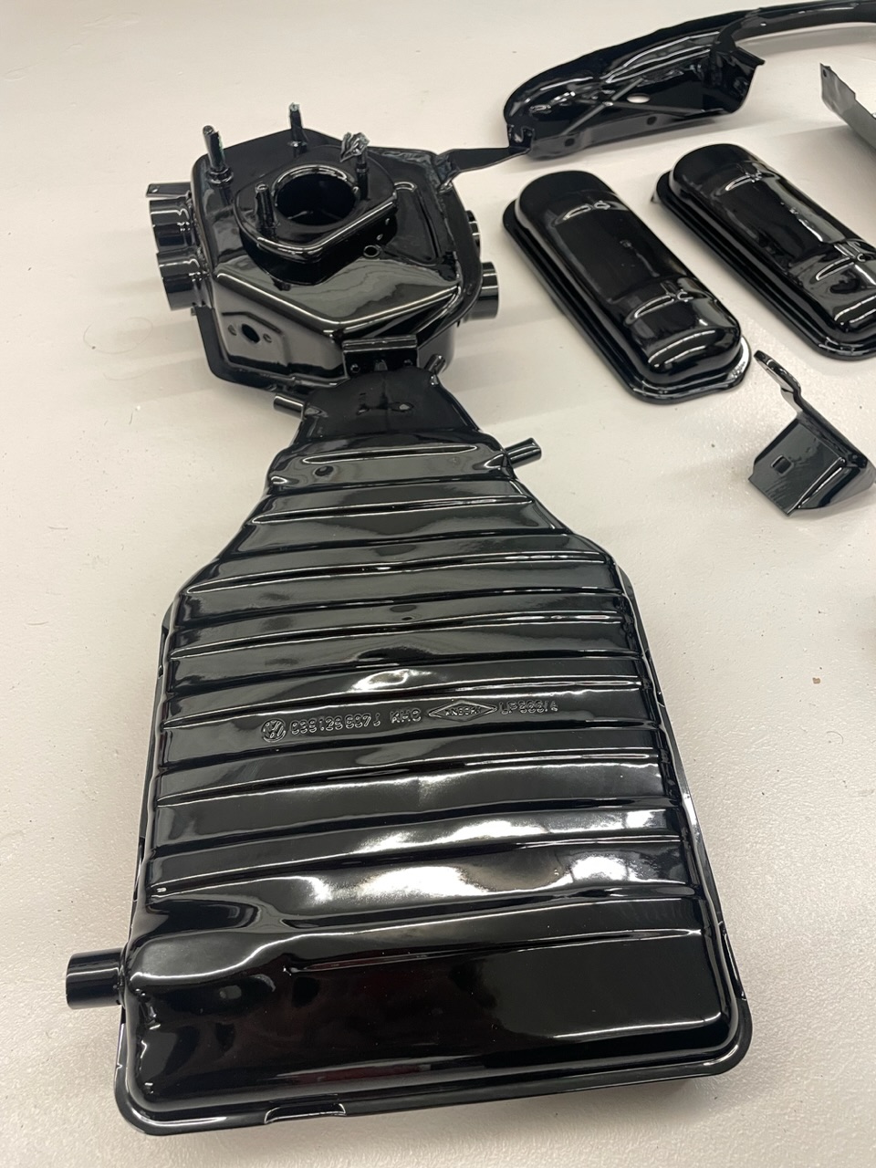

Gloss powdercoatAttached Image Attached ImageAttached ImageAttached Image[attachmentid=882
858]Attached Image

Nice looking engine! (IMG:style_emoticons/default/smile.gif)
Looks like your gearbox shifter input lever (with the sphere) was installed 180 degree off maybe? (IMG:style_emoticons/default/confused24.gif)

QUOTE(Montreal914 @ Jul 26 2023, 09:56 PM) *
Thank you and yes to the shift lever haha figured that one out as soon as I tried to hook up the shift rod…914 newb

Here is a link to the engine specs if anyone is interested. Compression came out to about 8.9:1.

Here are some more shots of the projectAttached Image Attached Image Attached Image Attached Image Attached Image Attached Image Attached Image

Dave_Darling
post Jul 28 2023, 05:56 PM
914 Idiot
Posts: 15,367
Joined: 9-January 03
Member No.: 121
Do yourself a favor and ditch those heat exchangers. They are really very horrible. I mean, they look great, but their design is pretty terrible. The earlier ones may not be exactly amazing for power, but they are a lot better than these. Two pipes that join straight out of the head, no thought to equal lengths, make an almost immediate tight 180-degree turn? That flies directly in the face of pretty much all the principles of good exhaust design.
If you want heat, use the later-style 2.0 exhaust, or SSIs. If you don't need heat, talk to Chris at Tangerine Racing.
Oh, and you'll need to pull the gear selector (and side shift console) off the gearbox and flip around either the rake or the knob part, because they're 180 degrees off from where they should be.
