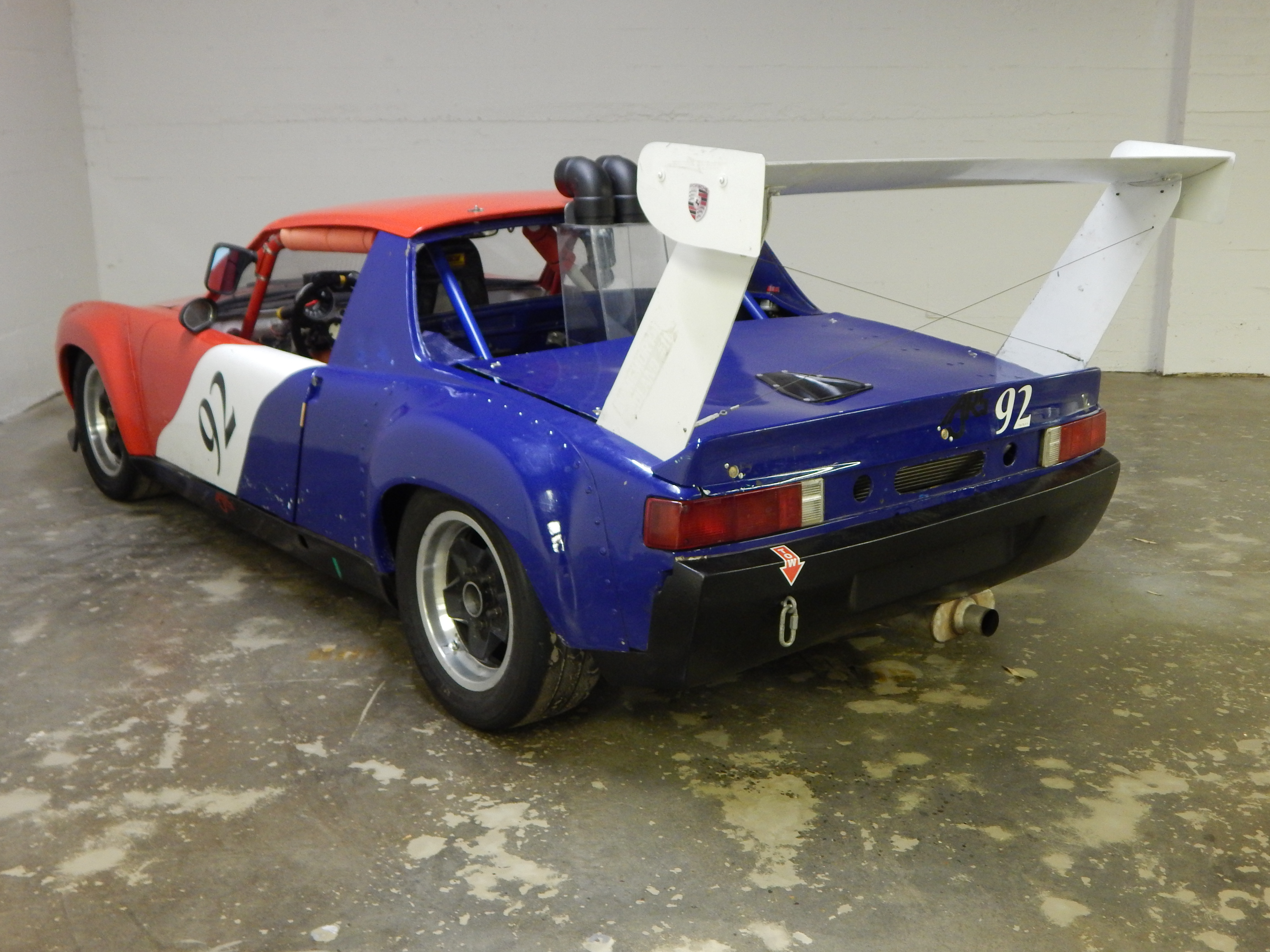

Wing has been on this car for a while….but my son prefers something a bit more conservative. As I evaluate it, height may be a bit much.
In reference to roof, where should it be. Not constrained by any rules….
Anyone with knowledge or experience able to help?

My previous AJRS built 914 had a wing about as in your first pic. It needs to be up there in "clean air" do do much good. Just don't forget to add the front splitter as close to the ground as possible.

Wing height is a complex thing, but in general (and within reason) higher is better, especially on a car like a 914 that has relatively poor aerodynamics. Yours is probably at a good height.
There can be some advantage in a lower mounted wing on a car with underbody aero (a diffuser). Not relevant for you. See my avatar. I do have a large diffuser on my car, and mounted the wing low to allow it to interact with the diffuser.

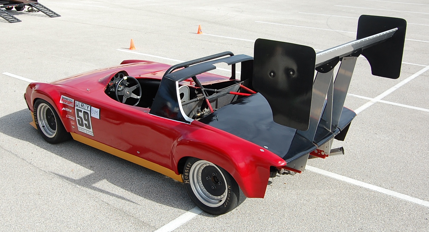

I made my own.....

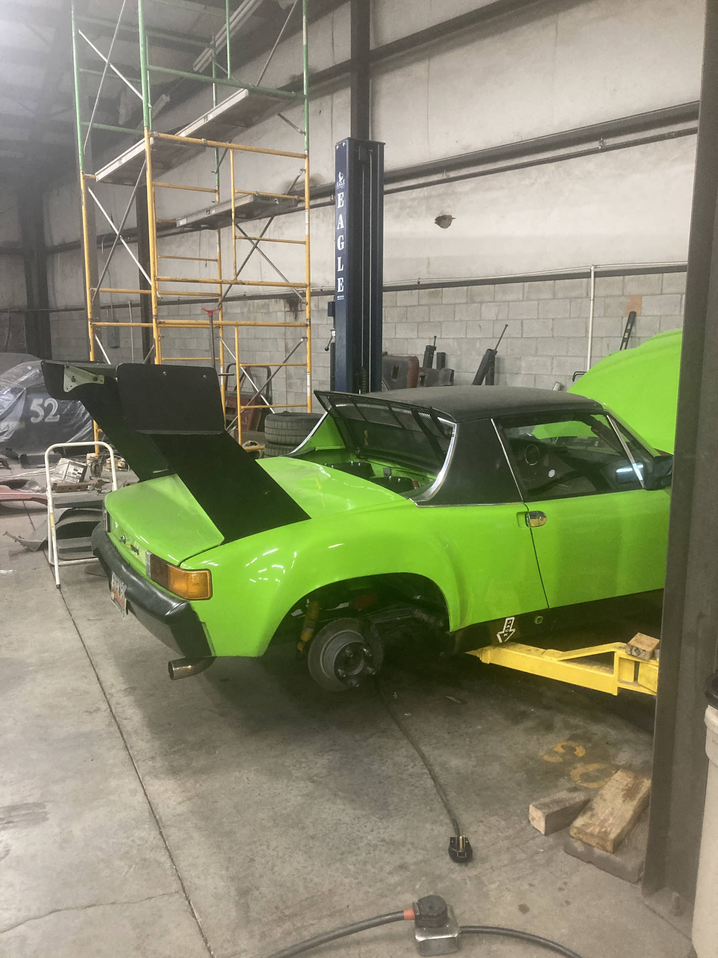

I mounted mine 2" above the targa bar.
