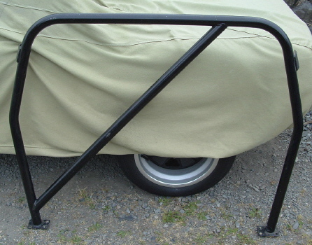

at least here in the states, they start at $269.95
Autopower roll bar
the picture is just a generic picture, obviously for a 914 it'll look different......

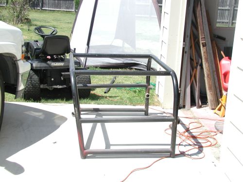

I INSTALLED A ROLLCAGE IN A 05' CAYENNE WITH 2,000 MILES LAST WEEK. I GUTTED IT! I FAR AS I KNOW I AM THE FIRST PERSON TO INSTALL IN THE U.S. ITS GOING SOMEWHERE OUT OF THE U.S. FOR A RALLY. ILL POST SOME PICS THURS. TRYING TO GET IT INTO EXC. MAG.

Autopower 140.00 Bolts to floor.

QUOTE (9144guy @ Aug 16 2005, 05:15 PM)
your CAPS LOCK key is stuck!

QUOTE (sixnotfour @ Aug 16 2005, 07:05 PM)
passenger seat rests up againts the diagonal tube?
Yes
It's not possible to 'bolt-in' any real protection to the floor. If you're serious, weld a real device to the longs.
How much would you charge to build one ?
This Autopower was used in a car to obtain SCCA license and then pulled out, 20years ago.
Use to Satisfy the Min. requiremnet , Not the best.
