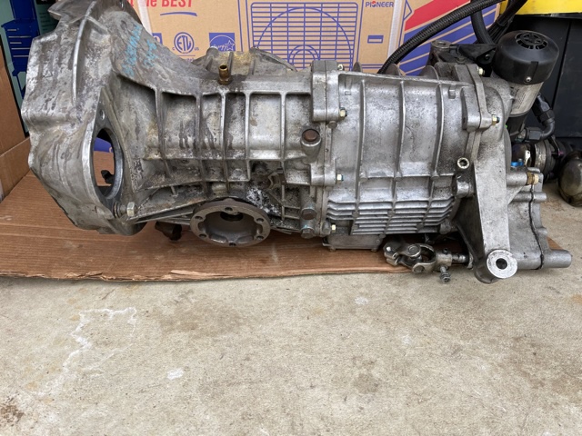

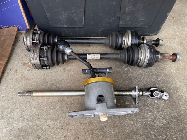

If you want a transmission that will hold up to a strong 3.6, I have a Peter Dawe built Carrera trans with the WEVO side shift adapter. It was behind a Dawe built 3.6 that’s in my friends SC. Set up for a remote oil cooler. Includes Carrera axles and shifter. $14,914.

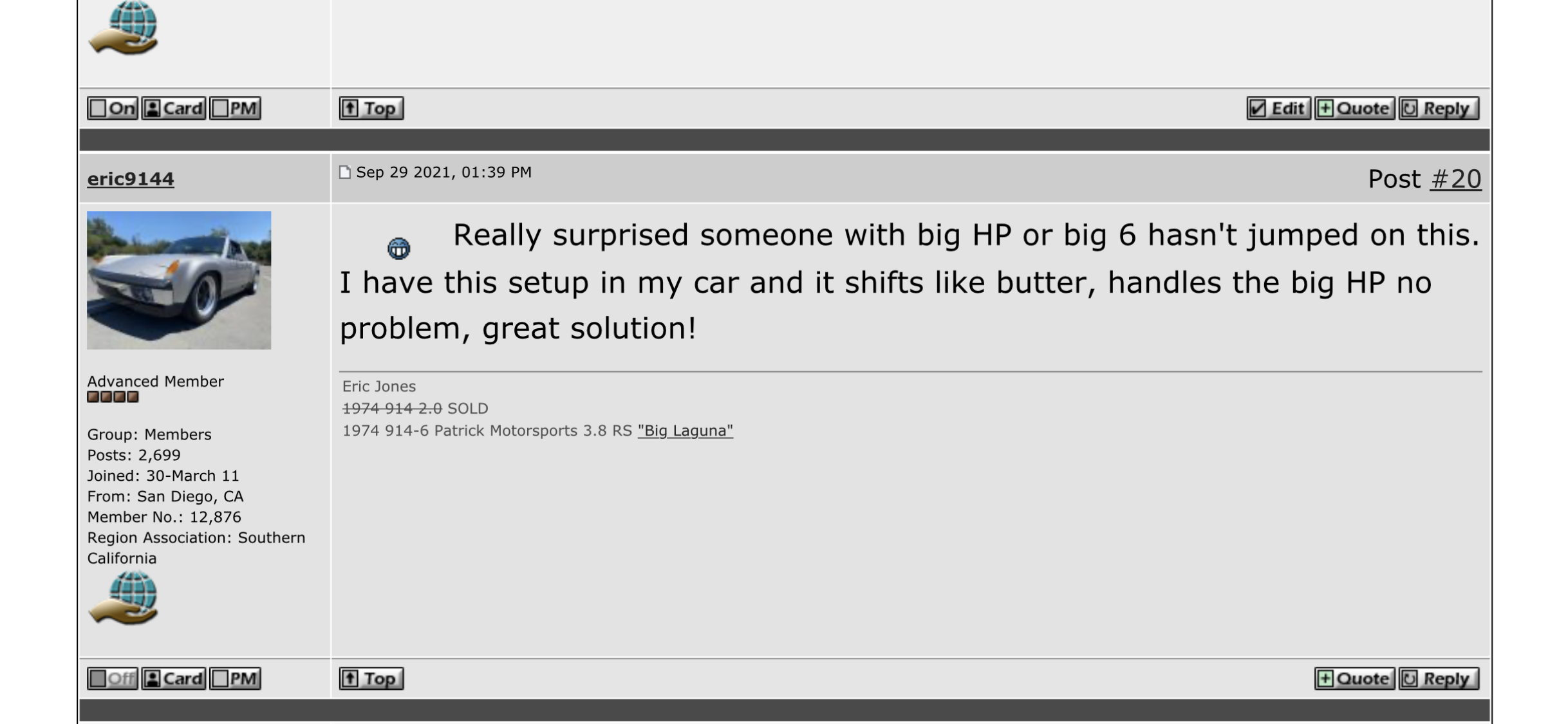

Eric has the same trans in his big kahuna PMS built 3.6 as what I’m selling and here’s what he says:
Lucky9146

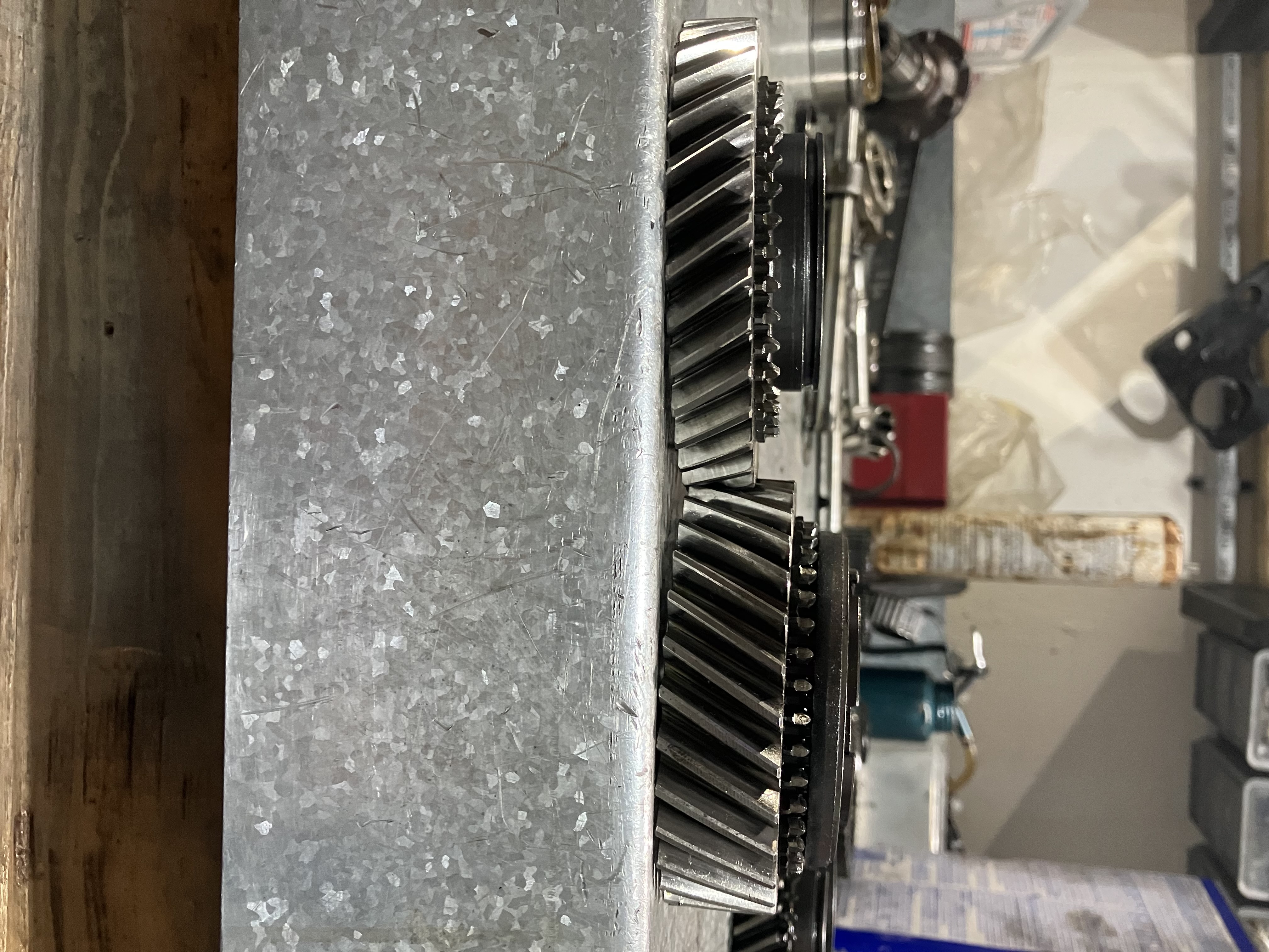

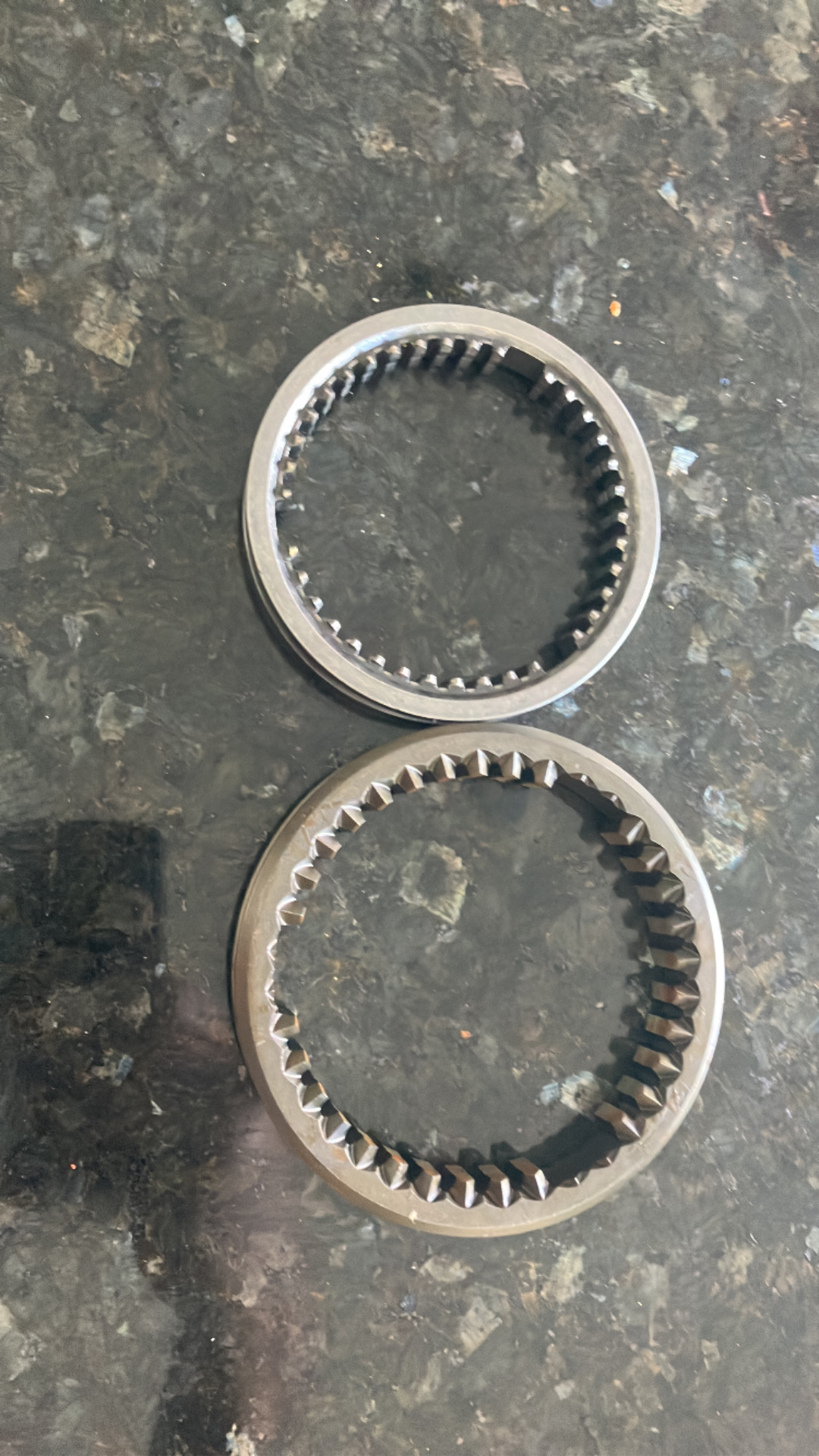

If you can source a 930 box, that would be a neat one to convert as the gears are beefy (but it’s a 4 speed). Currently rebuilding one now. 901 first next to 930 first.
930 slider next to 901 slider. The 4,5 gears in 915 are the same dimensions as the ones in a 901, same with the sliders. In a 930, everything is thicker. Attached Image
