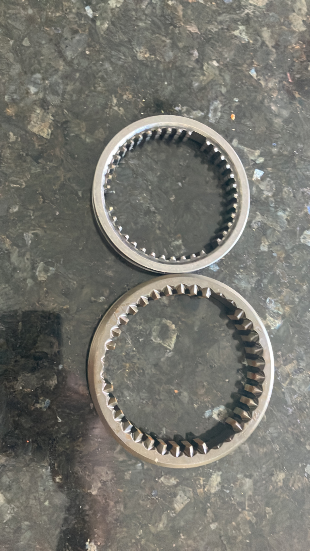

Honestly, I don't particularly like the 915 transmission. I think they shift terribly.
I wish someone made a mid engine version of the G-50 or a Boxter/Cayman transmission with a bell housing for an air cooled motor.

I have driven and built lots of 915 transmissions, and even ones that were rebuilt by Porsche. None of them really shifted well. That's why Porsche designed the G-50.
The 915 was the end of the line for the Porsche in house designed syncromesh. The G-50 used the Borg-Warner syncromesh. That's why the G-50 is so much better than the 915.

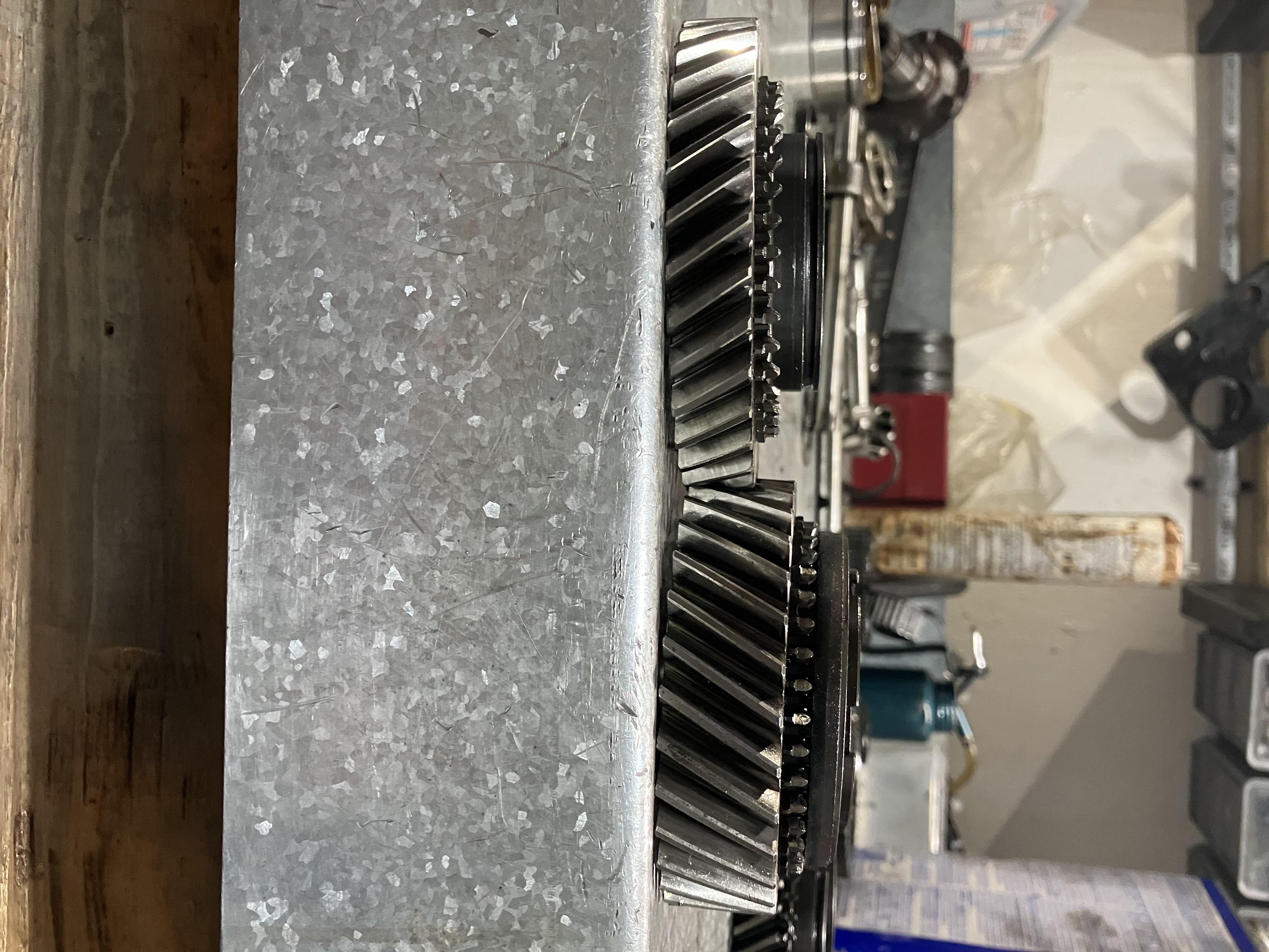

If you can source a 930 box, that would be a neat one to convert as the gears are beefy (but it’s a 4 speed). Currently rebuilding one now. 901 first next to 930 first.
930 slider next to 901 slider. The 4,5 gears in 915 are the same dimensions as the ones in a 901, same with the sliders. In a 930, everything is thicker. Click to view attachment
