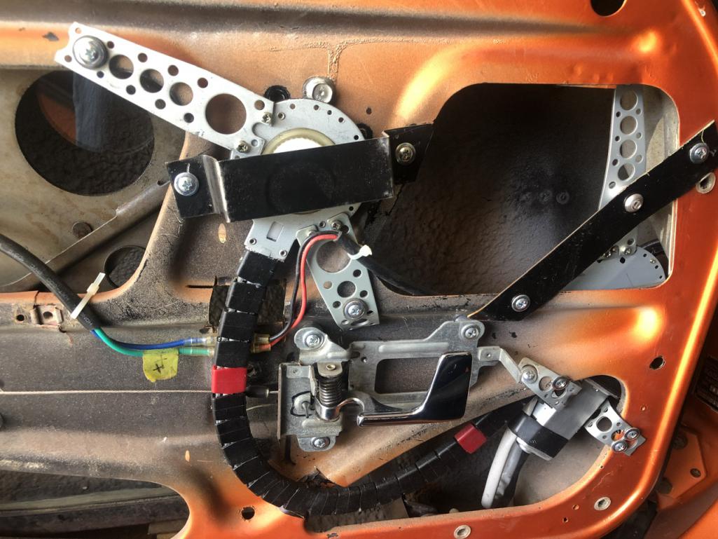

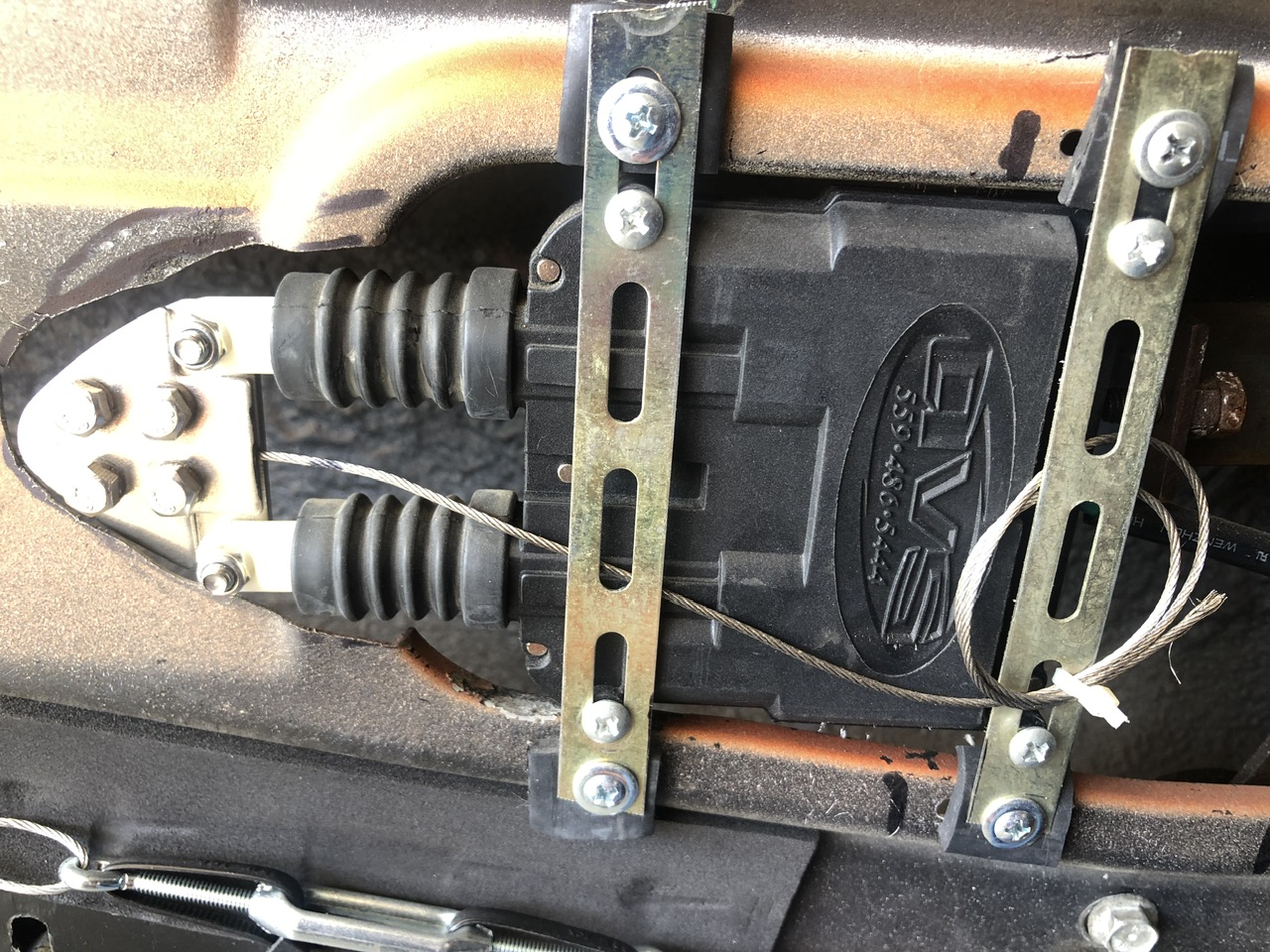

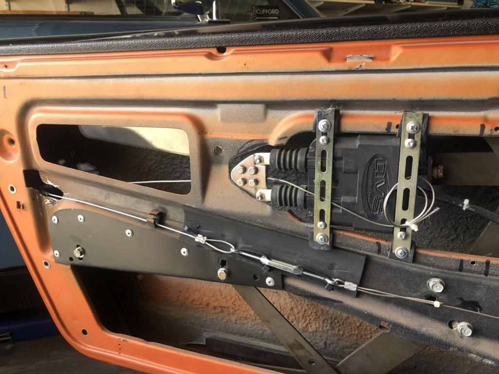

My SBC 914. No door handles, has electric windows and door locks. Works great, but slow at times. The doors unlock through the alarm system.
