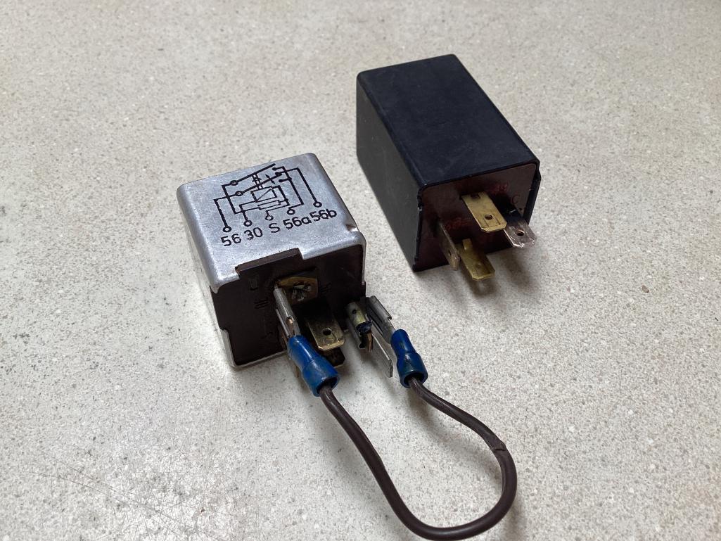

My turn signals blink like a sloth S. L. O. W. L. Y. Is it the flash cube or should I just hang my arm out the window
Front yard mechanic Turn signal Aug 20 2023, 07:02 PM
914Sixer I can dig a spare out for you to test with, pay th... Aug 21 2023, 05:52 AM
Front yard mechanic
I can dig a spare out for you to test with, pay t... Aug 21 2023, 08:31 PM
dr914@autoatlanta.com try a replacement four prong turn signal relay fir... Aug 21 2023, 08:25 AM
Spoke EP26 flasher relay is generally available and will... Aug 21 2023, 06:58 PM
914Sixer Went out this morning Aug 22 2023, 04:50 PM
Front yard mechanic Thanks Sixer for the flasher cube I replaced it an... Aug 28 2023, 10:17 AM
dr914@autoatlanta.com You have a high low beam relay on the left and a t... Aug 28 2023, 12:17 PM
Front yard mechanic Nice thx doc Aug 28 2023, 03:02 PM![]() ![]() |
