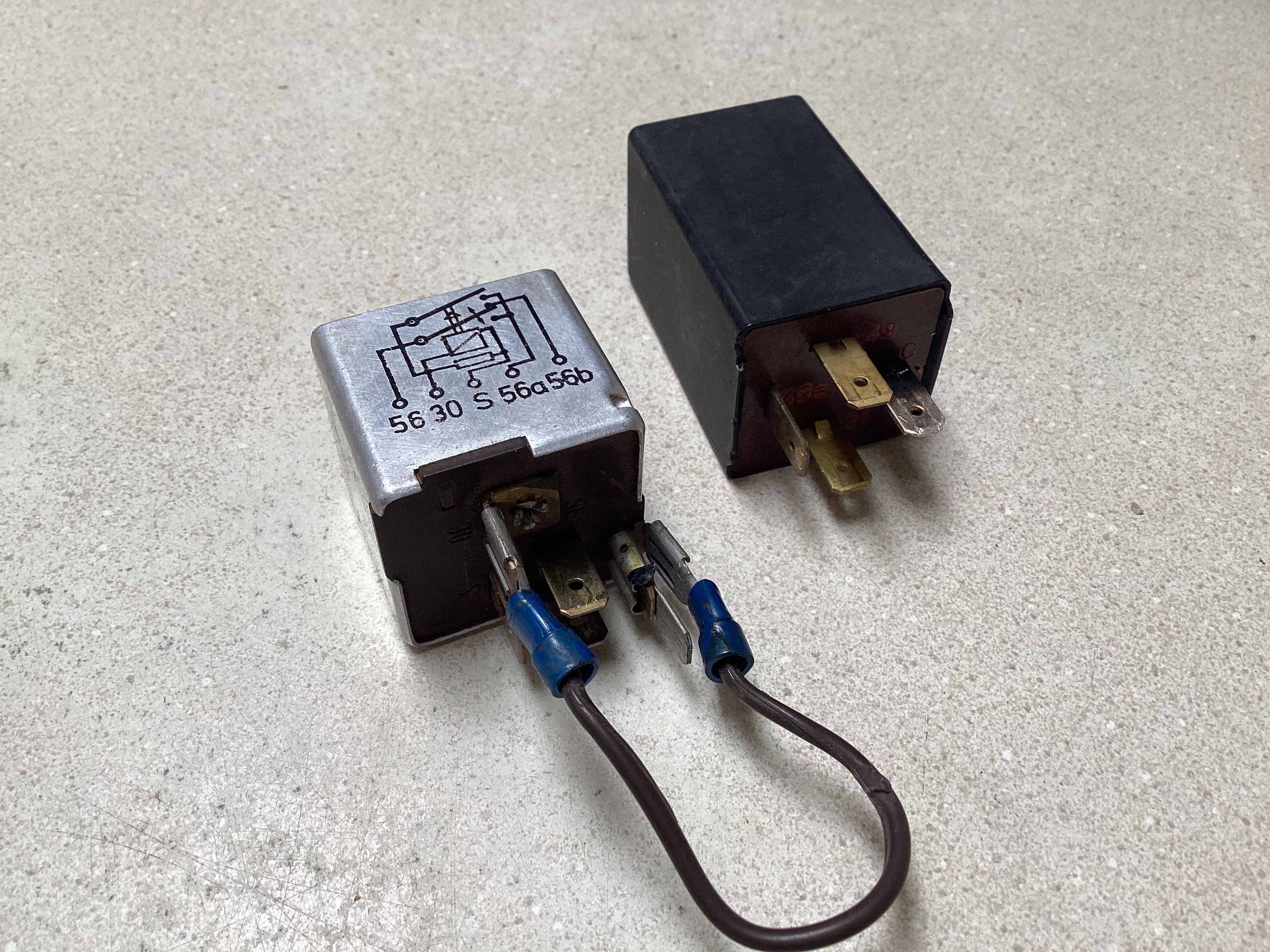

Thanks Sixer for the flasher cube I replaced it and still no go … so luckily I got one locally and the silver cube next to it that clips in and all it well now. I still don’t know which one was at fault I’m not sure how to bench test these? Also the old silver flasher had 5 prongs and a jumper lead from 30 to 56 but the replacement only has 4 prong. Some day I will need an electrical lesson but my patience is limited Click to view attachment
dr914@autoatlanta.com
You have a high low beam relay on the left and a turn signal relay on the right
QUOTE(Front yard mechanic @ Aug 28 2023, 09:17 AM) *
