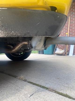

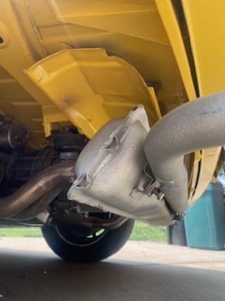

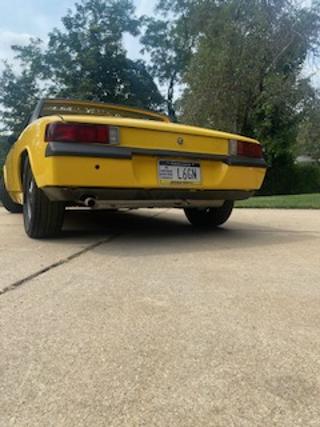

Wondering what doesn’t belong here. Fiberglass rear pan hits resonator on muffler and muffler isn’t covered by the pan. Ideas?
Kevin

Hi- Pictures would help in identifying the issue.

You mean valance
When you lay it flat on a flat surface is it bent at all? They have some flex so have tried to just push it up and secure? Otherwise your car may be a little tweaked...

Fiberglass means it’s aftermarket so that’s one reason it might not fit. Usually you have to fit fiberglass to the car. Cut, clamp, glass. Rinse and repeat. Or the car got hot and it’s out of whack.

It’s a fiberglass valance which sloppy is expected but it doesn’t hide the muffler nor fit there

A stock valance will not cover the whole stock muffler. It didn’t on mine.

Your FG replica does look a bit shallow in height but not far from a later model original steel one which does not cover the muffler and only has a half-circle cutout for the tailpipe. The early year rear valances with the hole for the tailpipe did cover the muffler but did a great job of scooping snow and dirt; probably the reason for the later design.

It looks like you have an early 1.7 muffler that had a different exhause pipe location. It used the deeper porthole valance. They stopped making the deep valanceas it made the engine run hotter. You may be able to make that one work. I have seen several valances that were so farr of that they could never fit.

Your car is a 74 1.8?
Have you looked into getting the stock muffler for your car? Then try to get a steel valance?
That may correct all of the issues at once.
I doubt you will regret getting the original stuff. Obviously, the valence can be a little difficult to find in pristine shape, but “aged” ones can be found.

I looked up the muffler on Auto Atlanta's sit and it appears to be correct and the same one I have unless there are small differences

That muffler doesn't look like it is in the right place which goes along with what Bruce said. It should be centered up with that heat shield. From what I can see it looks quiet a bit to the rear of center. (IMG:style_emoticons/default/confused24.gif)
