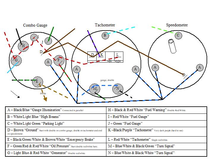

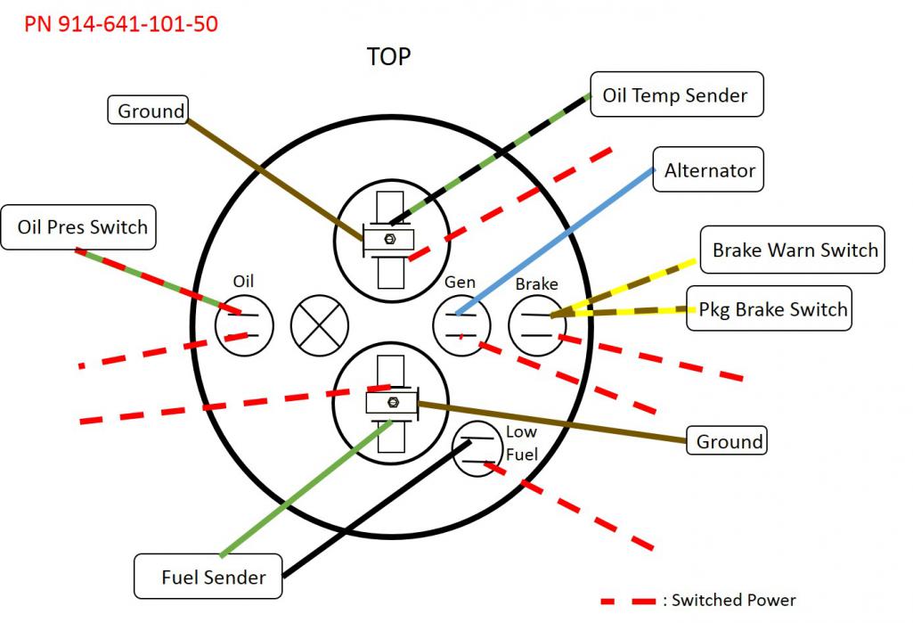

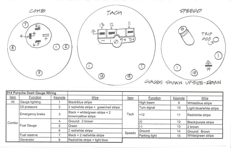

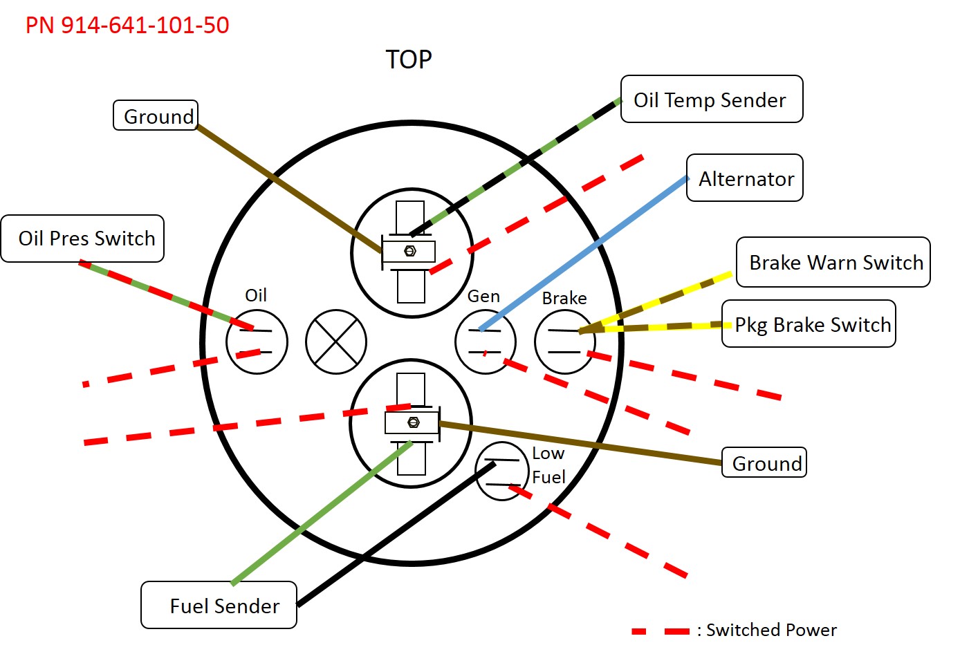

Would anyone have a photo of the back of an oil temp and fuel level gauge they could easily post showing the wiring and connections? My fuel level is not registering even with a new fuel sending unit, and my oil temp is not showing, either, even though the oil temp sending unit is good. Any other suggestions also appreciated. TIA!

Hope this helps - doesn't show the oil temp but with the rest shown here, maybe process of elimination will help...

Here's a couple more, good luck:
