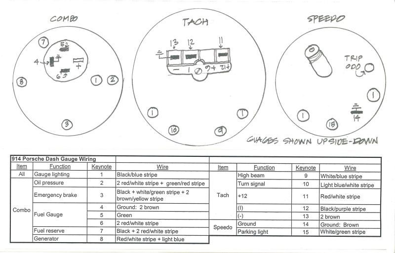

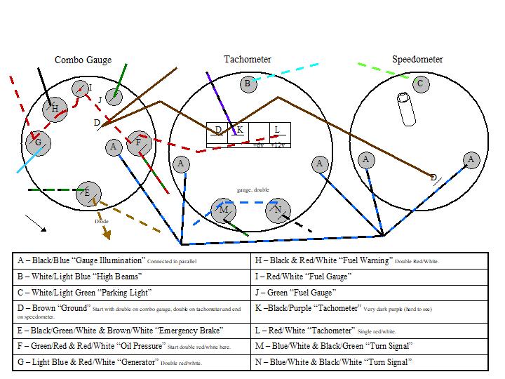

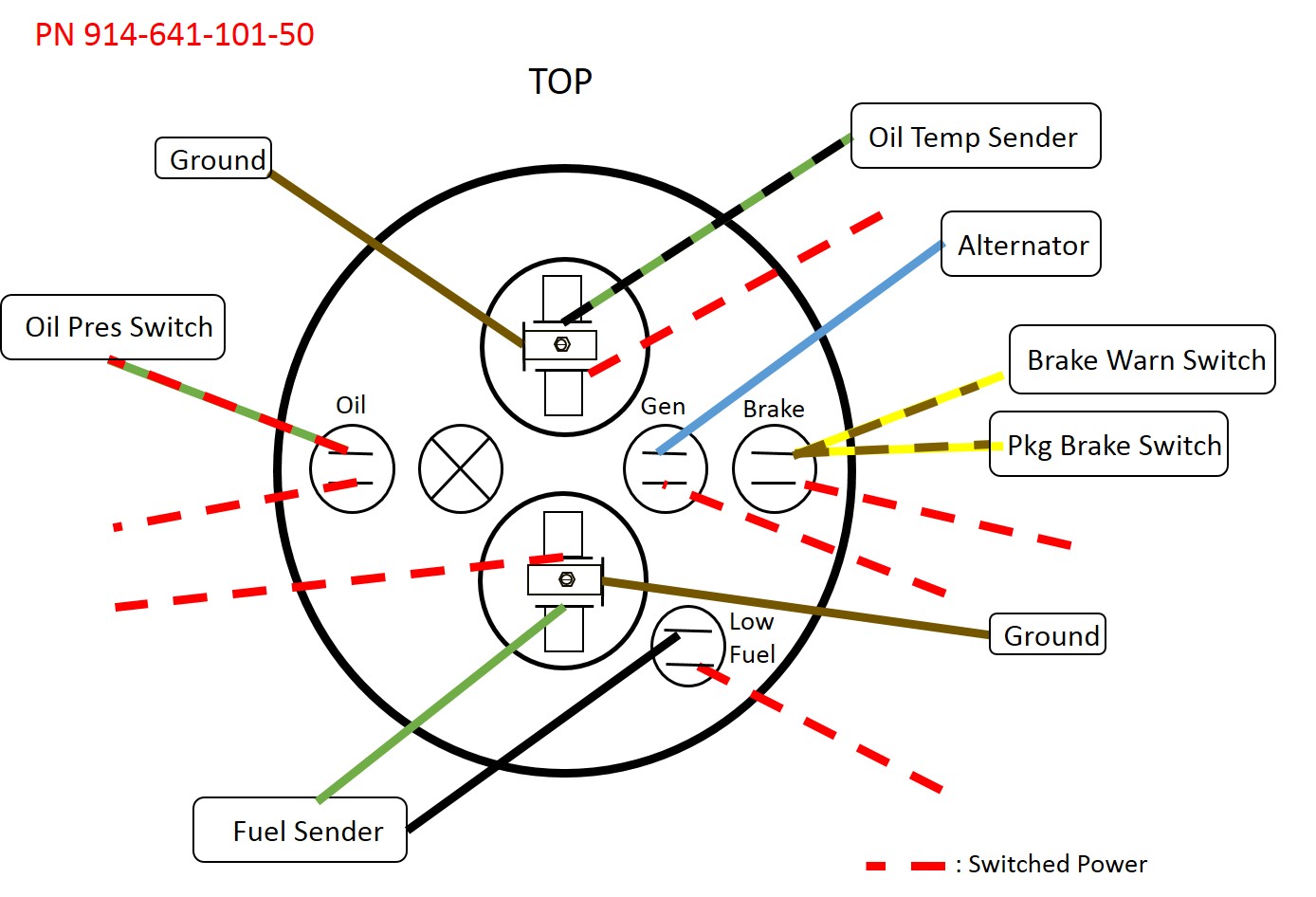

Would anyone have a photo of the back of an oil temp and fuel level gauge they could easily post showing the wiring and connections? My fuel level is not registering even with a new fuel sending unit, and my oil temp is not showing, either, even though the oil temp sending unit is good. Any other suggestions also appreciated. TIA!
FlacaProductions
Hope this helps - doesn't show the oil temp but with the rest shown here, maybe process of elimination will help...
barefoot
Here's a couple more, good luck:
