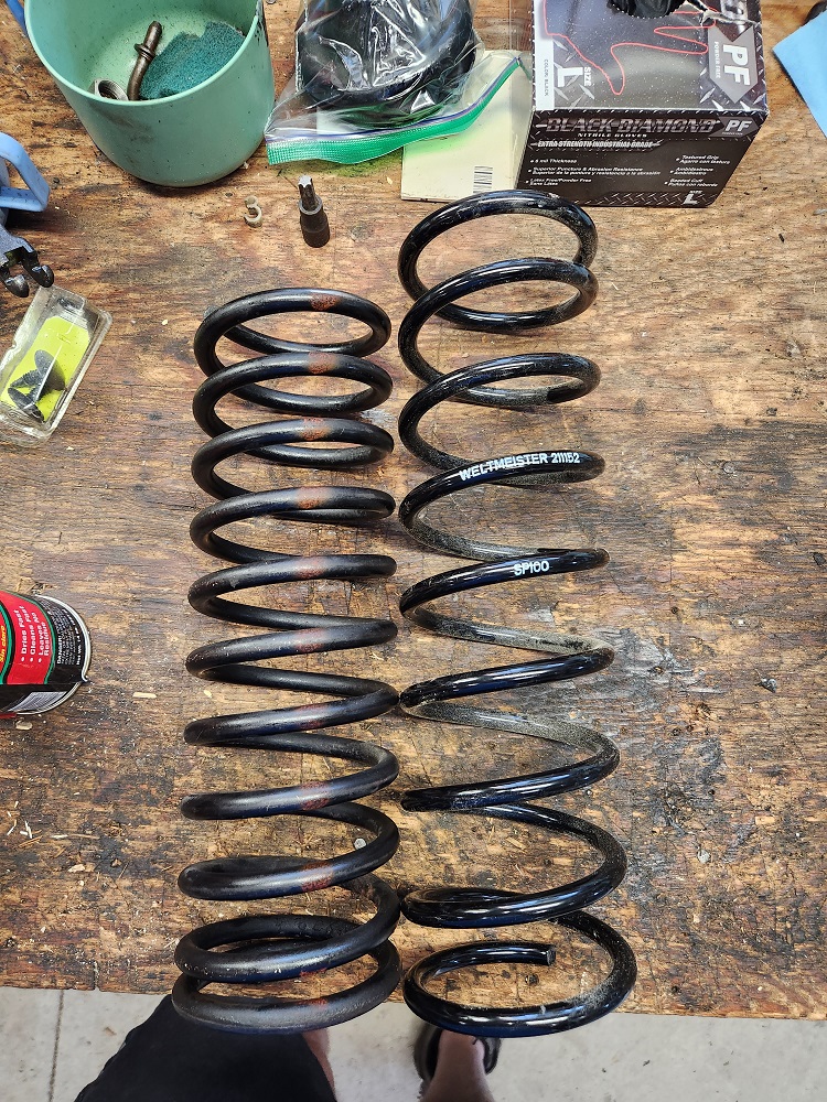

I am refreshing the rear suspension on my BB. Yet another project I hadn't really planned on but here we are.

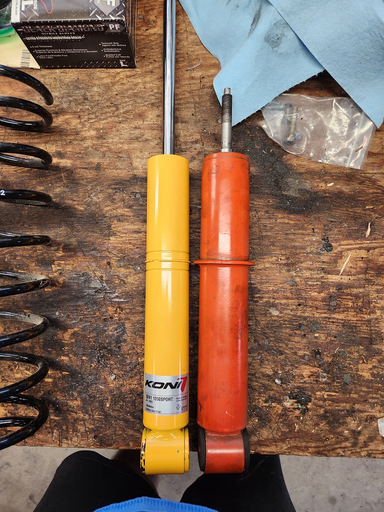

I now have everything I need to reinstall the rear trailing arms and shocks. The arms got painted new bushings and bearings (thanks @iankarr and 914rubber). New Koni sports from Paragon (thanks Jason), PMB rebuilt brake calipers (thanks Eric).
I found some new/old Weltmeister SP100's in a box of parts a PO had bought for another project car I have. See the photos. The only mark on the springs that came off the BB are a redish paint on each coil. The car did sit lower than stock by my eye. See photo. I don't know much about the SP100 but they do look pretty :-)
Would you go all the way and install the "new" springs. I realize 100lbs are stiffer than stock. I could always go back if I don't like the ride. The koni's aren't full coil overs but have a bit of ride height adjustment. The middle clip position matches the old Koni shocks I removed. The springs do sit 2 to 3 mm taller with no compression.

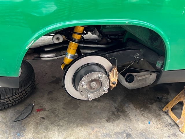

When I redid the rear suspension on my BB, I used the very same Weltmeister 100# springs but went to Bilstein shocks because they would have been available as an option.
My '74 3.2L conversion does have the yellow adjustable Koni's however but a much higher spring rate other changes won't allow me to make a valid comparison.
The 100# rear springs on my BB did not really affect the "feel" ride but I do feel they were a benefit. That car is set front and rear at stock ride height. I wouldn't hesitate to use them.
