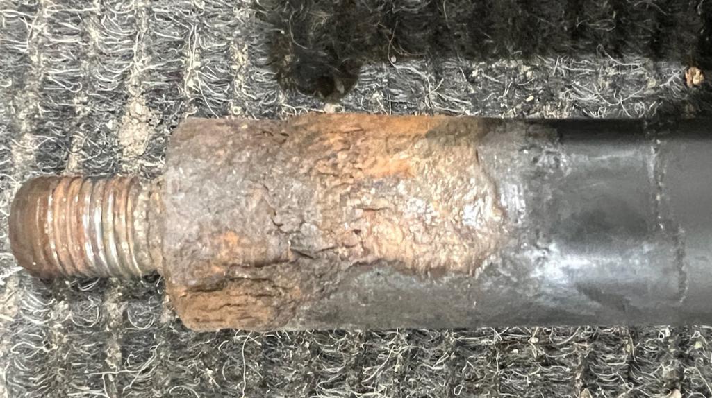

I'm currently restoring the rear suspension on my 75 1.8l and wanted to get other's suggestions regarding rear bushings.
My shafts are fine and I'm planning on re-using them.
I already have a set of bushings.

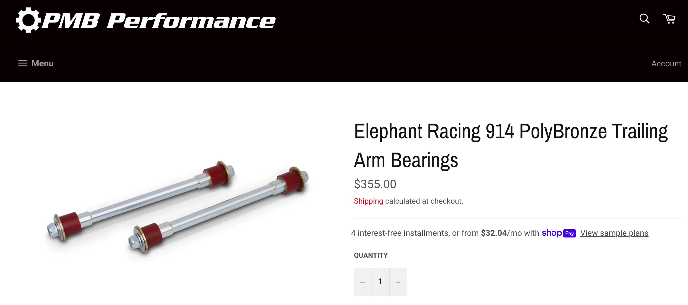

914Rubber has a rubber set that are reasonable. $ 44
PMB and Elephant racing have rubber sets that are far more costly. $92, $240
This car will be a mildly upgraded streetcar for enjoyment not competition.
I'm leaning toward the 914Rubber set...
