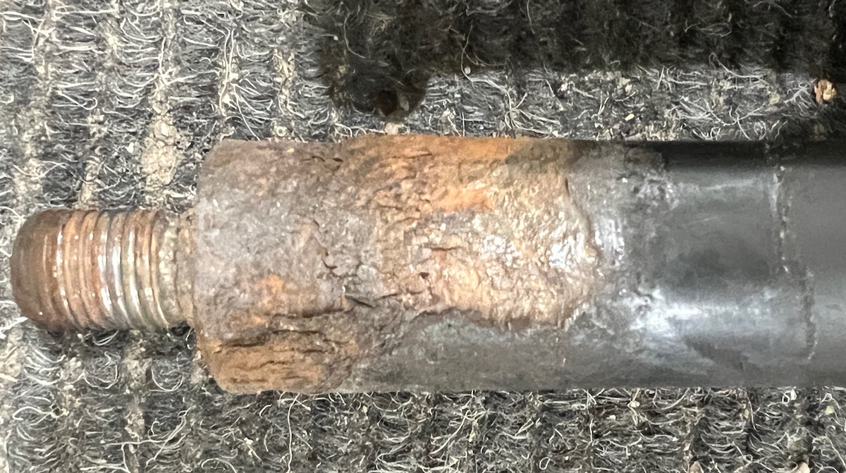

I'm just a little ahead of you. Have you already removed the old pivot shafts? Ours looked good until I got them out of the bushing. If searching for shafts, everyone I spoke to was carrying sold shafts except Restoration Design. While I'm sure the solid shafts are just fine, it seemed like unnecessary weight to me.
Click to view attachmentIf shooting for originality or street ride, you might want to go rubber for the bushing. The other compounds are reported to give a pretty harsh ride according to the vendors I spoke with.

Everything is apart and has been bead-blasted and painted.
My shafts are FLAWLESS compared to yours.
