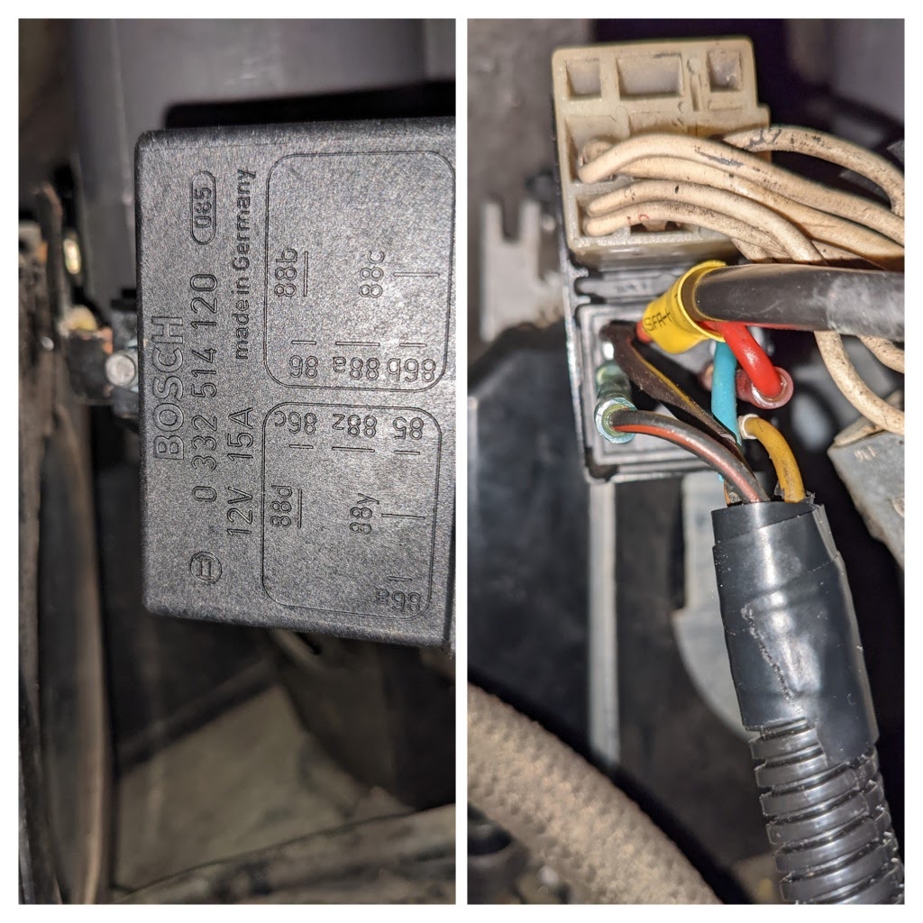

Anyway - I'm just finishing up installing this nice 76 912e engine running pretty much the same ljet in the 914 and I hit a snag that makes it so I can't even get to hear it's first fire up. My car had its dual relay stripped. Yes, if it was still there I could fire it up, BUT it made me think, what if someone running ljet has one go out? So while I began my search for what I thought was a simple yet specific part I found tons of OOS. Wait, why?! It's a dual relay right? 2 relays glued together housed in the same unit (yes I realize more to it then that). So if these parts are unobtainable, then yeah it would make me want to remove it and go with something where parts are fruitful. So while most of the time the black arts of djet and ljet confuse some to swap to carbs, the unavailability of specific parts can also make that a thing.

wonkipop   according to my quick search you can still get it?...   Aug 28 2023, 03:59 AM
Van B   Yeah, and this is a cheap replacement too!   Aug 28 2023, 05:23 AM

Porschef   PartsGeek has them, 85 clams :beer2:   Aug 28 2023, 05:52 AM
nditiz1   Thanks porschef! Looks to be the last one. I ...   Aug 28 2023, 06:32 AM

Porschef   Pretty sure the bugs and vans used the same ones. ...   Aug 28 2023, 06:55 AM
wonkipop   Pretty sure the bugs and vans used the same ones....   Aug 28 2023, 07:10 AM

dr914@autoatlanta.com   we have the dual relays on the shelf. Glad that y...   Aug 28 2023, 12:16 PM
wonkipop   @nditiz1 had some spare time to google this a bi...   Aug 28 2023, 07:09 PM

wonkipop   here is what R Atwell says. https://ratwell.com/t...   Aug 29 2023, 07:07 AM
GregAmy   here is what R Atwell says...not good news I...   Aug 29 2023, 07:50 AM
wonkipop   here is what R Atwell says...not good news I...   Aug 29 2023, 04:18 PM
Porschef   here is what R Atwell says. https://ratwell.com/...   Aug 29 2023, 08:01 AM

nditiz1   Email from PartsGeek :lol4: Good thing I had ba...   Aug 29 2023, 11:48 AM
technicalninja   Email from PartsGeek :lol4: Good thing I had b...   Aug 29 2023, 12:02 PM
Van B   There will be another run at some point, I’m sur...   Aug 29 2023, 06:14 PM
