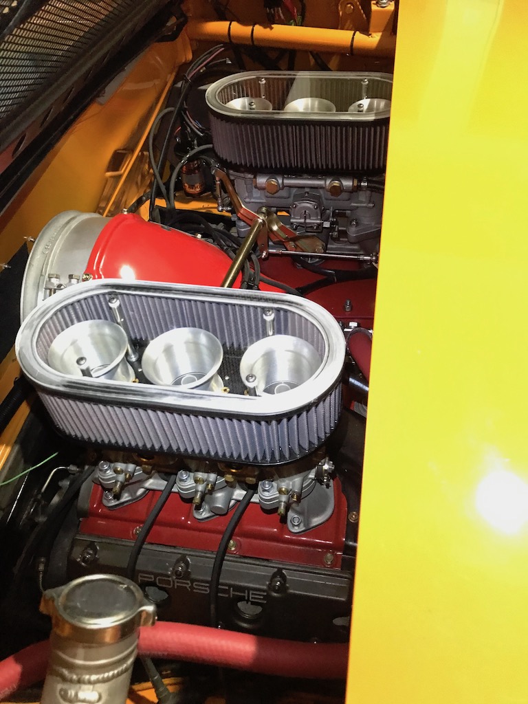

mlindner
I had Weber's on my four, now PMO's on my six GT Tribute. I really don't mind the cold start issues, remind me to keep the revs low until oil is warm.Click to view attachment

Justinp71
QUOTE(mlindner @ Aug 28 2023, 04:33 AM) *
Looks good! I have a similar setup, carbs haven't let me down in the 15 years I've been running them. Went from a 2.7 CIS to a carb'd 3.0 and never looked back. Felt like I gained 75hp.

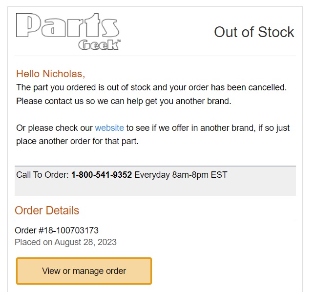

nditiz1
I thought about creating it from $8 in parts. I'm not an electrical engineer. Then I thought about the work involved and decided what's $100 or less (thanks Andy!)
nditiz1
Good thing I had backups
