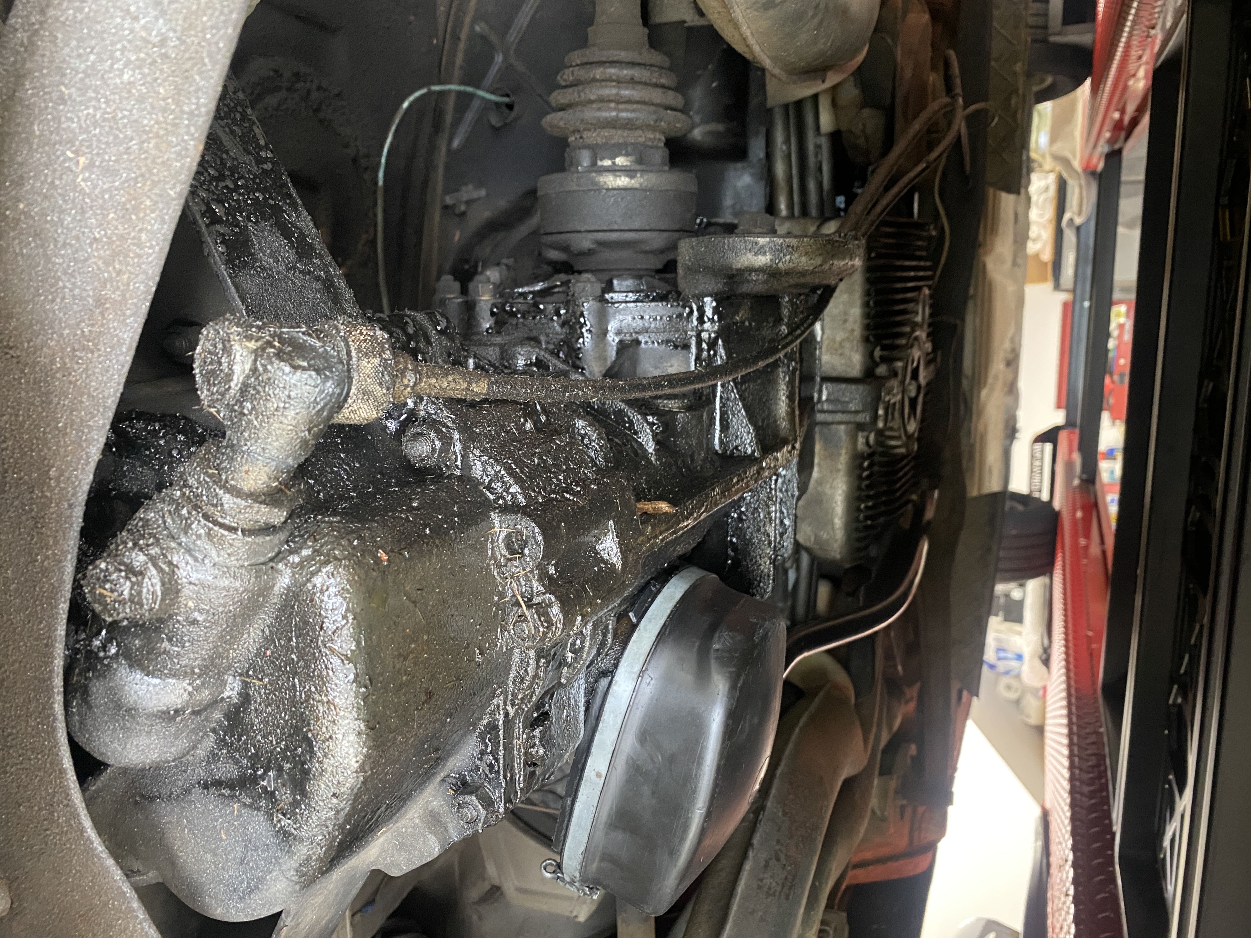

> What's causing this mess?, 1973 2.0 with 90,000 miles.

I think I know the answer - but seems a bit excessive.
The shifter cover was just removed and cleaned. Doesn't seem like the shift seal is the problem.

Is it transaxle or engine oil?
Is it only the right side? Looks like axle shaft seal.
If both, and transaxle oil, input shaft seal. If engine oil...crankshaft seal.

You can smell gear oil vs engine oil. See if you can give it the sniff test.
Flying oil while driving can be tough to track down. The engine looks pretty much dry, rear main seal or farther back.

could be a main seal in the engine... could be the front (main) seal in the transmission
both require dropping at least the trans to replace.
you'll know if your clutch disc is wet when you get it apart
but I've had oil fly everywhere on the road
so best to clean it well... short drives and see where it is coming from as it starts to drip... before it covers everything

Looks like the gasket in the cv might be gone. Could be cv grease.

RMS. No way a cv contains that much lube. What ever it is, it’s been leaking a long time. The mess is pretty far forward on the trans.

Take it to a coin op car wash and then immiedately begin to look for the fresh oil source.

How long has this been acting up? just since your recent repair?

It looks pretty old...

(IMG:style_emoticons/default/agree.gif) bottom of engine looks reasonably clean expect the RMS has been leaking for some time ,lower it closer to the ground and put a sheet of cardboard under the bell housing area and run it up till warm, I would say it will drip out the opening fairly soon.
Think you will find other leaks also but reckon this is the primary cause .

Mine looked similar. Dropped the motor and transaxle and put all new seals in. So far, after 1.5 years, no leaks..

Giving it the taste test will tell you a lot. (IMG:style_emoticons/default/biggrin.gif) They smell completely different, engine oil out of a good running engine will have a mild smell, if any. Trans fluid has a strong gamey smell...Rotten dinosaur maybe. You’ll still have to drop at least the trans, but at least you’ll know what to buy.
I’d drop the whole thing and do some house cleaning while I was in there.

Trans axle shaft seals (o-ring) and cv joint gasket and probably a new boot too.
Look at the housing at the trans….it’s soaked

Speedometer drive is at least part of it.

if thats a rear main seal your clutch would be slipping i tend to think.
the photo is a bit far back to really tell where the exxon valdez disaster is originating from but she sure is an environmental law suit. (IMG:style_emoticons/default/biggrin.gif)
