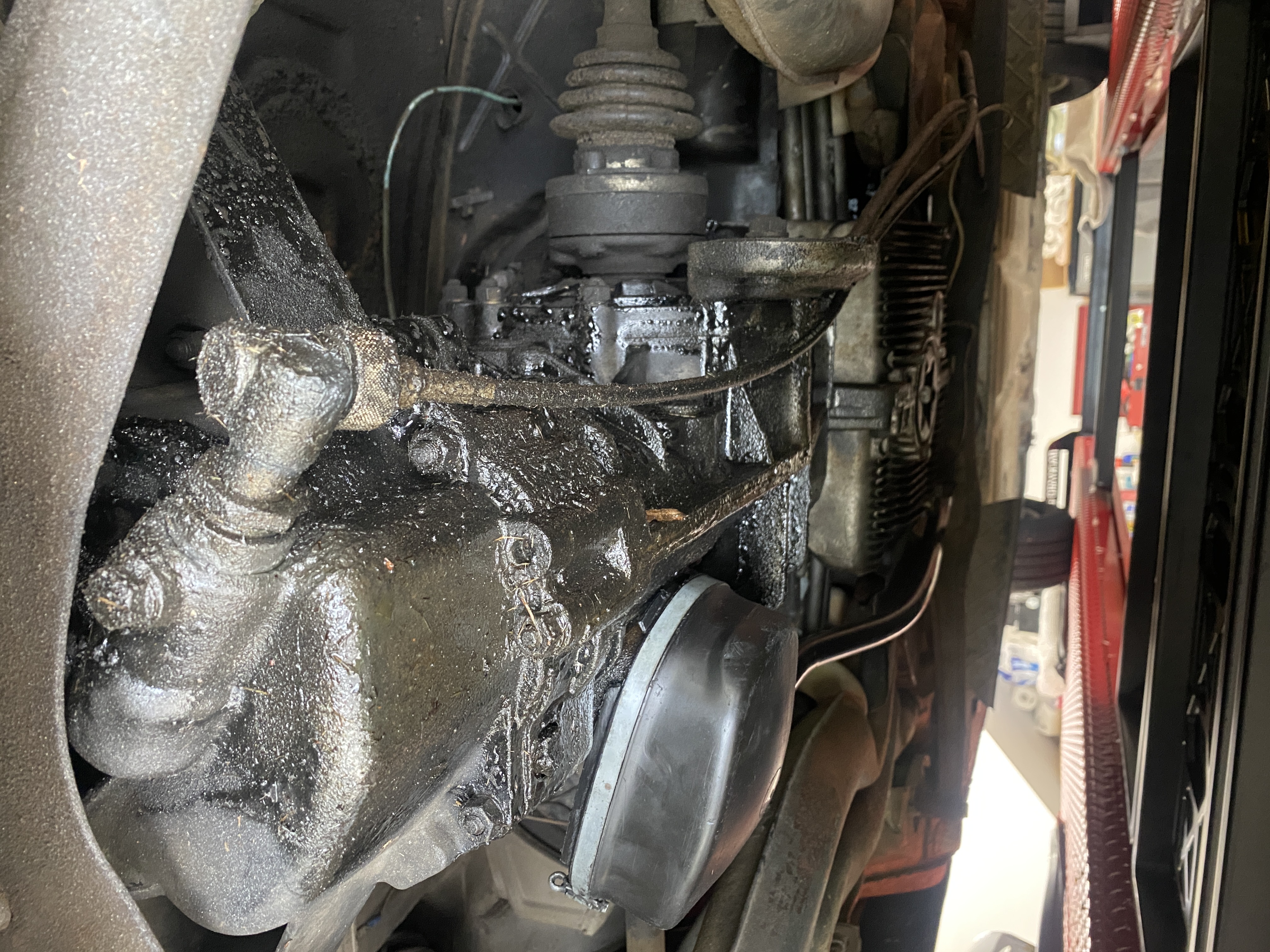

DdHavtech
I think I know the answer - but seems a bit excessive.
The shifter cover was just removed and cleaned. Doesn't seem like the shift seal is the problem.

Is it transaxle or engine oil?
Is it only the right side? Looks like axle shaft seal.
If both, and transaxle oil, input shaft seal. If engine oil...crankshaft seal.
Root_Werks
You can smell gear oil vs engine oil. See if you can give it the sniff test.
Flying oil while driving can be tough to track down. The engine looks pretty much dry, rear main seal or farther back.
brant
could be a main seal in the engine... could be the front (main) seal in the transmission
both require dropping at least the trans to replace.
you'll know if your clutch disc is wet when you get it apart
but I've had oil fly everywhere on the road
so best to clean it well... short drives and see where it is coming from as it starts to drip... before it covers everything
emerygt350
Looks like the gasket in the cv might be gone. Could be cv grease.
rhodyguy
RMS. No way a cv contains that much lube. What ever it is, it’s been leaking a long time. The mess is pretty far forward on the trans.

Take it to a coin op car wash and then immiedately begin to look for the fresh oil source.

How long has this been acting up? just since your recent repair?
emerygt350
It looks pretty old...

QUOTE(rhodyguy @ Aug 30 2023, 04:09 AM) *
agree.gif bottom of engine looks reasonably clean expect the RMS has been leaking for some time ,lower it closer to the ground and put a sheet of cardboard under the bell housing area and run it up till warm, I would say it will drip out the opening fairly soon.
Think you will find other leaks also but reckon this is the primary cause .
Good luck sorting it,cheers.

Aerostatwv
Mine looked similar. Dropped the motor and transaxle and put all new seals in. So far, after 1.5 years, no leaks..

Giving it the taste test will tell you a lot. biggrin.gif They smell completely different, engine oil out of a good running engine will have a mild smell, if any. Trans fluid has a strong gamey smell...Rotten dinosaur maybe. You’ll still have to drop at least the trans, but at least you’ll know what to buy.
I’d drop the whole thing and do some house cleaning while I was in there.
r_towle
Trans axle shaft seals (o-ring) and cv joint gasket and probably a new boot too.
Look at the housing at the trans….it’s soaked

Speedometer drive is at least part of it.

if thats a rear main seal your clutch would be slipping i tend to think.
the photo is a bit far back to really tell where the exxon valdez disaster is originating from but she sure is an environmental law suit. biggrin.gif

76-914
That Cv gasket is gone. Usually they will leave a grease line about the undercarriage 90 degrees out from the gasket, which I don't see. I'd inspect it anyway. beerchug.gif

All suggestions above are good - especially the smell test. Need to know if it’s gear oil or engine oil.
There is a lot of oil residue up high on the tail end of the trans. That usually isn’t from engine oil.
I’ve seen this occur when the transmission vent is blocked. Internal pressure inside the trans pushes gear oil out everywhere - input shaft seals, differential carrier seals, speedo gear, gear shift seal, etc., anywhere it can relieve pressure.
Can also occur when the trans is overfilled. Sort of hard to overfill if done properly but I’ve seen them overfilled when filled on the bench or garage floor.

My 70 looked like that and really spewed fluid out once warm. Dropped engine. Both the output shaft seal on the trans and RMS were leaking. Did those and new clutch. Much better now. I won't claim it doesn't leak at all :-)

OP, do you have to add engine oil on a regular basis? If you should have to deal with transmission lube, loosen the fill (upper one) plug first.
