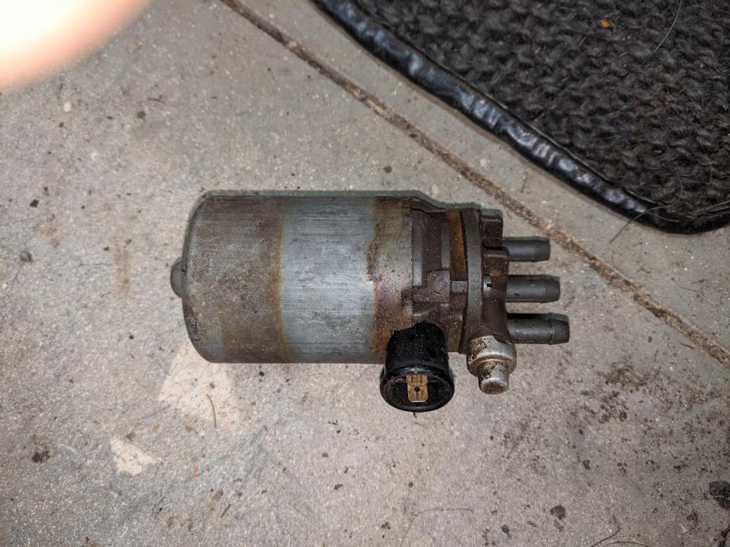

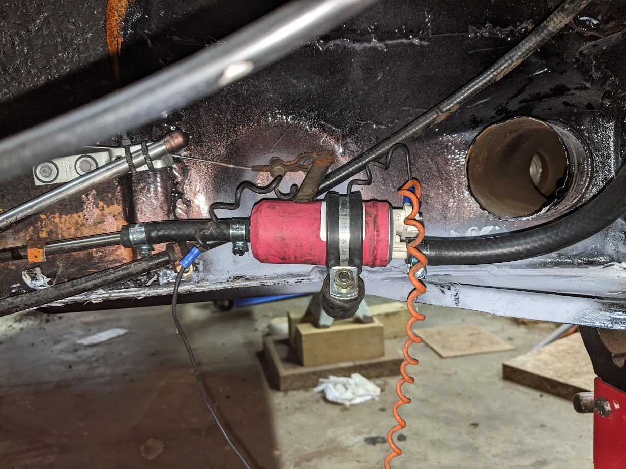

I have a 1.7L. The pump I have looks like this.

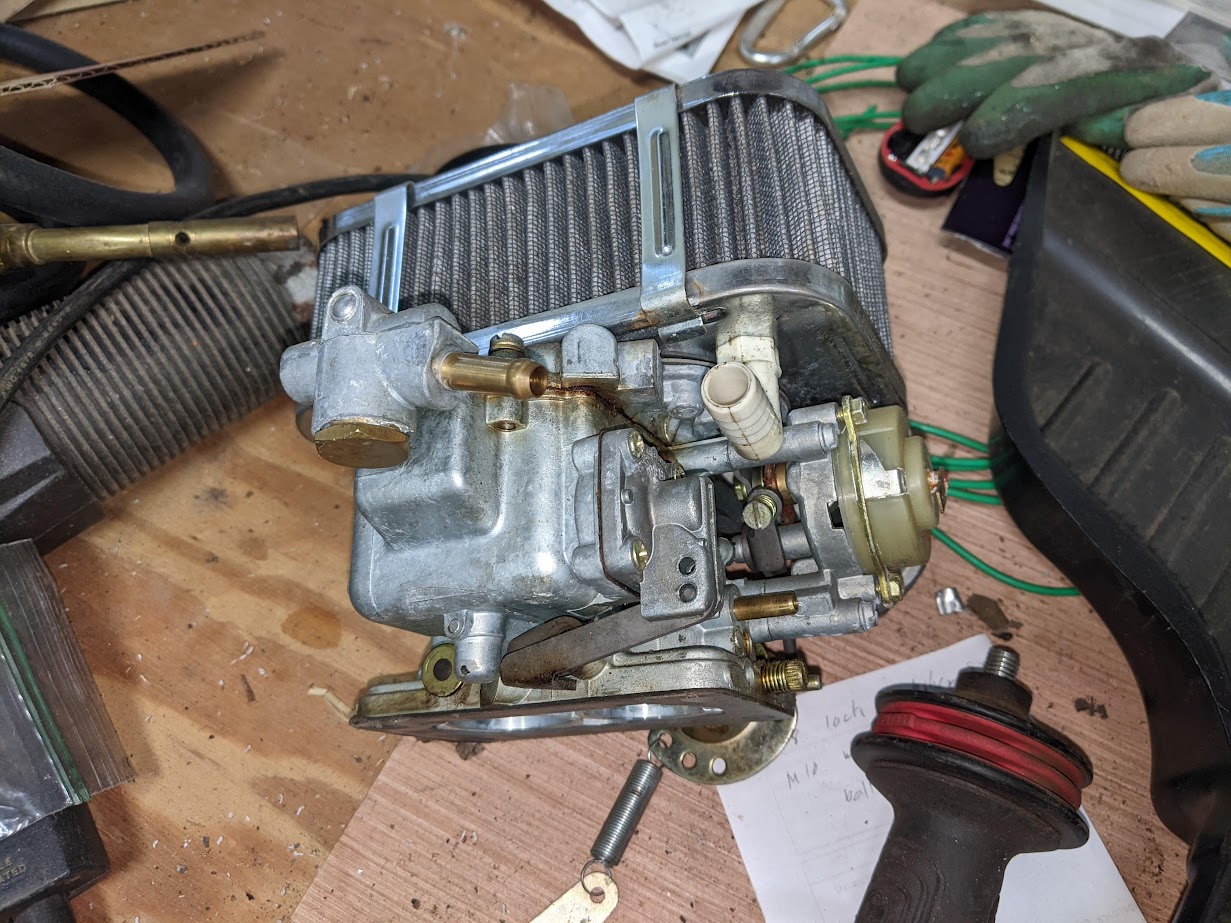

Where I see it says it is 5psi and recommends a pressure regulator. But I don't see one. I have this single carb. How bad is that? Do I really need a regulator? What is going on without it? Related is that the PO said they recently gave up on FI. But I assume no engine work was done. I found this pump in the trunk. Recommendations? |

ndfrigi 1. The lower fuel pump you saw was the original F... Aug 29 2023, 08:47 PM
brant your question about whether you need the regulator... Aug 30 2023, 10:56 AM
stoneman30hotmail
your question about whether you need the regulato... Aug 30 2023, 03:13 PM
porschetub
your question about whether you need the regulat... Aug 31 2023, 02:26 PM
rjames Did the PO give you the FI stuff, too? If so, cons... Aug 30 2023, 12:55 PM
stoneman30hotmail
Did the PO give you the FI stuff, too? If so, con... Aug 30 2023, 03:07 PM
VaccaRabite Its probably an internally regulated pump thats pu... Aug 30 2023, 02:07 PM![]() ![]() |
