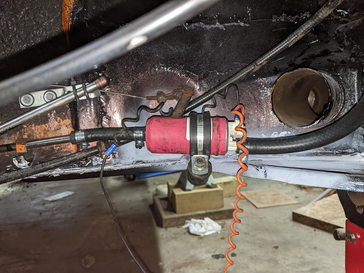

I have a 1.7L. The pump I have looks like this. Click to view attachment https://www.lceperformance.com/ProductDetai...eUaAvWtEALw_wcB
Where I see it says it is 5psi and recommends a pressure regulator. But I don't see one.

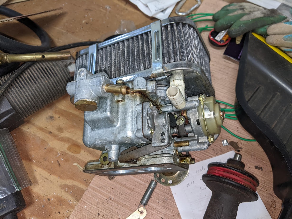

I have this single carb. Click to view attachment
How bad is that? Do I really need a regulator? What is going on without it?

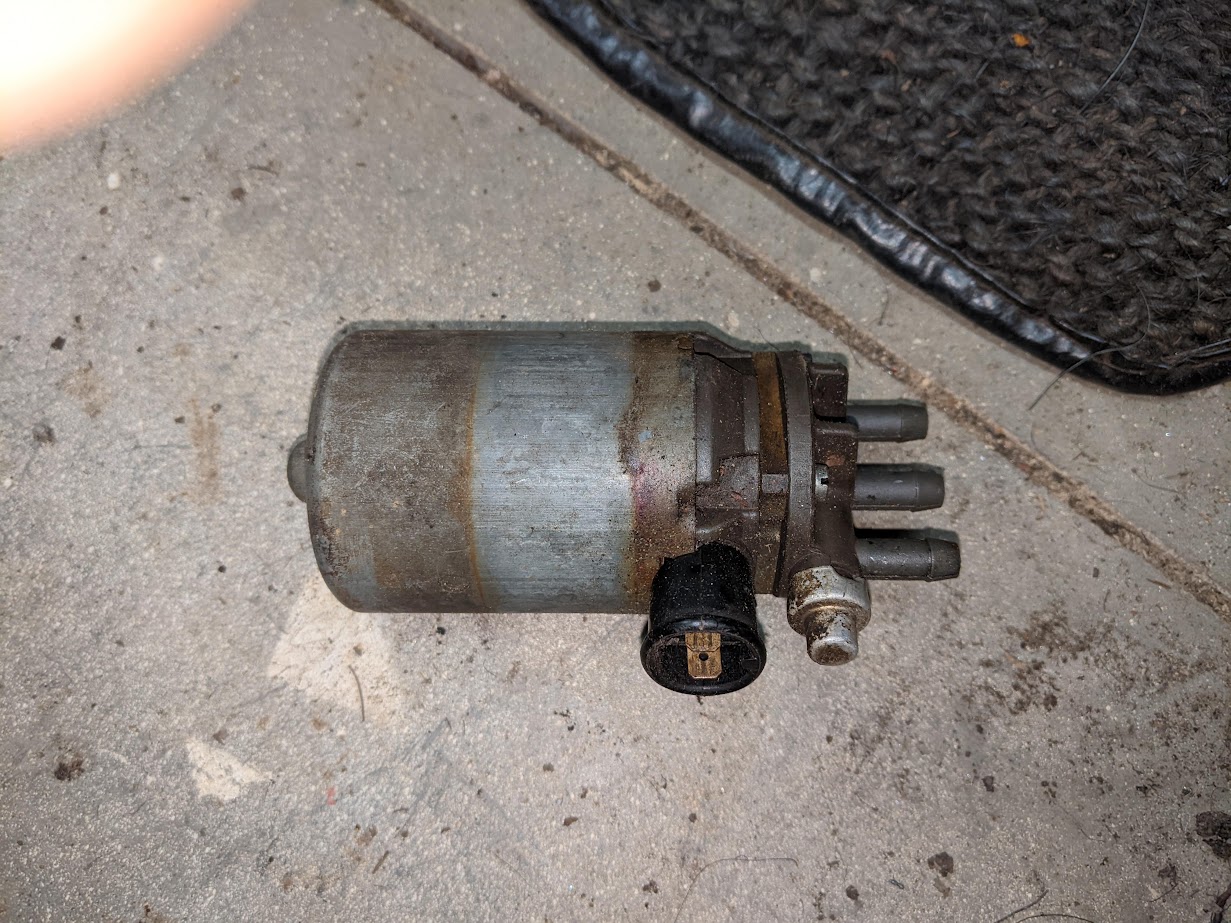

I found this pump in the trunk. Click to view attachment
Recommendations?

1. The lower fuel pump you saw was the original FI fuel pump with around 30 psi.
2. Looks like previous owner replaced the fuel pump to low psi. If it indicated 5psi. You need pressure regulator that can lower it to 2 psi.
3. Single carb usually need only between 2 to 3 psi.
brant
your question about whether you need the regulator:
the needle and seat in the carb stops the fuel from flowing in.
they can stop and handle pressure around 3psi... sometime 4psi
but much higher and they will blow the needle open and continue to add fuel to the carb even if the bowl is full already. So the bowl can overflow and start a fire if the leaking gasoline hits the headers or another source of ignition.

Its probably an internally regulated pump thats pushing 5psi fuel.
Note I said PROBABLY. You really do want to put a regulator in line. There are many around that are 1-5psi for carb use. Get one and use it.
Good to know. We did smell gas pretty stong after the 3 mile drive home a year ago. It's probably this and/or the open carbon canister lines. Not sure how much the PO drove it since the changeover.

Wonder why they sell a pump making 5psi for Webers when I've never known of a Weber needing that pressure but I could be wrong ? ,maybe the pump isn't making that pressure as the fuel would be overflowing as mentioned .
Holley low pressure regulator has been a good unit in my application but you will need a gauge to set the correct psi .
