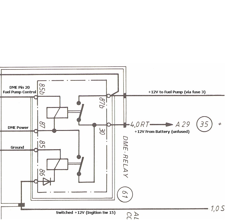

For those of you that want to get rid of the problematic DME relay, here is how to do it.
This is the diagram for the DME relay in a 3.2 Carrera.

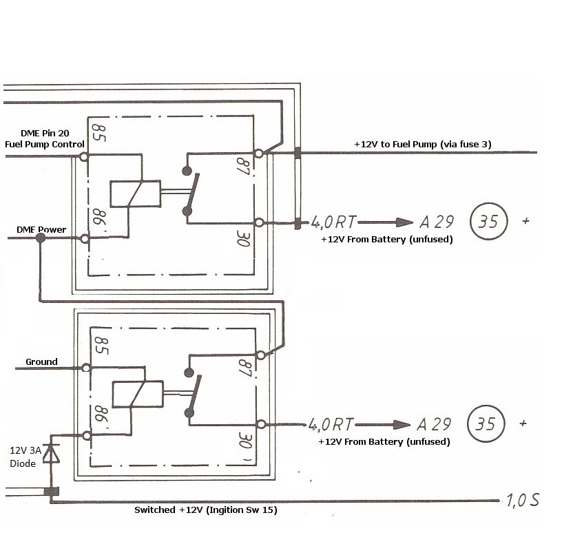

I took this diagram, and edited it to show the changes necessary to use two Bosch square relays.
You can see in a side by side view that the DME relay is just two Bosch relays linked together. The only addition is a diode, and that is just for voltage spike suppression.
Hope that helps someone in the future.
