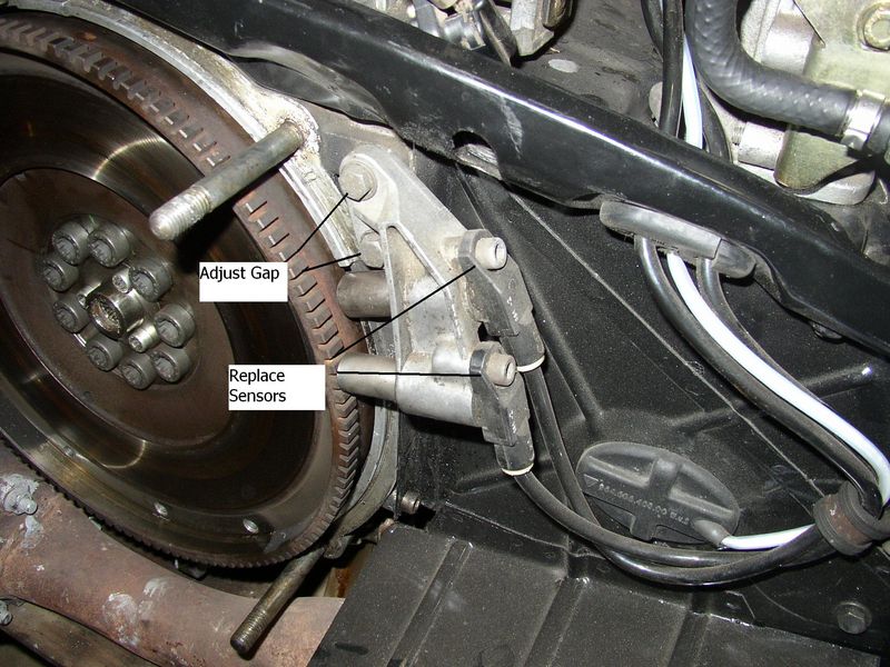

Finally got back to this. Found reference video on testing ohms and voltage. Reference sensor reads fine, speed sensor appears dead. I also get no tach bounce when cranking.

QUOTE(jim912928 @ Sep 18 2023, 05:43 PM) *
That is a common failure for the 3.2 911 engine. The sensor is not hard to replace, but you will have to do it from underneath.
(IMG:http://www.914world.com/bbs2/uploads_offsite/forums.pelicanparts.com-1143-1695079500.1.jpg)
I would also suggest that you replace both sensors. That way you don't have to go back next week to replace the other one.
You should be able to just pull the sensors out of the mount and replace them. The sensor gap should be OK after the replacement.
Otherwise you have to pull the transmission to set the sensor gap.
Good Luck!

Success! I replaced both reference sensors and it fired up immediately. Also got a new dme relay…old one still worked so I’ll use the old one as a spare. These were a pain to replace. One was frozen in (speed) so I had to remove the entire assembly and re-gap. Also tight on top to get everything unplugged, had to remove heater blower etc. in all, it took me about 8 hours from start to finish.
