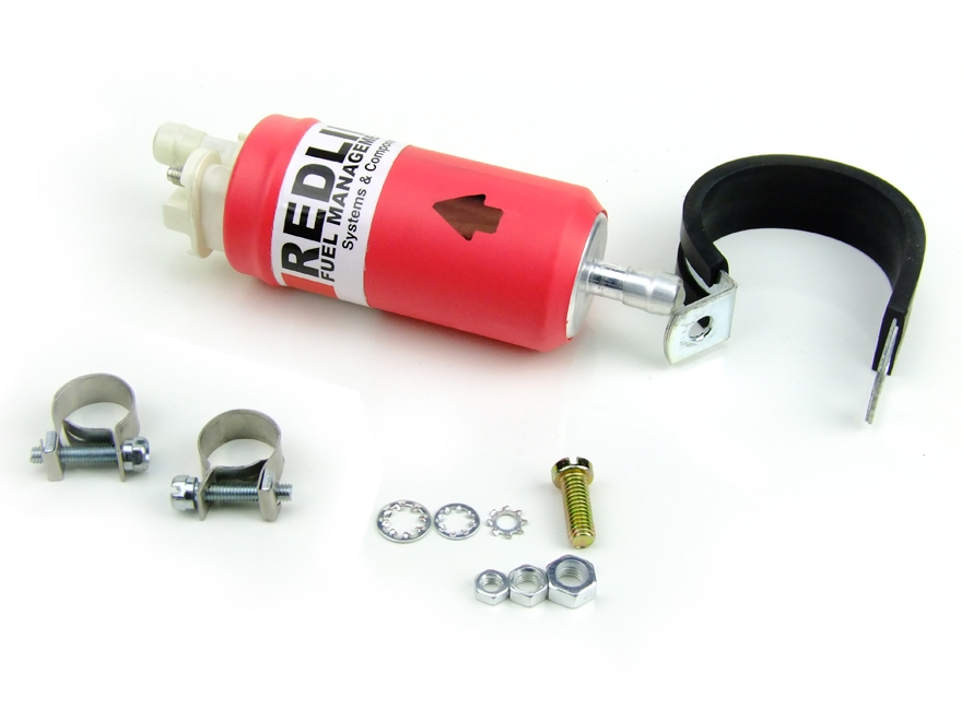

Does this pump have a prefered direction? https://www.carburetion.com/products/ProductDetails.aspx...
I can't find directions or indications on it. I'm not getting fuel, but don't know if it's this or the filter or the pressure regulator. It did get stuck when I had it before the filter but then I freed it by reversing polarity. Now I have the filter first. If I reverse polarity now I can hear bubbles in the fuel tank.

The Large Terminal is Ground, Small Terminal is Positive on this Pump.

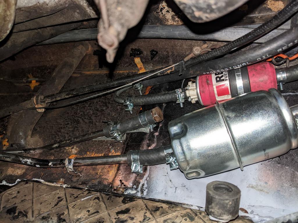

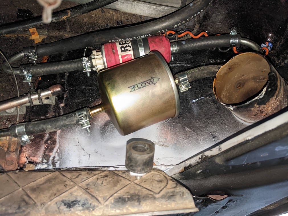

Can you show use a picture of your fuel pump installed. I have never seen a fuel pump get hot and vapor lock. I have seen carbed engines that run hot and vapor lock. Things that cause vapor lock. Poor routing of fuel lines, timing, compression too high, engine cooling tins not install, engine covered in 50 year old grim and blocking cooling fins.

Post a picture of the pump mounted. Is hot air blowing on the pump? To what degree has the fuel system been renewed?

It happened again after like a five mile drive. I felt around and nothing is really that hot.
I've been working on the car for a year. So these are the first drives. As part of the redo I've replaced the plastic tunnel lines with metal and all new hoses elsewhere - er may have reused a couple short pieces.
New fuel filters.

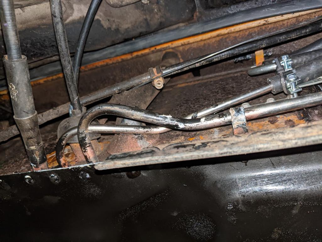

Is it a dies while driving thing or no restart after sitting while hot? What’s the story with the folded over piping piece near the firewall exit point?

I think by folded over piping piece you mean the return line. But it is connected to the tank. That's just there in case it would be converted over to higher pressure fuel pump I guess.
rhodyguy
post Oct 3 2023, 12:43 PM
Posts: 22,240
Joined: 2-March 03
From: Orion's Bell. The BELL!
Member No.: 378
But the line runs from the fold to the filter inlet? The metal line is capped and goes nowhere.

The in tank filter sock would be on the factory supply line. I don’t think the sock is currently in play. The folded return (now supply) line could be well fouled with tank debris backed up at the fold. Somewhat of a mess.

Long story short, the fuel pump supply line is connected to the folded over and now kinked return line.

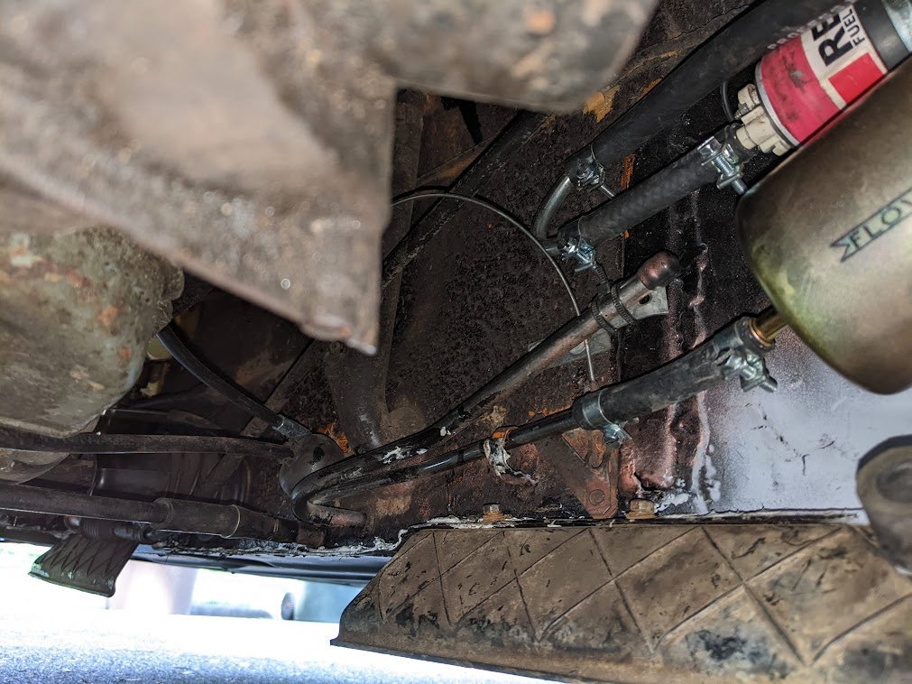

Heres a better picture of the bends. They're as they came.
Now with the right line as supply.
But it still doesn't work. A few tests run:
1. Disconnect large pipe - lots of fuel drop out. I probably let out 1/2 gallon in 15 seconds. So not the sock.
2. Disconnect line at carburator, run pump (key on) - pumps continuous (1/2 gallon fast) . So not a clog.
3. Idle engine - starts at 2 psi at gauge, stalls after 5-10 min, no pressure at fuel gauge, pump still buzzing
(after draining some fuel through system)
4. Leave pump to run, engine off, no flow - fuel pressure gauge shows 2 psi after regulator but pressure drop to 0 eventually (5-10min) pump still buzzing
