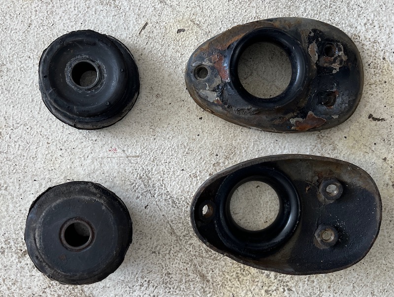

I removed the bushings from the front strut shock mounts (aka support mount, camber plate). Now I'm a bit confused on the correct bushing and the finish of the mount plate for a 1970 914-6.
What I removed
  • One piece bushing with metal tube in the center
  • Plates are clearly black
Looking for parts online, that bushing sold separately is listed as '71-89. While sold a few places, I am seeing Elephant as the only current manufacture. If you buy a whole new mount with bushing, they are gold.
By chance, did the bushing differ depending on whether Boge or Koni were installed? I only see a single part number in the PDF catalog (911 341 018 00).
(IMG:style_emoticons/default/huh.gif)
Based on the condition of ours, I am guessing they are original. Can anyone confirm?
post Sep 19 2023, 03:40 PM
914-6 GT in waiting
Posts: 19,874
Joined: 19-September 09
Member No.: 10,825
You can buy two piece rubber mounts that install easy.
What you have looks original to me.
Geezer914
post Sep 19 2023, 03:48 PM
Geezer914
Posts: 1,922
Joined: 18-March 09
From: Salem, NJ
Member No.: 10,179
I think I bought a set of 2 piece bushings from PMB Performance.
rgalla9146
post Sep 19 2023, 05:17 PM
Posts: 4,743
Joined: 23-November 05
From: Paramus NJ
Member No.: 5,176

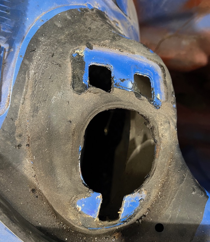

The finish of the mount is satin black.
After installation and alignment the area around the top of the mount in the trunk
is then spackled with a thick, black, tar like material. This is not seen on any 914 other
than the 914 6.
(seen on 911s too)
DennisV
post Sep 19 2023, 05:36 PM
Posts: 607
Joined: 8-August 20
From: Santa Rosa, CA
Member No.: 24,575
QUOTE(rgalla9146 @ Sep 19 2023, 04:17 PM) *
than the 914 6.
(seen on 911s too)
Thanks for sharing. That is good news. Ours is still has the material around where the mount plate was installed. Original paint underneath!
