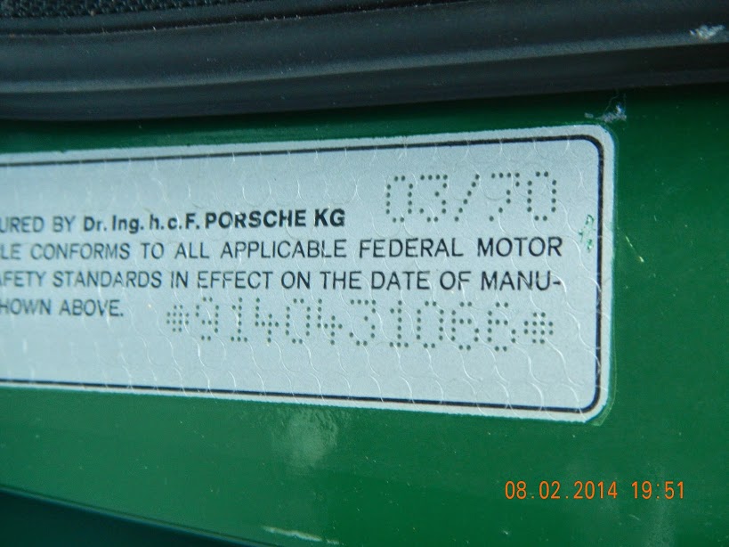

davep
post Oct 8 2023, 05:37 PM
914 Historian
Posts: 5,262
Joined: 13-October 03
From: Burford, ON, N0E 1A0
Member No.: 1,244
03/70 from 9140430729 through 9140431187
note the dot arrangement for the 7 in the 70
