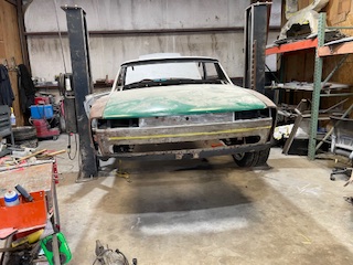

No updates in the last few months. Tried to get the Momo Heritage wheels, and they said the wait would be over a year to get them. So those are out.
Spent a lot of time on the google machine trying to find a staggered 17x8 and 17x9 with 5x130 lug pattern and the correct offset.
Ended up ordering custom wheels from American Racing VF519.
This is holding up all (visual) progress as they cannot finish pulling the fenders until the wheels are on it.
Engine is in process, and hoping to have some pics with better updates soon.

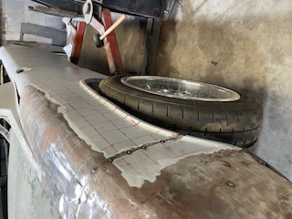

Finally got wheels and tires. (18 weeks) With the fitment of the new stuff, a 911 front end will be happening. That fender has already been pulled about an inch and a half.
Still have a ways to go. Last cuts and time for final metal work.

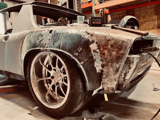

Finally have progress. If you want it done quickly/in a reasonable amount of time, I don't recommend custom everything. That has seriously delayed progress trying to make my asks reality.
We finally got the custom wheels delivered and installed. That caused us to have to re-think/increase all of the fender stretching that had been done. Both of the rears are now sized and have the rough metal work done. Both rears actuate fully without rub or restriction. The car is now 10.5 inches wider (at the rear wheels) than before.

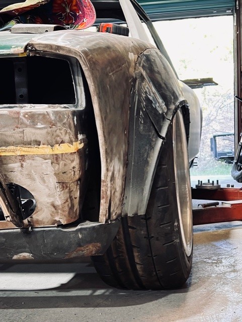

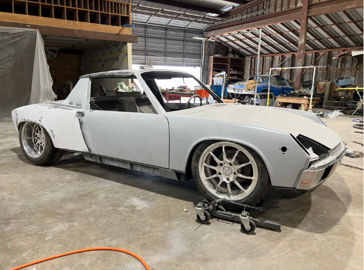

PROGRESS!!
Metal work is almost complete. These are my tires on it and its officially a roller again.

Looking good! From what vehicle did they get the fenders to graft to the rear of the car?
mate914
post Feb 17 2025, 08:04 PM
Post #35
Matt
Posts: 933
Joined: 27-February 09
From: Eagles mere, PA
Member No.: 10,102
QUOTE(Geezer914 @ Feb 17 2025, 05:42 PM) *
Looks like cut and paste. Custom... GT fenders would have less of a rocket bunny look. However its your car. I like the very end of rear fender work.
Matt (IMG:style_emoticons/default/flag.gif)
Jeff_72
post Feb 18 2025, 10:28 AM
Post #36
Posts: 55
Joined: 15-October 22
From: Texas
Member No.: 26,921
Yes, it is cut and paste, fully custom. I didn't want a GT clone. Still working on the tail end as those 10 inches they added to the rear doesn't fit seamlessly to the existing tail of the car.
