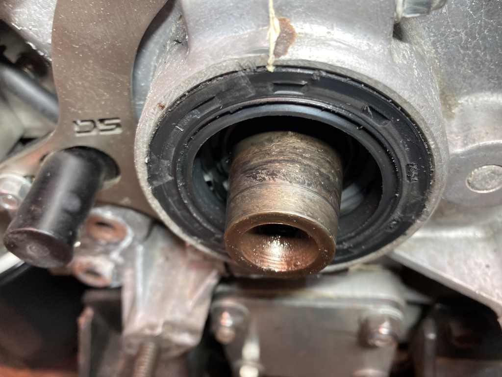

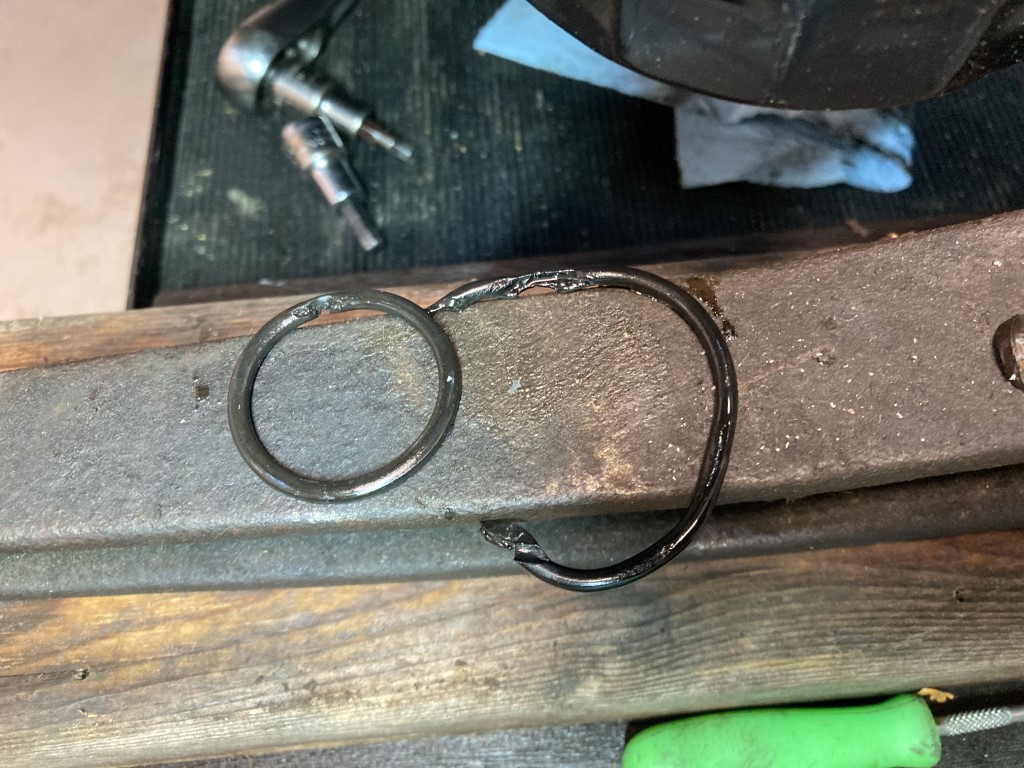

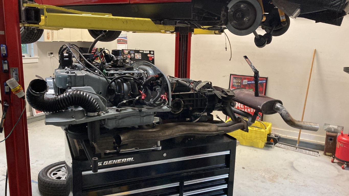

post Oct 30 2023, 01:00 PM
Posts: 2,710
Joined: 22-February 13
From: Middletown CT
Member No.: 15,565

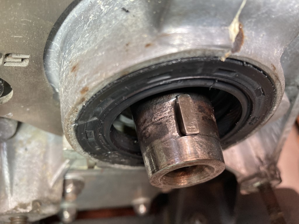

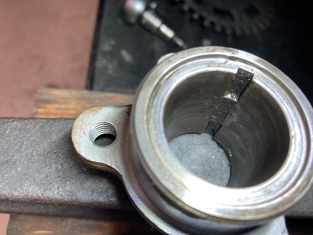

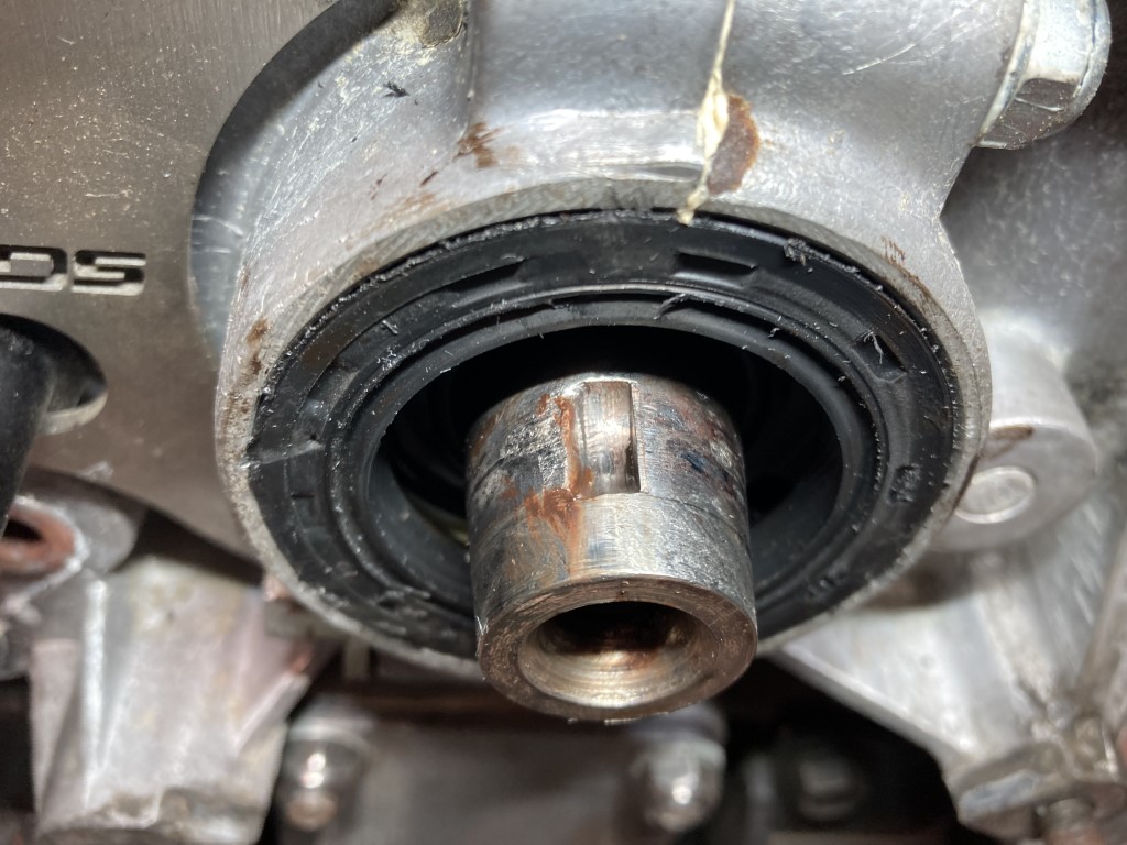

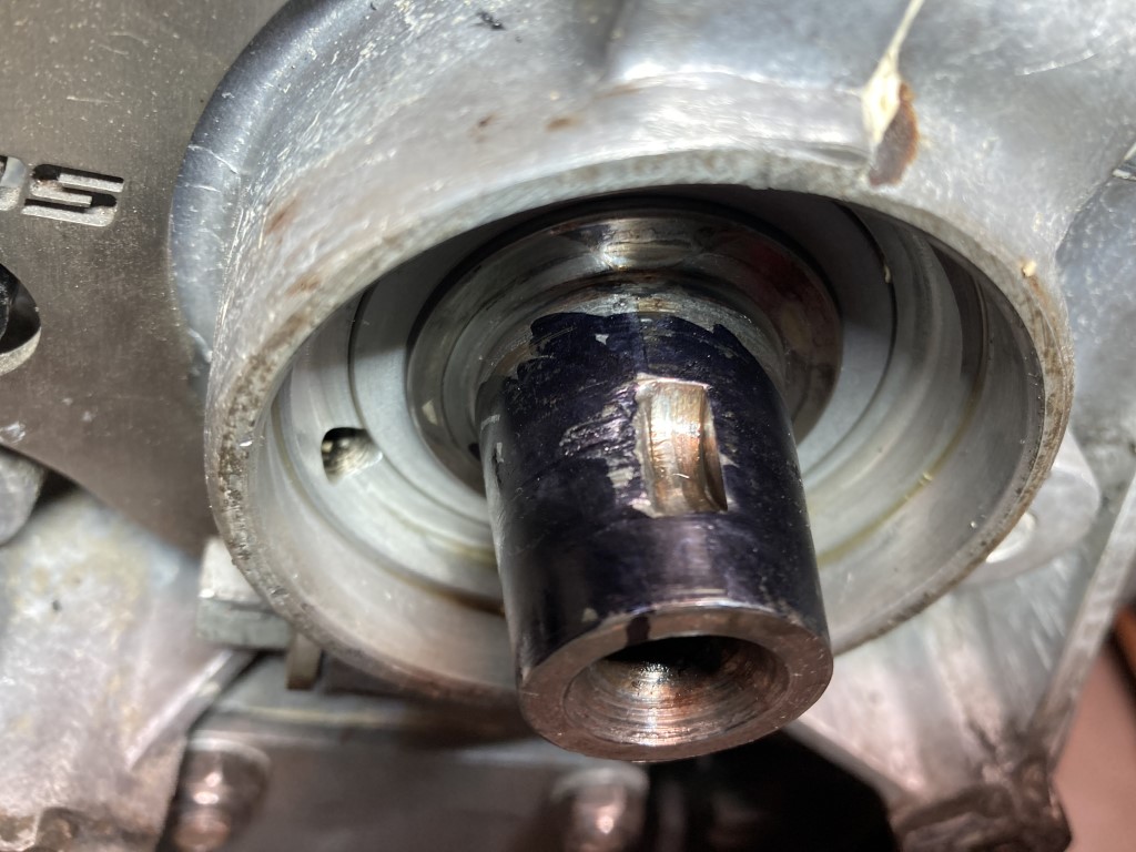

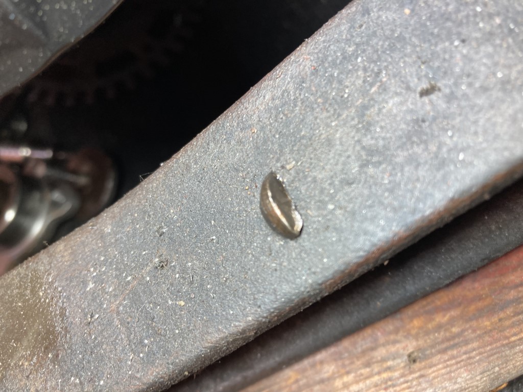

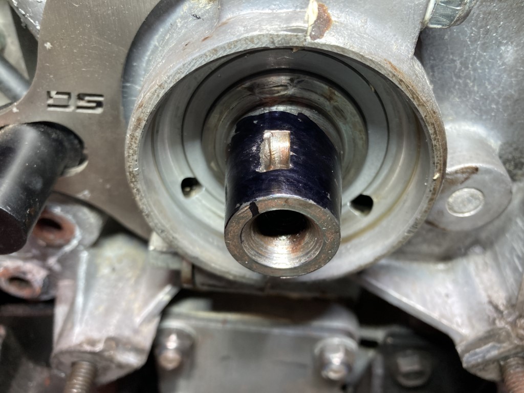

And...update. Here's several thousand words in photos.
Attached Image Attached Image Attached Image Attached Image Attached Image Attached Image Attached Image Attached Image
And a nice surprise:
