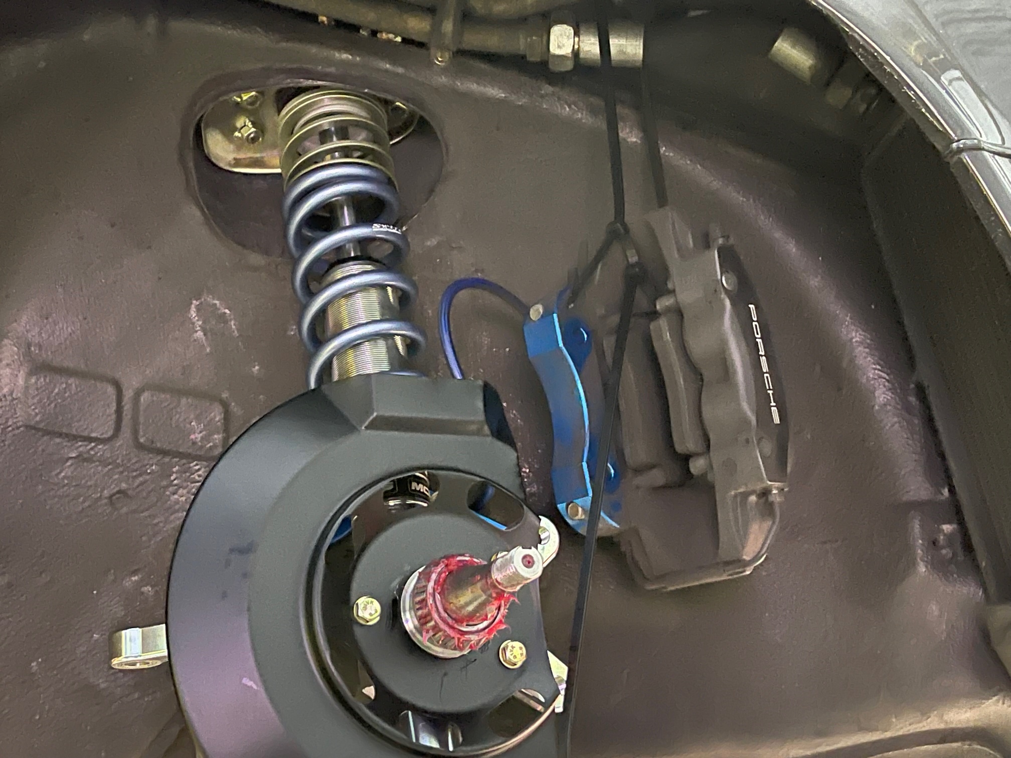

Isn’t that pretty

QUOTE(Shivers @ Nov 17 2023, 04:43 PM) *
QUOTE(mepstein @ Nov 17 2023, 12:12 PM) *
No, you can hang the calipers away from the struts with zip ties.
You can definitely take it apart piece by piece. I think it’s easier to remove and install in one unit but it’s your choice.
We have a car in the lift right now getting all new suspension, not touching the brakes.
Isn’t that pretty
SC getting MCS coil overs and Stompski sway bars. We did the Boxster brakes last year.

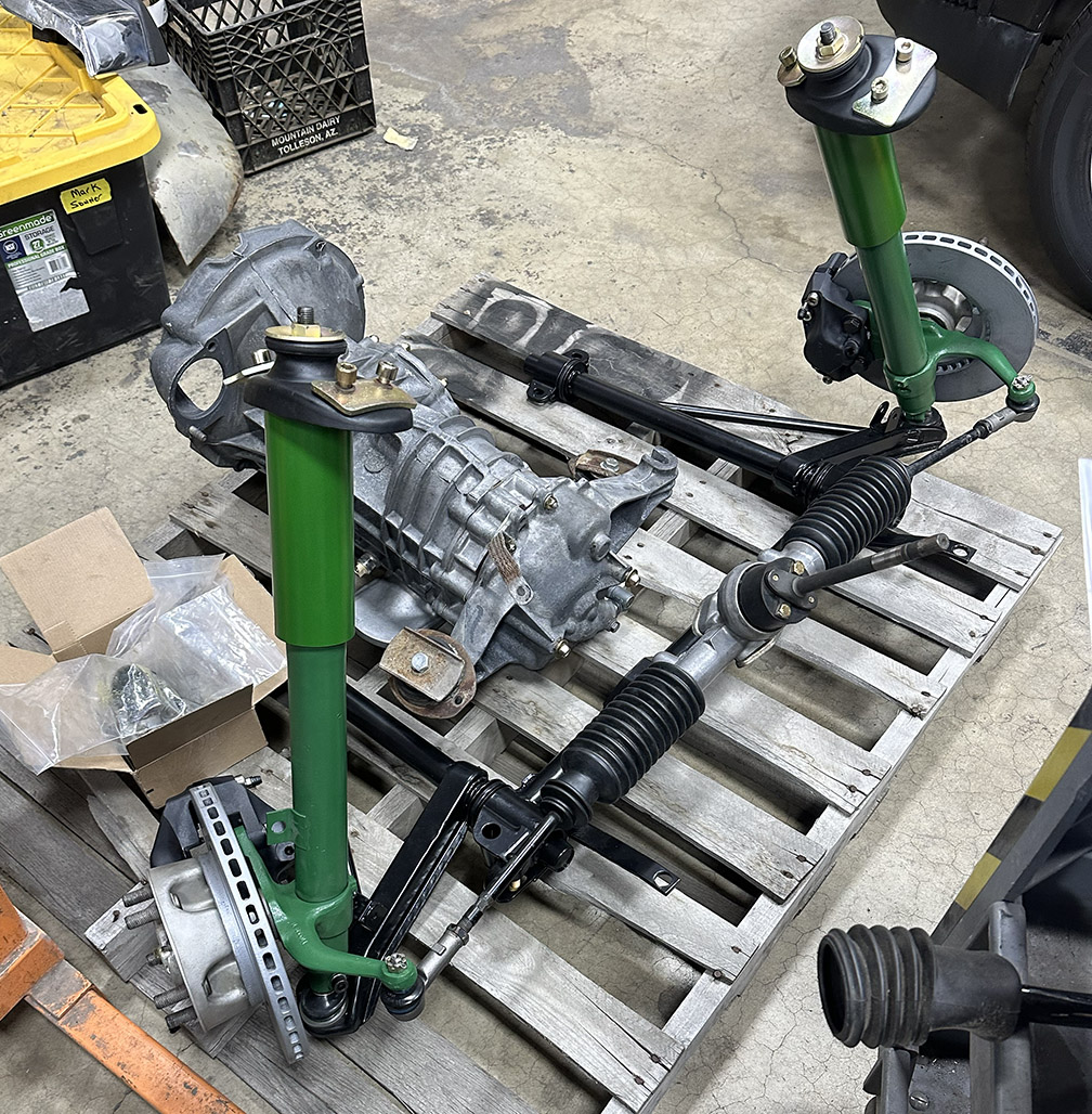

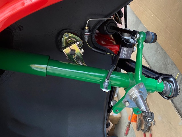

I had to post this here as well.
Shown is the front end for Mark. Sonners 2170 RAT Blue car at PMB that was going to be my V8 car, but I changed directions on it. Sent it all to PMB to finish the car. 914-4 a-arms with new rubber bushings, 911 Carrera hubs, 911 Carrera steering rack, turbo tie rods and new bearings and ball joints. Eric set it up with his Alpha calipers on 3 inch.
It is as clean as any I have seen and Eric says it is going to stop big time.
Bob B Burton

QUOTE(burton73 @ Nov 17 2023, 02:29 PM) *
Bob B Burton
That pic makes me want to drop everything. Seems like it would be easier to get at all the parts. Is that true, or from a leverage standpoint, is it easier to do some of the work I'm planning without removing the entire thing? Does the gas tank have to come out to get at what you need to drop it all?
How to do you know if the rack needs to be rebuilt?
post Nov 17 2023, 05:16 PM
Resident German
Posts: 42,257
Joined: 21-January 03
From: Oakland, Kalifornia
Member No.: 179
QUOTE(rjames @ Nov 17 2023, 03:13 PM) *
That pic makes me want to drop everything. Seems like it would be easier to get at all the parts. Is that true, or from a leverage standpoint, is it easier to do some of the work I'm planning without removing the entire thing? Does the gas tank have to come out to drop it all?
Dropping the whole front end is easy and straight forward and makes working on things a *lot* easier.
There's only one problem, you will have to lift or remove the gas tank to get to the clamp that holds the steering rack coupler to the chassis.

QUOTE(SirAndy @ Nov 17 2023, 03:16 PM) *
ahh right. (IMG:style_emoticons/default/dry.gif) Well, I've done that before, I can do it again I suppose.
After looking at the above picture again, it looks like I could leave the struts and rotor and brake stuff in place but still drop the rack, A-arms and tie rods as a unit. No?

QUOTE(rjames @ Nov 17 2023, 03:20 PM) *
Yes, you can undo the ball joints and just drop the center part.

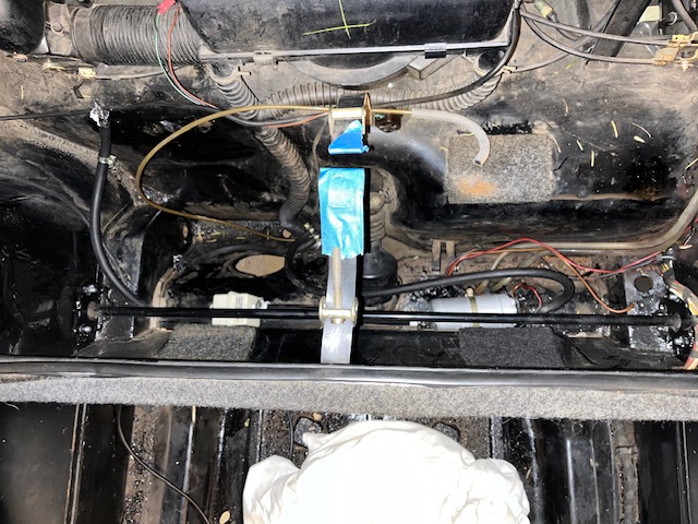

Got the tank out. Bulkhead area could use a little cleaning, but otherwise looks like it did when I had the tank out for cleaning and a sway bar install 10+ years ago. I've got a set of the stainless steel fuel lines that have been sitting in the box for awhile, so might as well get those installed now, too.
Tank still looks good.
Time to replace the gasket that goes between the expansion tank and the tank.
Ok, next round of questions:
To remove the rack, do I have to remove the master cylinder? If that's a yes, I'm now leaning towards leaving the rack in the car as getting the master cylinder installed was such a huge PITA and I only did it a couple of years ago.
If I do leave the rack in the car, is it possible to replace the steering coupler without cutting the plastic cover?

You do not need to remove the master cylinder. I dropped the full thing out at one time in 1979 in my 74 and just put a 911sc Front in place. I was in my mid 20s and it seemed easy back then. On the ground with just a jack and some stands for the front

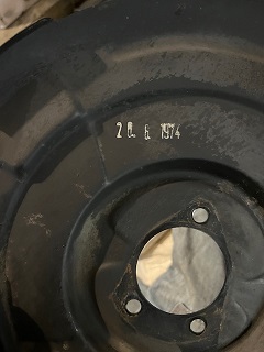

First some minutia- The dust shields on my '75 were born in '74. (IMG:style_emoticons/default/smile.gif)

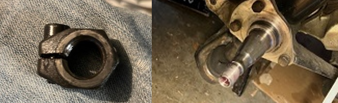

Got the ball joints loose with this awesome tool and just a breaker bar:
I must have overtightened the passenger side bearing retainer in the past because I couldn't remove it by hand. I think the spindle threads are ok because when removing the retainer it was tight through the entire length of the spindle threads and not just where it rests against the washer when installed. Will post a wtb for a left side retainer in hopes that the spindle threads are ok.

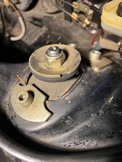

Lastly, how do I remove the shock's top bolt? When I try and loosen it, everything wants to turn- the big washer, the shock spindle and upper part of the strut housing inside the fender.
Is it possible to loosen (and re-install when the time comes) without an impact wrench? I I am using a 22mm box wrench now, but just ordered a 22mm socket. I do have a breaker bar- hoping that's enough leverage to loosen it, but can't figure out how to keep the rest of the assembly from wanting to rotate, too
I also noticed my setup doesn't include a safety tab that's supposed to be there. Am I missing a washer of some sort with the tab?
