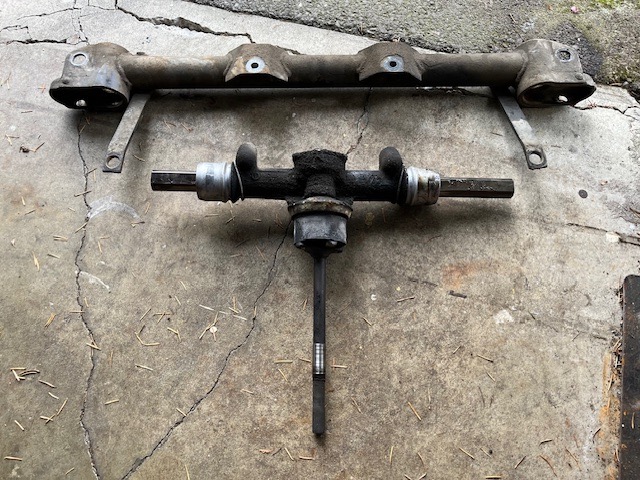

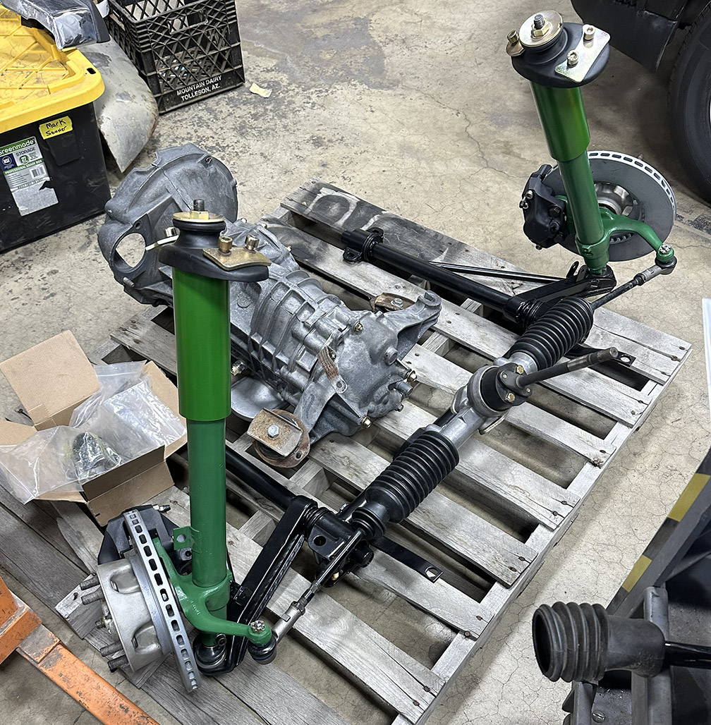

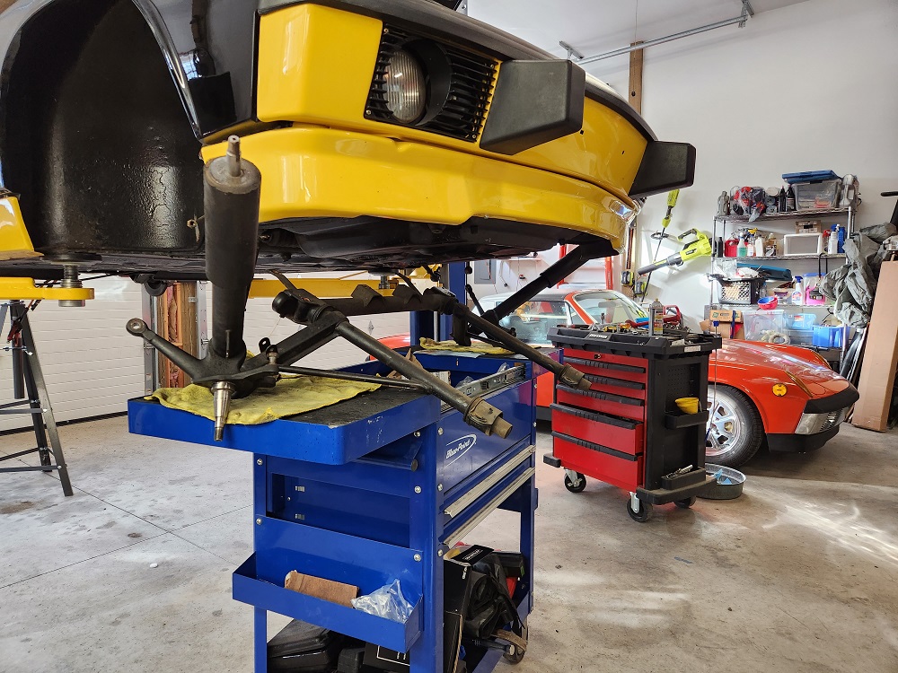

I had to post this here as well.
Shown is the front end for Mark. Sonners 2170 RAT Blue car at PMB that was going to be my V8 car, but I changed directions on it. Sent it all to PMB to finish the car. 914-4 a-arms with new rubber bushings, 911 Carrera hubs, 911 Carrera steering rack, turbo tie rods and new bearings and ball joints. Eric set it up with his Alpha calipers on 3 inch.
It is as clean as any I have seen and Eric says it is going to stop big time.

QUOTE(burton73 @ Nov 17 2023, 02:29 PM)
Bob B Burton
Click to view attachmentThat pic makes me want to drop everything. Seems like it would be easier to get at all the parts. Is that true, or from a leverage standpoint, is it easier to do some of the work I'm planning without removing the entire thing? Does the gas tank have to come out to get at what you need to drop it all?
How to do you know if the rack needs to be rebuilt?
Nov 17 2023, 05:16 PM
QUOTE(rjames @ Nov 17 2023, 03:13 PM)
That pic makes me want to drop everything. Seems like it would be easier to get at all the parts. Is that true, or from a leverage standpoint, is it easier to do some of the work I'm planning without removing the entire thing? Does the gas tank have to come out to drop it all?
Dropping the whole front end is easy and straight forward and makes working on things a *lot* easier.
There's only one problem, you will have to lift or remove the gas tank to get to the clamp that holds the steering rack coupler to the chassis.

After looking at the above picture again, it looks like I could leave the struts and rotor and brake stuff in place but still drop the rack, A-arms and tie rods as a unit. No?
Nov 17 2023, 07:23 PM
QUOTE(rjames @ Nov 17 2023, 03:20 PM)
Yes, you can undo the ball joints and just drop the center part.

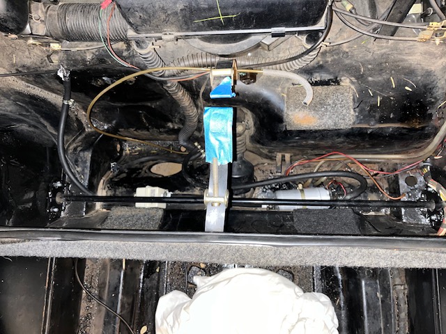

Got the tank out. Bulkhead area could use a little cleaning, but otherwise looks like it did when I had the tank out for cleaning and a sway bar install 10+ years ago. I've got a set of the stainless steel fuel lines that have been sitting in the box for awhile, so might as well get those installed now, too.
Click to view attachmentTank still looks good.

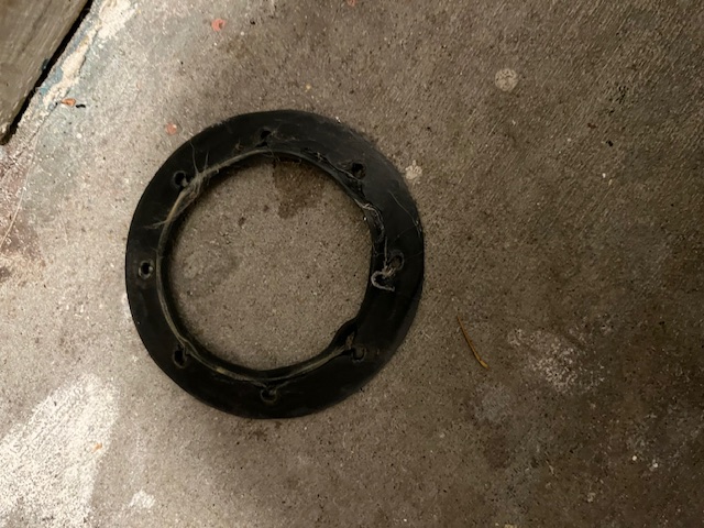

Click to view attachmentTime to replace the gasket that goes between the expansion tank and the tank.

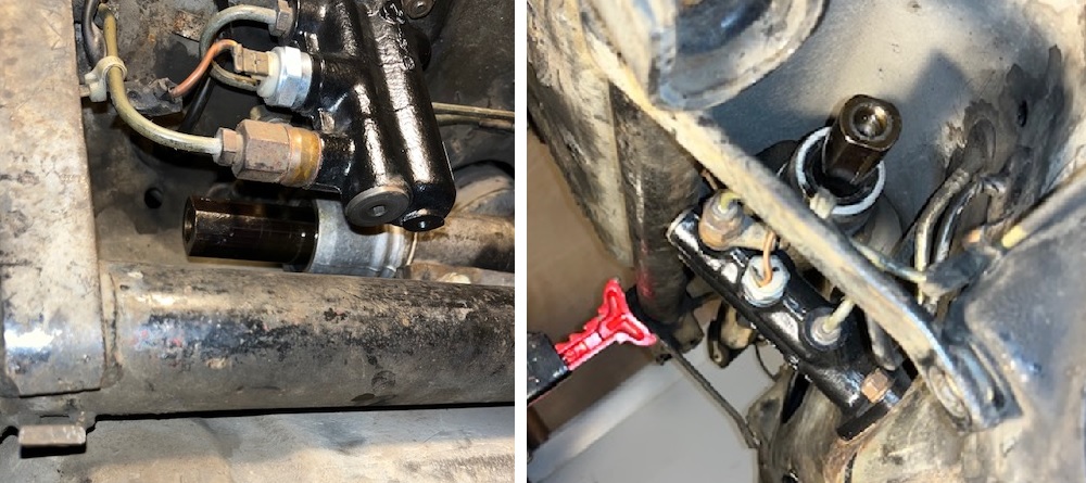

Click to view attachmentOk, next round of questions:To remove the rack, do I have to remove the master cylinder? If that's a yes, I'm now leaning towards leaving the rack in the car as getting the master cylinder installed was such a huge PITA and I only did it a couple of years ago.
If I do leave the rack in the car, is it possible to replace the steering coupler without cutting the plastic cover?
You do not need to remove the master cylinder. I dropped the full thing out at one time in 1979 in my 74 and just put a 911sc Front in place. I was in my mid 20s and it seemed easy back then. On the ground with just a jack and some stands for the front

Reading that I can remove the rack without removing the master cylinder just made my morning. Would love a 2nd confirmation before I get too excited.
Before I start removing things, anything I can do to keep the alignment near where it is? I expect I'll need a full alignment when finished with everything, but I don't want things to be so far off that I can't drive it to whatever shop eventually does the final alignment.
Nov 27 2023, 05:45 PM
QUOTE(rjames @ Nov 27 2023, 12:16 PM)
Confirmed, the MC should not interfere unless you have an aftermarket brace or brake-lines tied to the rack etc.
As for the alignment, if you are leaving the struts you *should* be pretty close to where you were on reassemble as long as you don't touch any of the adjustment nuts.
Pro tip, before you reattach the rack to the wheel side, center your steering the rack (both ends sticking out the same), lock the shaft in place, attach the steering wheel, then attach everything on the wheel ends, then unlock the shaft.
If you are removing the struts, you can mark the top plate and bolt locations to get back close to where you were.

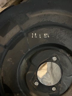

First some minutia- The dust shields on my '75 were born in '74.

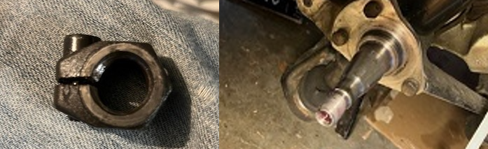

Click to view attachmentGot the ball joints loose with this awesome tool and just a breaker bar:
Click to view attachmentI must have overtightened the passenger side bearing retainer in the past because I couldn't remove it by hand. I think the spindle threads are ok because when removing the retainer it was tight through the entire length of the spindle threads and not just where it rests against the washer when installed. Will post a wtb for a left side retainer in hopes that the spindle threads are ok.

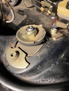

Click to view attachmentLastly, how do I remove the shock's top bolt? When I try and loosen it, everything wants to turn- the big washer, the shock spindle and upper part of the strut housing inside the fender.
Is it possible to loosen (and re-install when the time comes) without an impact wrench? I I am using a 22mm box wrench now, but just ordered a 22mm socket. I do have a breaker bar- hoping that's enough leverage to loosen it, but can't figure out how to keep the rest of the assembly from wanting to rotate, too
Click to view attachment.
I also noticed my setup doesn't include a safety tab that's supposed to be there. Am I missing a washer of some sort with the tab?

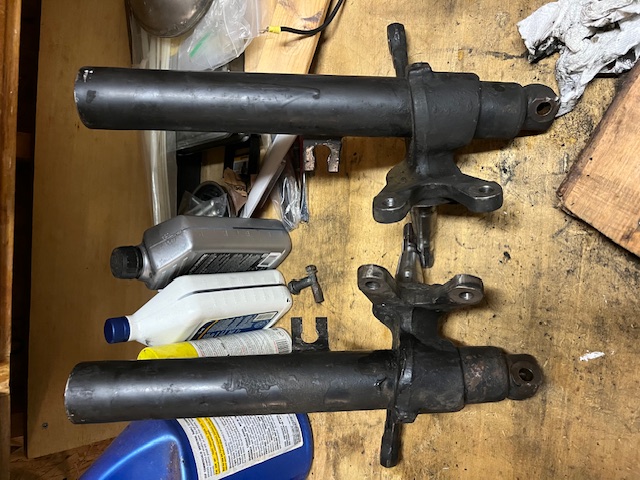

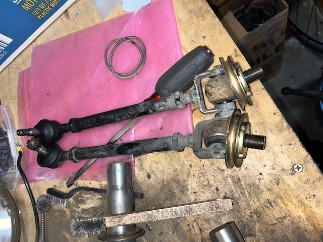

More progress, slow, but progress none the less:

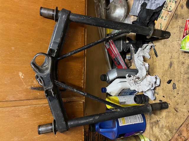

Got the struts removed after much violence with a hammer.
First came trying to separate the tie rod from where it attaches to the strut assembly. A few billion blows with a hammer didn't seem to be doing much. I ended up having to MacGyver a too small bearing puller held tight with a plumbers wrench to get them removed on each side.
The hammer redeemed itself when trying to remove the ball joints from the struts. Lots of pounding and a torch to heat things up eventually allowed me to beat the bejesus out of them into submission and get them out.

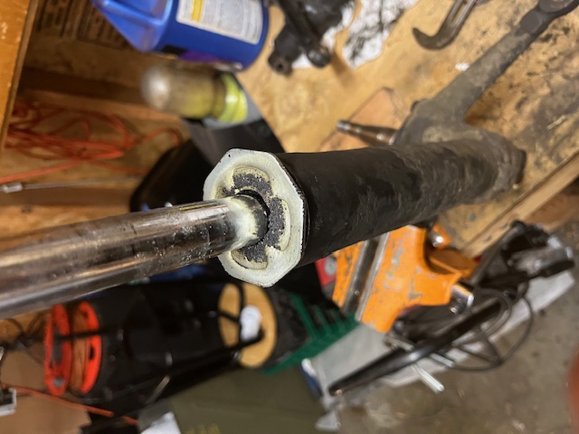

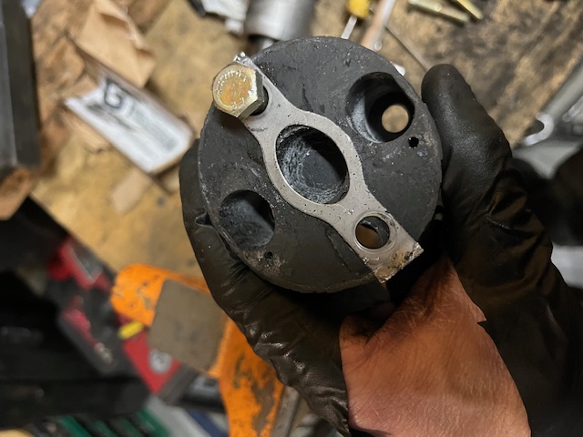

Now I've got this to deal with. All the vids show a fastener that one could use a chisel on to loosen up. Of course that isn't what I have. Stuck the strut in a vice and tried to use an adjustable wrench on it, but it would budge. Is heat applicable here, too? Should I Dremel a chunk out of it and then use a chisel and my new best friend Mr. Hammer to try and get it loose?
DennisV
Jan 27 2024, 05:35 AM
QUOTE(rjames @ Jan 26 2024, 05:47 PM)
I've had some surprisingly good luck getting stuff like this to move with a BIG pipe wrench. Though it will probably chew on the surface where it grabs. Another effective, but possibly destructive, option is an impact hammer with chisel attachment.

Got the gland nut off finally after applying heat and much swearing.

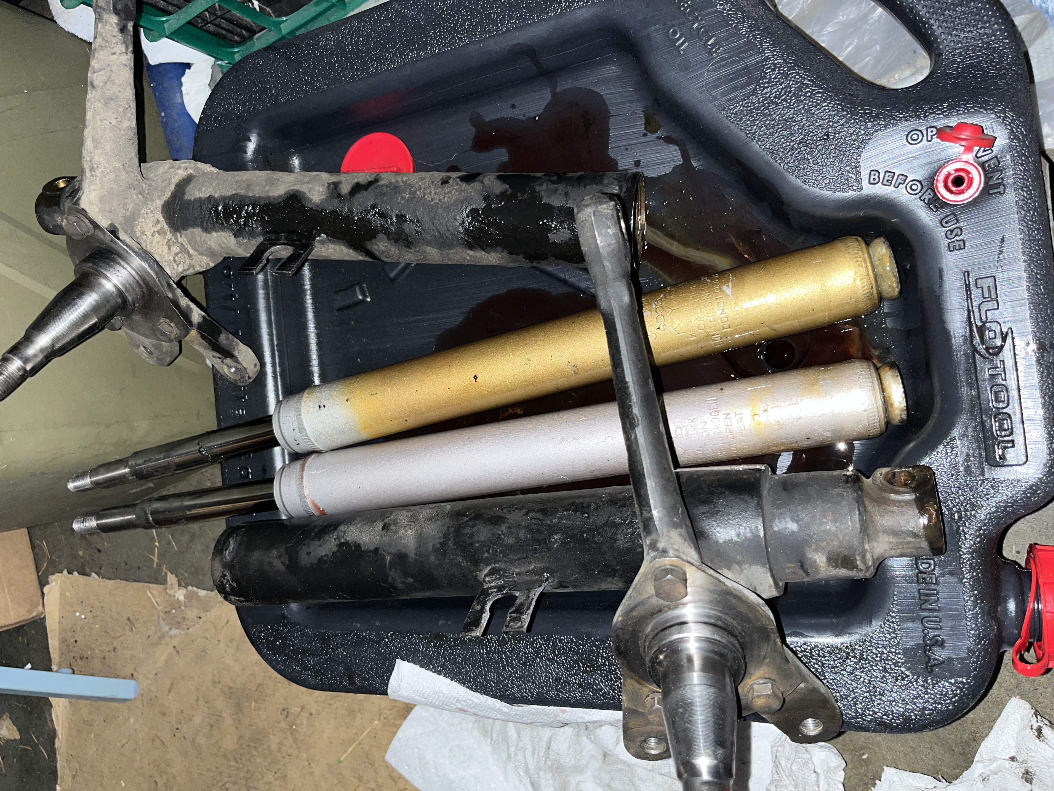

Pulled out the KYBs the PO had installed. Interesting how one is really discolored. What caused that?
Wish I could powder coat the struts, but after a bit of cleaning and minus all the oil on the outside, they’ll be going back in as is, albeit with new Konis.

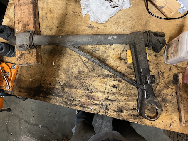

Here's where I'm at now. Cleaned up the struts and got most of the undercoating off without also taking the paint off. It's too cold for painting, otherwise I'd be inclined to strip them completely and repaint, It's a huge improvement from how they looked before, so will likely leave them as is.
Click to view attachmentLeft control arm ready for bushing removal and some cleaning.
Click to view attachmentHaven't pulled the right control arm and torsion bar yet, but here's how the left one looked. Is this too far gone to re-use?

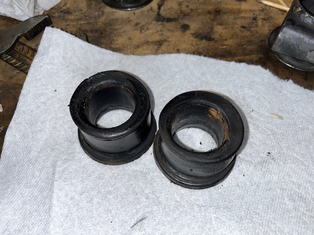

It took a while, but I got 99% of the undercoating off of the control arms without damaging the paint underneath too badly.
Bushings came off easily enough with a little heat.
Click to view attachmentBushings were definitely worn. It's easy to see why the torsion bars were rubbing. If your 914 still has the original bushings, it's time to replace them.
Click to view attachmentQuestion for
@iankarr or anyone else who wants to weigh in:
In the most helpful bushing install video Ian posted, it is said to index the the carriers at 21 and 14 degrees (front/rear), but I measured mine right before removing the bushings and they were 43 and 27 degrees (front/rear) on both sides. Anything I should be concerned about here or is that just a result of their last position when I jacked up the front end?
iankarr
Feb 9 2024, 11:20 PM
I don't remember which manual I got those numbers from, but i noticed that I had to adjust the angles slightly on installation.
Superhawk996
Feb 10 2024, 07:26 AM
21 and 14 are the correct angles to allow the LCA to align to the body at install with LCA in proper rebound position. Those numbers are in the Elephant Racing install instructions.
Rubber bushings should not rotate on the LCA if installed properly.
Whatever angles you may have had when you removed worn out and slipping bushings is irrelevant.
DRPHIL914
Feb 10 2024, 08:44 AM
@rjames wow great job, thats a big job to tackle, i did most of that about 10 years ago, but i didnt do the new strut inserts but feel like its time to do that soon, but am wrestling with whether or not i should then upgrade to actual 5 lug front not drilled 4 lug to 5 lug with studs int he OEM rotors, im just not sure itw worth the trouble and expense.
what brand strut inserts did you get? if i follow the KISS principle and just get a set of sport bilistein inserts or such, i am sure this would be the most cost effective option.
anyway , you are going to love how well your car handles with all that new gear i knowi did!!!

rjames
Feb 10 2024, 05:13 PM
QUOTE(Superhawk996 @ Feb 10 2024, 05:26 AM)
I'll index them accordingly, thanks. I'm still trying to figure out how they could be so far off. Over double the angle for both ends on both sides? What would cause that?
Superhawk996
Feb 10 2024, 08:56 PM
QUOTE(rjames @ Feb 10 2024, 07:13 PM)
Worn bushings are letting LCA rotate within them.
I suspect that when you jacked up the car, the LCA went further into rebound.
The correct position with new bushings will be in rebound below curb, but not full travel rebound to the limit of strut travel. This allows for a mild bushing preload at curb and the bushing adding a rising rate as the LCA goes into compression over bumps.
You’ll probably have to use a jack to bring the LCA up to the strut to get the ball joint attached. This assumes you are using Elephant Racing bushings. Other brands - I can’t vouch for.
rjames
Feb 10 2024, 11:02 PM
QUOTE(Superhawk996 @ Feb 10 2024, 06:56 PM)
That all makes sense- thanks. And I'm using the 914 Rubber bushings. Chose them based on the many threads comparing compounds/manufacturers. Hopefully I made the right choice as I’d like not to have to do this job again any time soon.

Spent several hours last night removing the tie rods. The lock washer that sits between the rack and the tie rod may or may not have been making things harder. I'm still having a hard time picturing how it actually keeps the tie rod from turning at all, but whatever- they will be replaced with turbo tie rods anyway.
Click to view attachmentAfter getting the passenger side off without any special tools, I remembered that I bought a tie rod removal tool which worked like a champ and allowed me to remove the driver's side easily enough without removing the master cylinder.
Click to view attachmentRemember my goal of not removing the MC because I just installed it not too long ago? Is it really going to be possible for me to remove the rack without removing the master cylinder? Based on what I'm seeing it doesn't seem possible.Click to view attachment
I sent my rack to 914rubber to be rebuilt. I left the MC in place. I don't remember it being an issue, but I had the whole suspension console off the car.

@jhynesrockmtn Thanks! Others have said the same thing but it just didn’t seem possible as I was lying on my back staring up at the bottom of the car..
I’m planning on having 914Rubber rebuild the rack. Nice bumblebee and lift. Having a lift would sure make this job easier!

Finally got some more work done.
Crossmember and rack removed without touching the MC! Based on the model# buried in grime, I have type a 'B' rack. It will be sent to 914 Rubber for a rebuild.

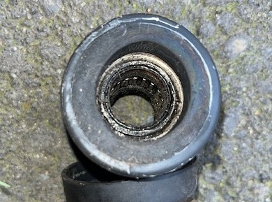

Click to view attachmentThe coupler actually looked very good, but it will get replaced anyway since I already bought the part.
Click to view attachmentPer usual, a couple of questions:Steering shaft bearing: Can I just clean and regrease this, or should I just replace it? The replacements I see for sale don't look quite the same to my eyes.

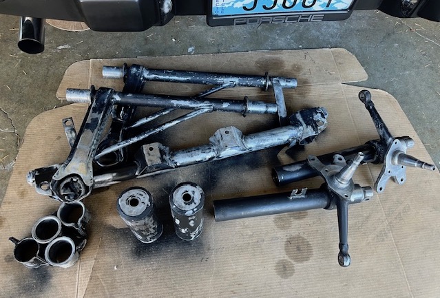

Click to view attachmentSuspension parts. I've removed all the rust and loose paint, cleaned and etched the metal for painting (powdercoating isn't in the budget).
Click to view attachmentI'm thinking about using Rustoleum Professional enamel (brush on- not the spray paint) after applying coat of their pro metal primer. Anyone have experience using this stuff? Are there other products I should be considering? Cost is a factor and I'm not interested in anything that I have to mail order or remove all of the existing paint to apply.
TargaToy
Mar 16 2024, 07:47 PM
QUOTE(rjames @ Mar 15 2024, 04:46 PM)
I used this Rustoleum on my front and rear arms and I’m extremely happy with the results. In fact I did the front strut bodies, rear hubs, and probably some other parts I’ve forgotten with the same stuff. They cured hard and glossy and feel like they were powder coated.
rjames
Mar 18 2024, 10:05 PM
@TargaToy Thanks for sharing your experience.
The primer has been applied. Topcoat in black to follow.

Looking good! I'd replace the bearing, they are cheap.

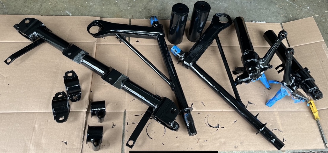

Mar 20 2024, 07:26 PM
Parts ready to go back on the car when the rack rebuild is done.

While waiting for my rebuilt rack to come back from 914Rubber, I did a thing.

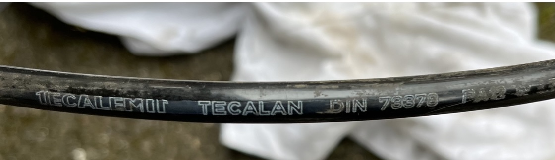

Click to view attachmentI don’t know what the old lines were made of, but they probably would’ve lasted another 50 years. Better safe than sorry, though.
Click to view attachmentTook a couple of hours just to get them out when you include removing the center console and cleaning up. I really hate dealing with the fuel lines!
Amateur tip: plugging the lines at the gas tank ends with plumbers putty will keep them from leaking gasoline in the center tunnel when you pull them out from the rear firewall and won’t interfere with their removal.
I’ll take a run at getting the SS lines installed later today.
I've done this upgrade to all of my 914s. 3 so far. Well worth the peace of mind.

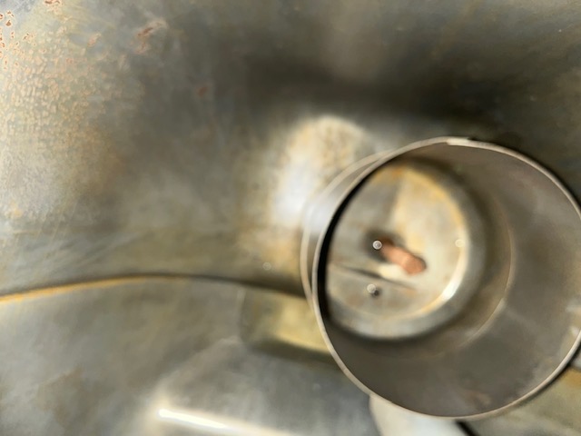

rjames
Mar 31 2024, 01:50 PM
In hindsight I wish I had left the original plastic fuel lines in tact. They showed no signs of failure, and removing them and installing the SS lines actually introduced additional failure points because after installing the SS lines, you have to add 2 rubber lines of decent length to connect the SS lines from the firewall up to the SS lines that go in the engine bay.
The original setup had the plastic lines going the way through the tunnel up into the engine bay.
If anyone with a '75 or '76 model car is contemplating the SS lines, save yourself the time and $ and keep the original setup.
