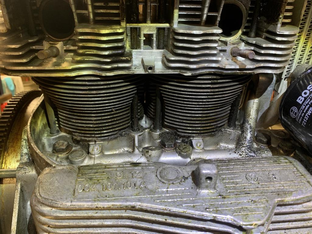

post Nov 30 2023, 07:08 PM
Post #32
Posts: 424
Joined: 1-May 14
From: LouKY
Member No.: 17,299
Still working on teardown, finding pretty much what I thought I would. I was expecting evidence of pushrod tube seal leakage, RMS leakage, and even oil pump gasket leakage, all fixable. In the pic below, I'm curious about the amount of oil on the base of the jugs where they get very friendly with the case. Also the amount of oil on the studs. This is above the inner pushrod tube seals, but it seems (to me) like I may be leaking at the base of the jugs? Which I would hate? Interestingly, and just to jinx myself, the oil cooler seals are nice and dry. There about 6K miles on this engine since complete rebuild.
