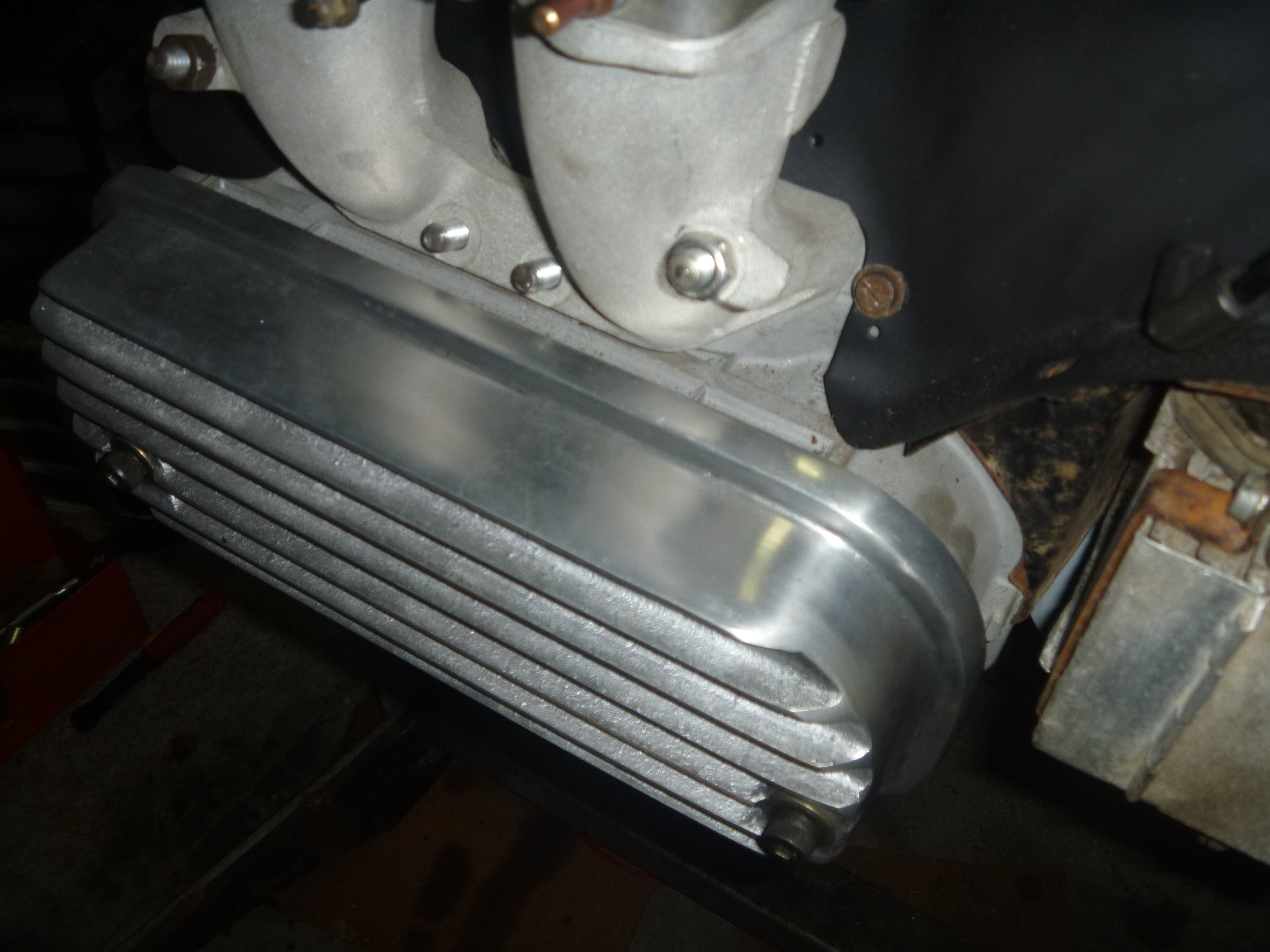

Thank you for that. I broke down and ordered a set of the CB bolt on valve covers. I have literally wanted a set since I built my first bus engine in college (in mid 80's). I couldn't afford them back then. Now even if they don't cure an oil leak, I'll have them in the shop.
914World Rocks!
Good they should be fine ,just be aware you really need to replace the rocker studs to heavy duty ones that have 8mm thread on the outside ,the puny 7mm stock ones are not up to holding rocker gear and the alloy cover .
Edit ....just had a look on CB listing ,keen sale price and they come with correct hardware so as mentioned you be happy with these .
When removing the old studs from the your heads it pays to head the stud bosses up to help them unscrew so you don't pull the threads ,I found them rather tight on my last build with these alloy covers, sorry but don't remember what torque I used but that should be in the instructions or call CB ,cheers.

ClayPerrine
post Dec 3 2023, 09:07 AM
Post #48
Posts: 16,568
Joined: 11-September 03
From: Hurst, TX.
Member No.: 1,143
QUOTE(Literati914 @ Dec 2 2023, 03:45 PM) *
QUOTE(Jack Standz @ Dec 1 2023, 01:31 PM) *
..Just looked closer at the above pushrod tubes. Those are for a type I VW, not a 914 head.
OK and there's multiple options for these on a VW 1600 apparently - so strange if nobody offered the same for a type 4.. I didn't take much time looking into it but I wonder if there are any options via the aircraft industry. If not, then here's a business opportunity for some industrious types.
I have a set of those fancy valve covers for a Type IV. Not worth the money. They don't prevent leaks any better than the stock covers, and the rubber gaskets are hard to find.
If I can find all the hardware for them, you can have them for free.

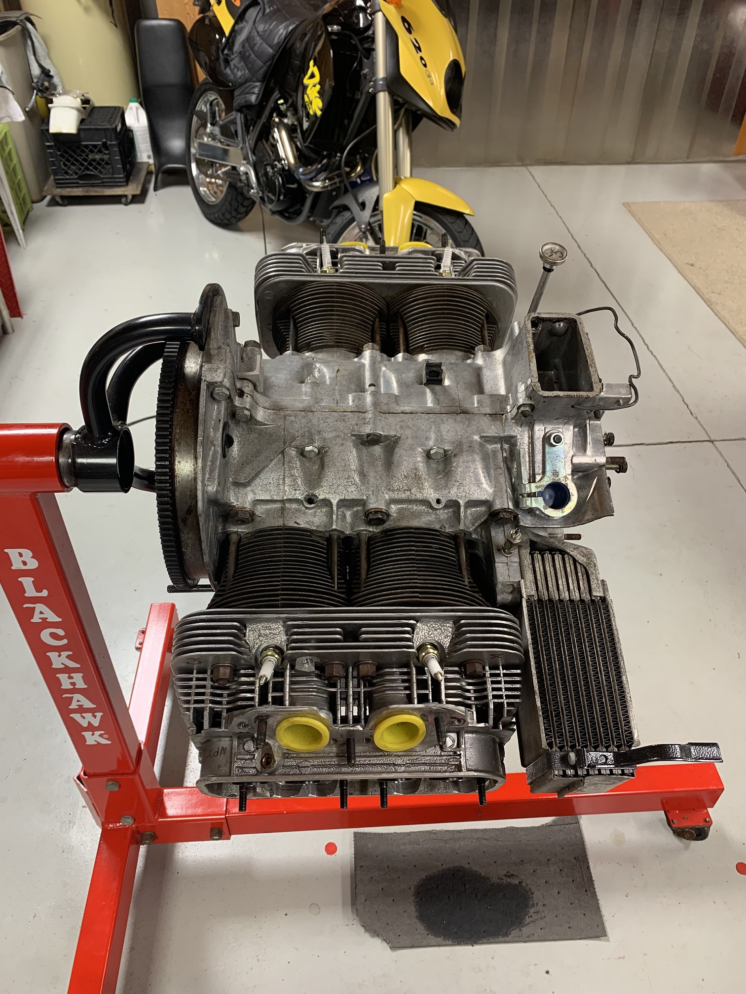

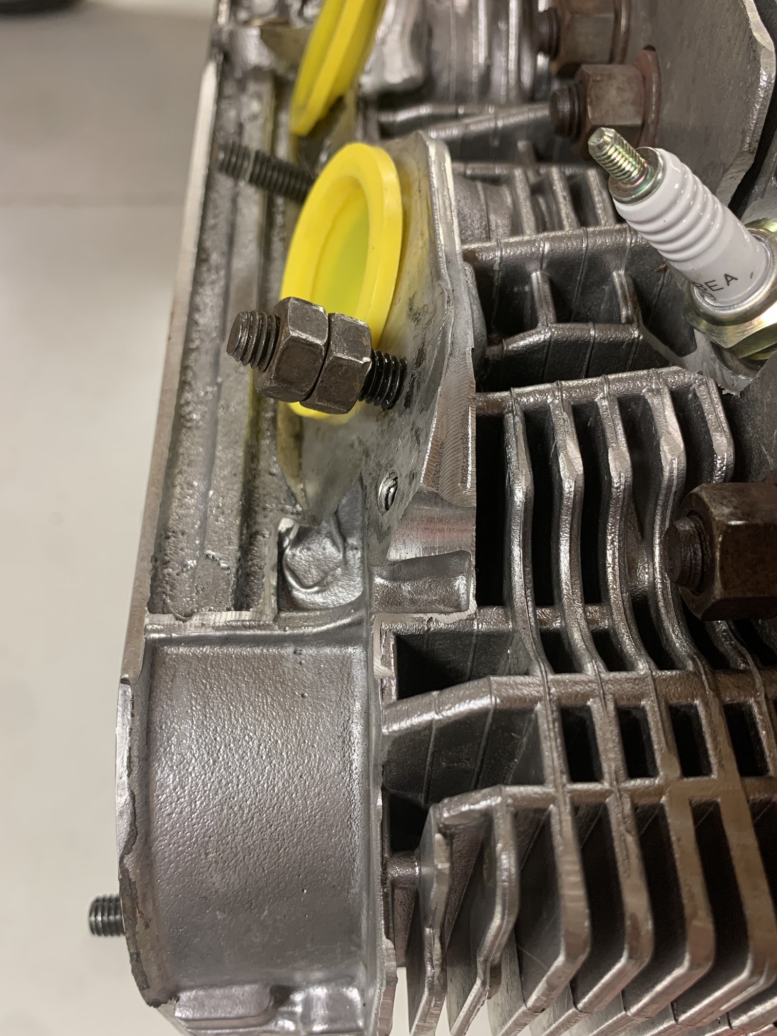

Thinking about phenolic spacers, the spacers between the cyl. head and the intake runners.
Do I need these if I am running carbs? I have been running them, along with a gasket on each side of them. I believe the rationale for running them is to provide some thermal barrier between the heads and the intake so as not to vaporize the gasoline in the float bowls. This has worked well, but the thickness of the two gaskets and the spacer gives the intake manifold nuts precious little bit on the studs?
Is there a sealant I can run in place of the gaskets and keep using the phenolic spacers?

Geezer914
post Dec 4 2023, 12:35 PM
Post #52
Geezer914
Posts: 2,375
Joined: 18-March 09
From: Salem, NJ
Member No.: 10,179
If running carbs you should run phelonic spacers to keep the fuel from boiling in the float bowls.
brant
post Dec 4 2023, 03:40 PM
Post #53
Posts: 12,282
From: Colorado
Member No.: 47
Longer studs for carbs is a standard thing
You will need them
sdoolin
post Dec 4 2023, 05:11 PM
Post #54
Posts: 424
Joined: 1-May 14
From: LouKY
Member No.: 17,299
QUOTE(brant @ Dec 4 2023, 04:40 PM) *
You will need them
Longer studs it is then. Thank you. Longer is, after all, usually better. Strangely I'm not sure where to source longer studs, so help there would be appreciated. Studs on top of the intake runners could be longer too.
I really appreciate all the help from this site!

rhodyguy
post Dec 8 2023, 12:30 PM
Post #58
Posts: 22,254
Joined: 2-March 03
From: Orion's Bell. The BELL!
Member No.: 378
You are running the shorter version of intake manifolds. You’ll notice how the base is thicker for one stud. You can’t use phenolics without longer studs for the base thickness. Hassle….CB tall intakes have the same thickness for the whole base. Either switch to tall intakes or longer studs. Phenolic spacers really help with the heat soak issue.
