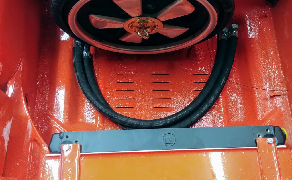

mb911   this is mine finished   Jan 5 2024, 07:51 PM
mb911   RE: Welding advice   Jan 5 2024, 07:53 PM
