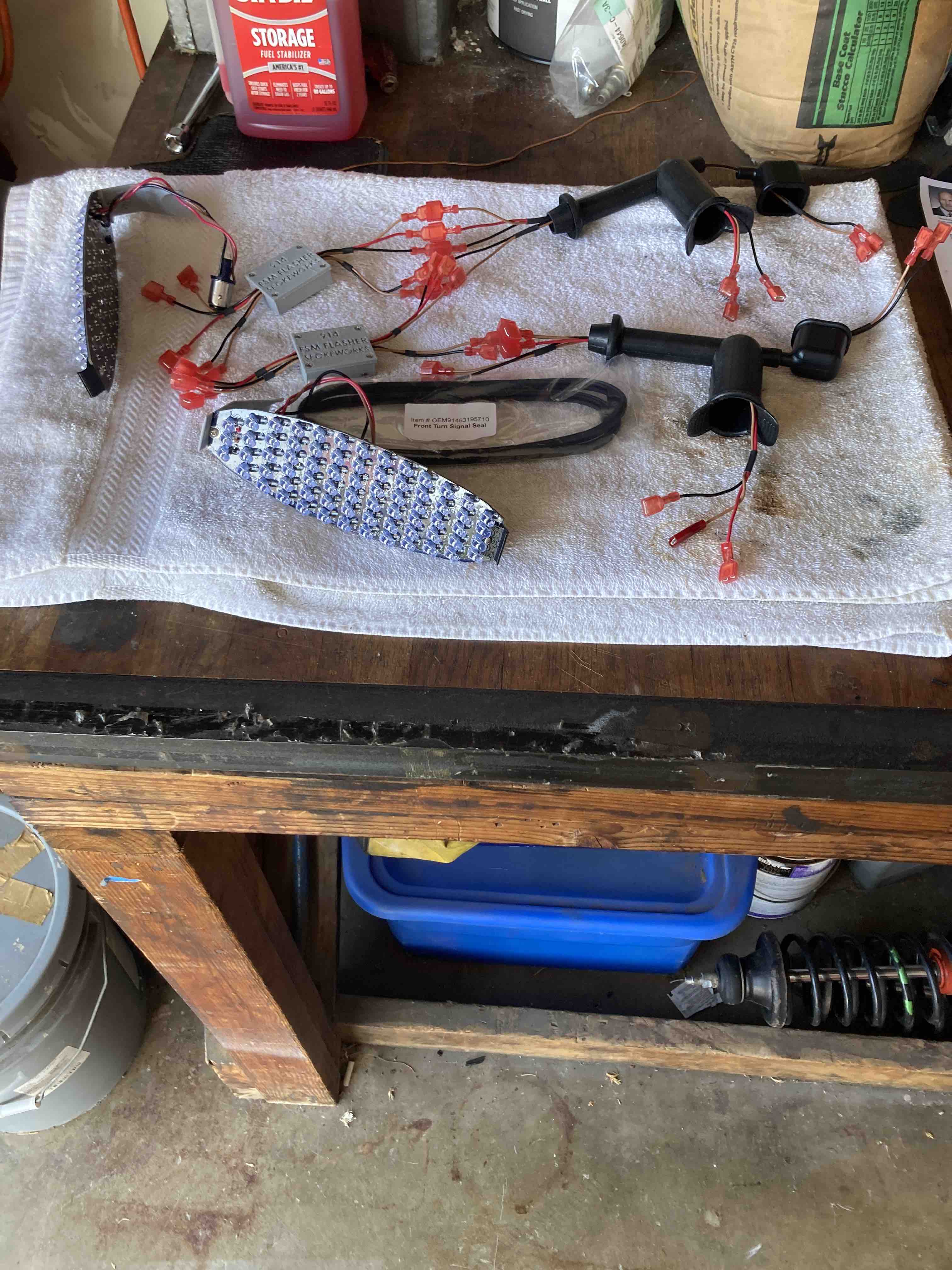

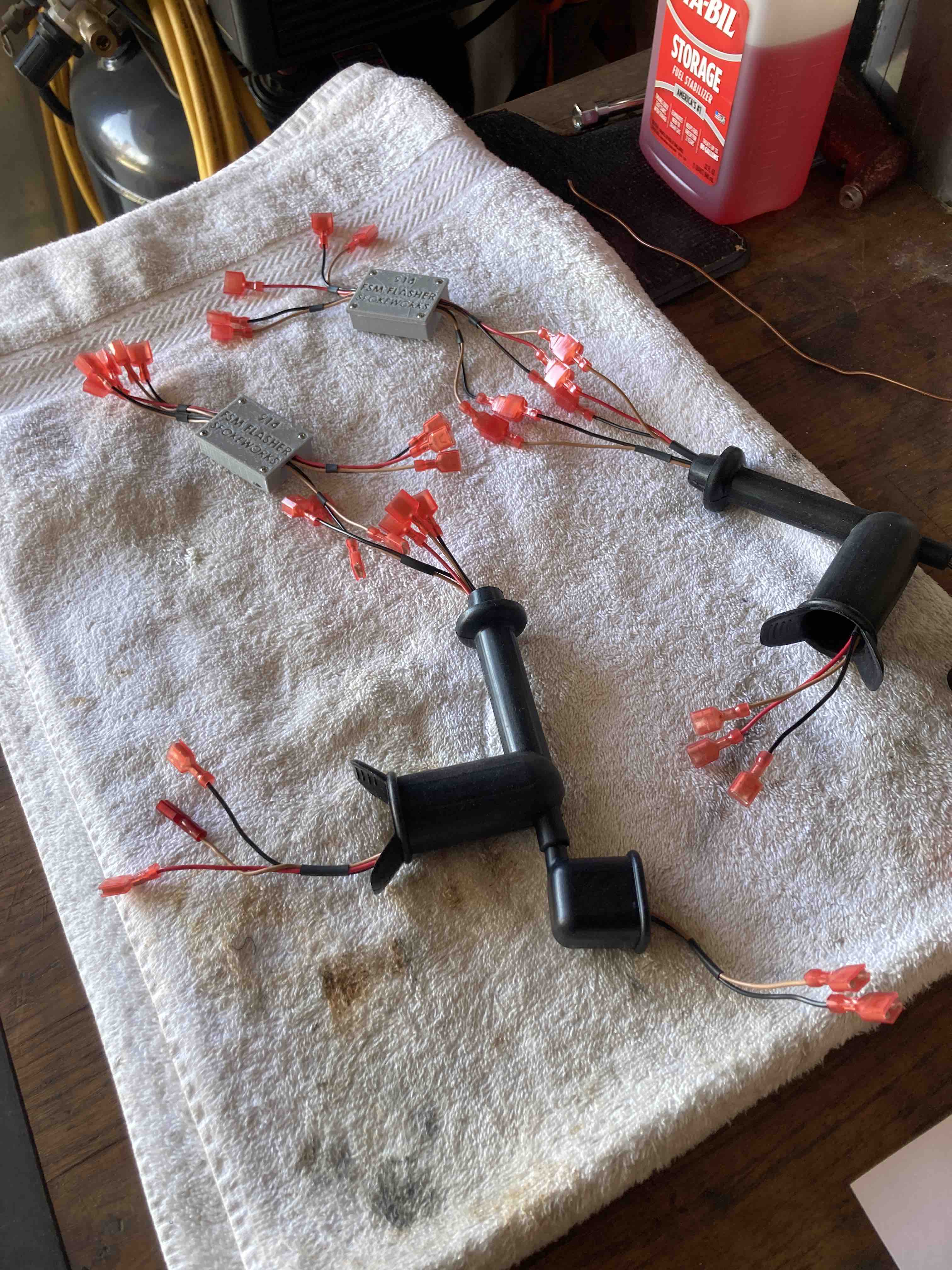

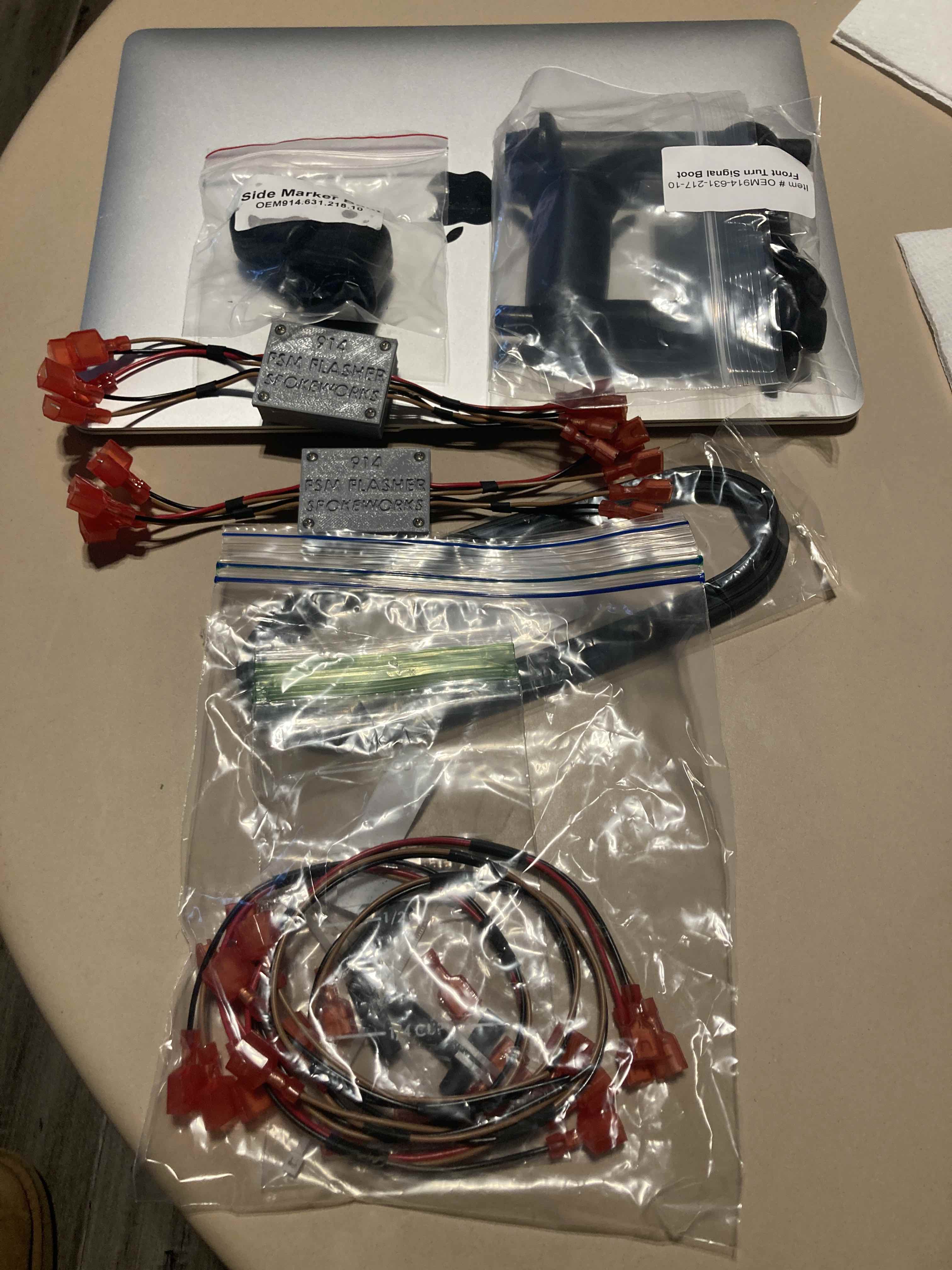

I finally had a chance to start the install of Spoke's turn signal side marker modules that will flash the side markers with the turn signals when activated . I ordered new boots for the turn signals and the side marker lights and a set of Spokes front led turn signals . I also purchased new bucket gaskets . I have pre wired the new boots with the new wiring harnesses and will start the install tomorrow and update this post .

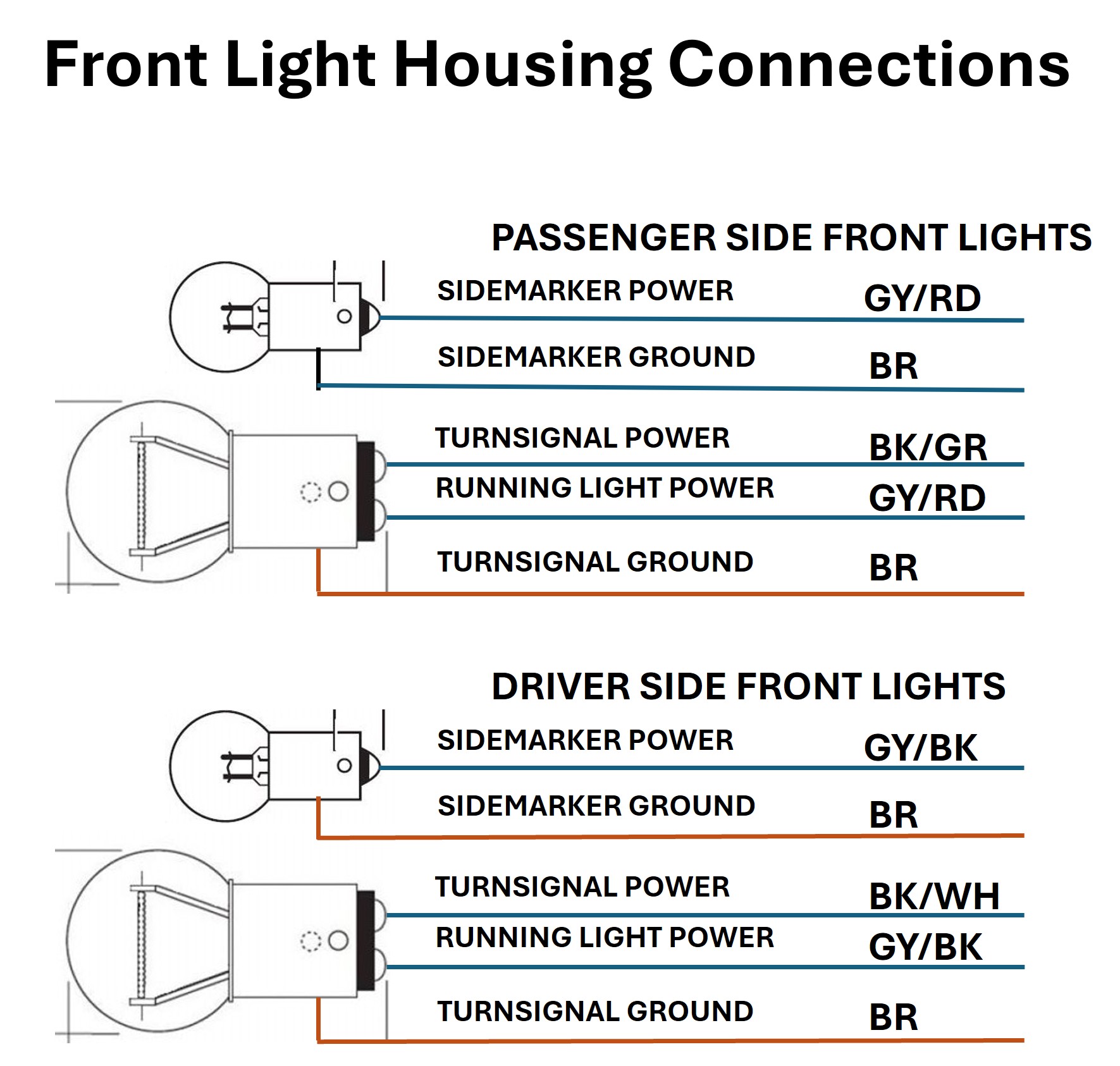

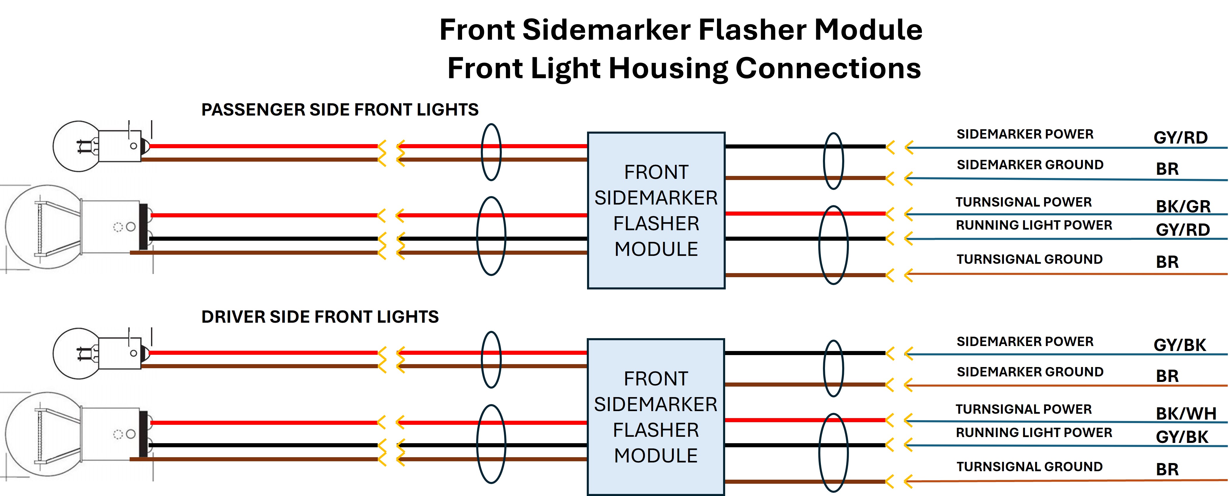

To help connections, here's a before connection and after connection of the FSM flasher. Not 100% sure of the wire colors.

A bit more description and gender correction of the connections at the bulbs and of the QC connectors.
