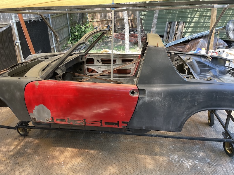

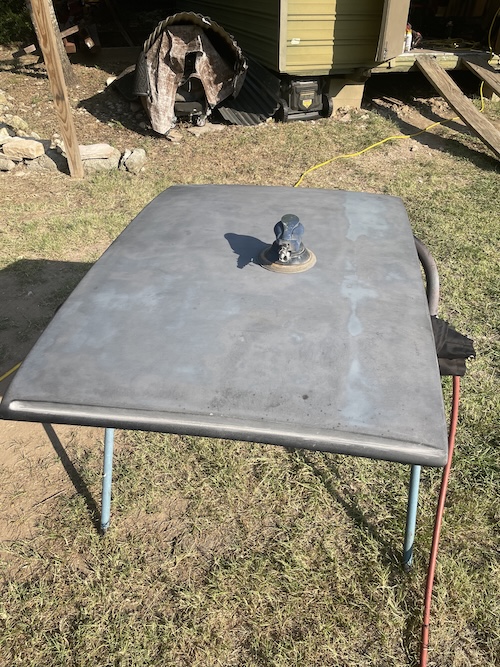

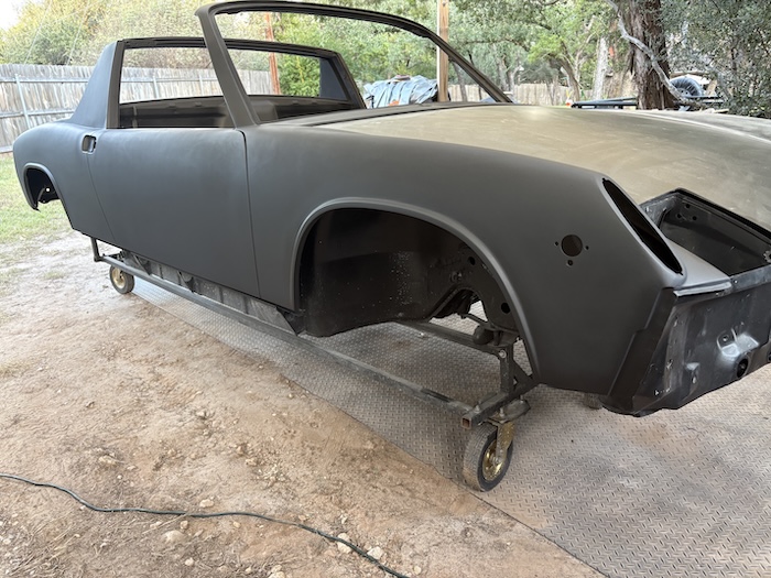

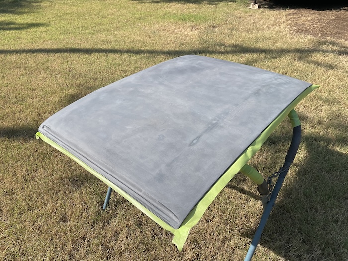

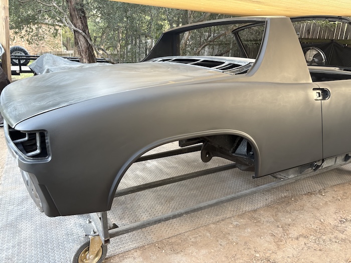

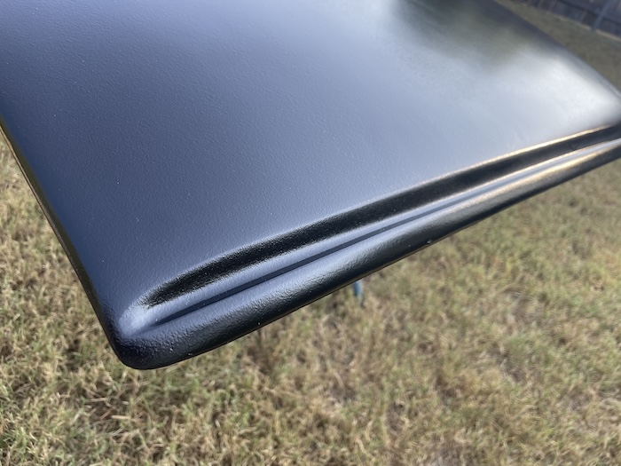

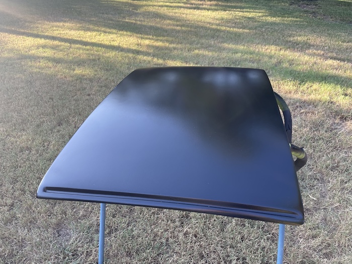

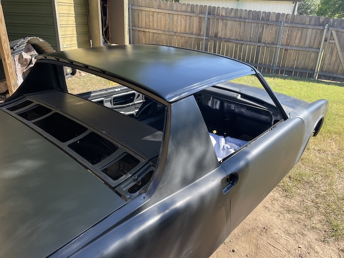

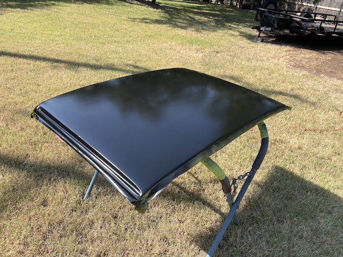

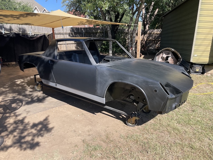

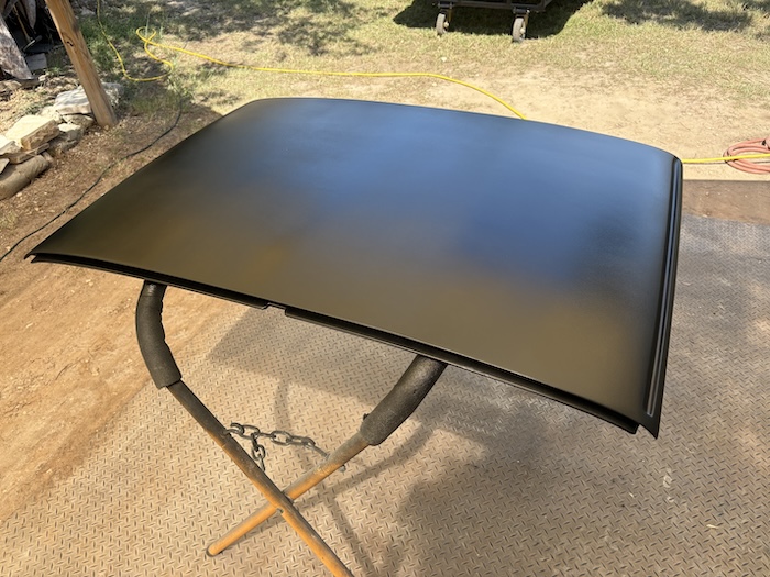

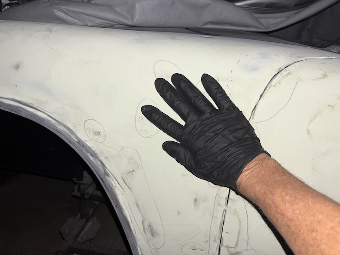

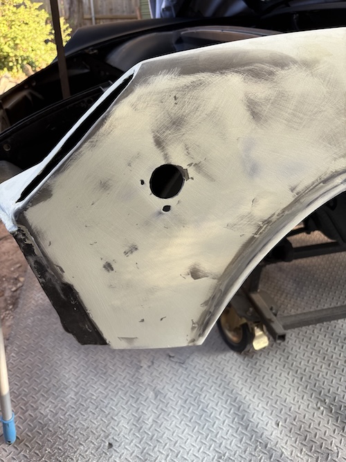

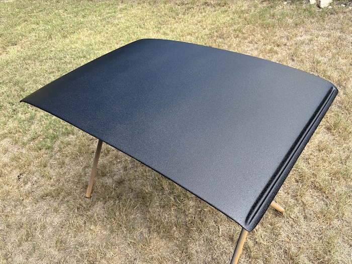

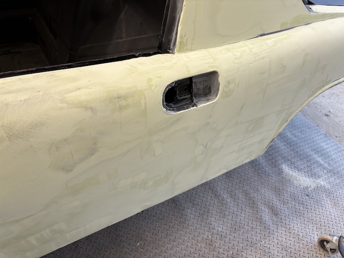

friethmiller   Paint Removal: My daughter and I spent many hours...   Dec 13 2023, 12:07 PM
technicalninja   You've already made serious progress. Some par...   Dec 13 2023, 01:04 PM
friethmiller   You've already made serious progress. Some pa...   Dec 13 2023, 01:12 PM

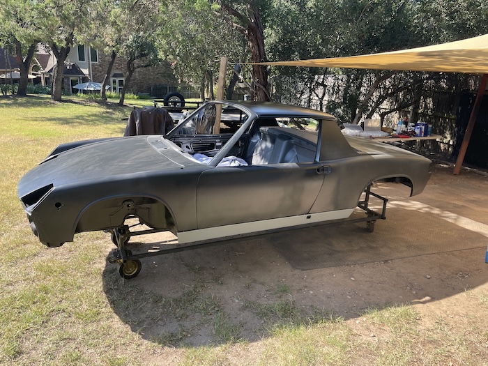

friethmiller   Inner Firewall / Transverse (12/2022): Before I co...   Dec 15 2023, 09:29 AM
friethmiller   Tunnel and Crossbar (12/2022): After purchasing a ...   Dec 15 2023, 09:43 AM
Aerostatwv   Awesome work! At first glance, I thought you w...   Dec 15 2023, 10:12 AM
friethmiller   Awesome work! At first glance, I thought you ...   Dec 15 2023, 11:16 AM
technicalninja   The wildest thing is he's doing this in the DI...   Dec 15 2023, 11:49 AM

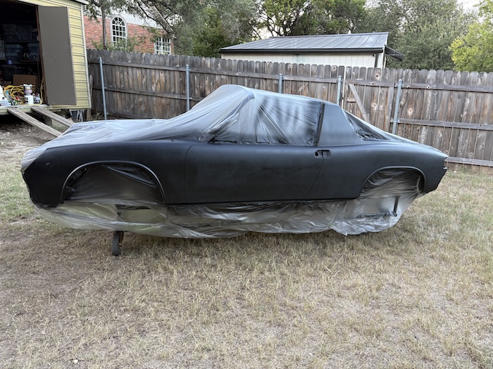

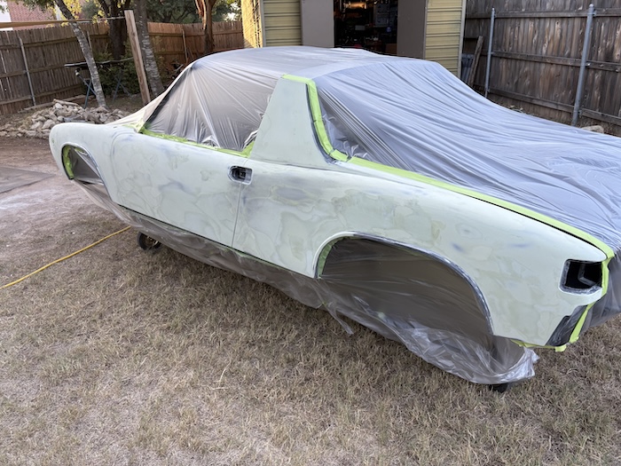

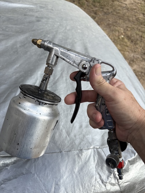

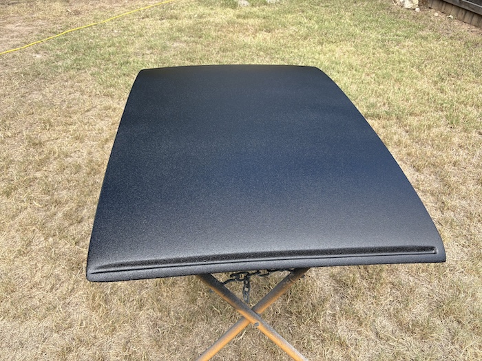

friethmiller   Are you planning on painting it in the dirt as we...   Dec 15 2023, 12:24 PM
technicalninja   Looks like you kicked ass on the first paint job a...   Dec 15 2023, 12:33 PM

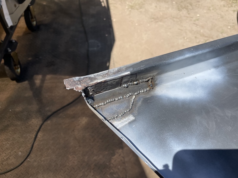

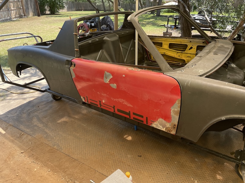

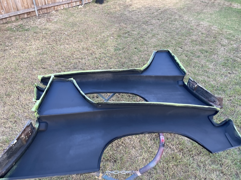

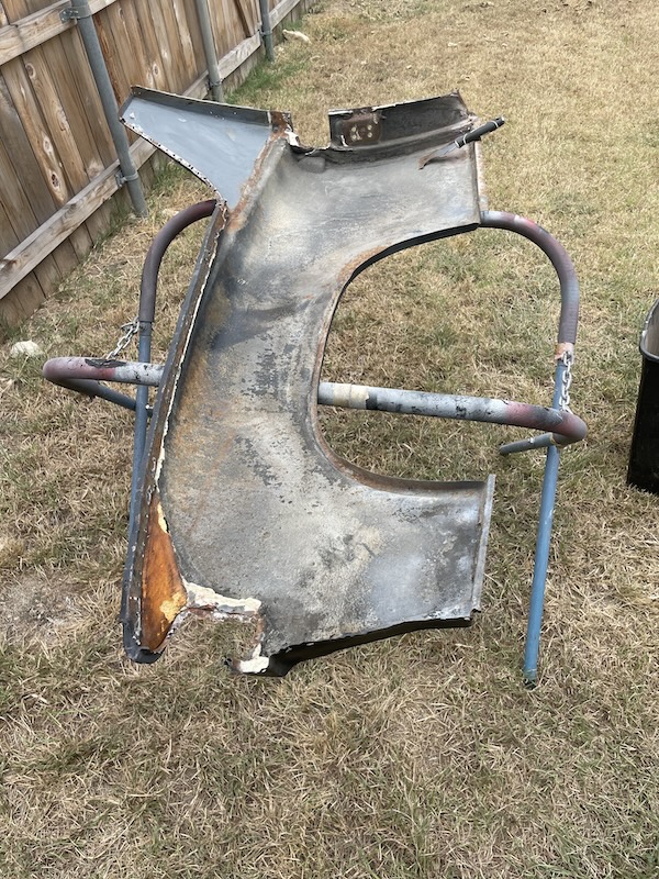

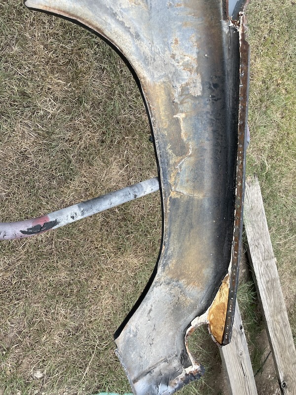

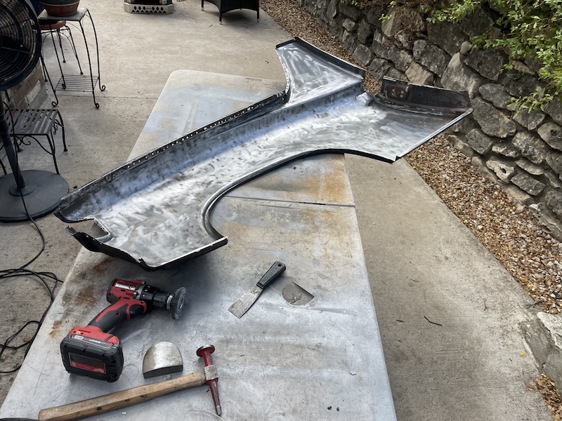

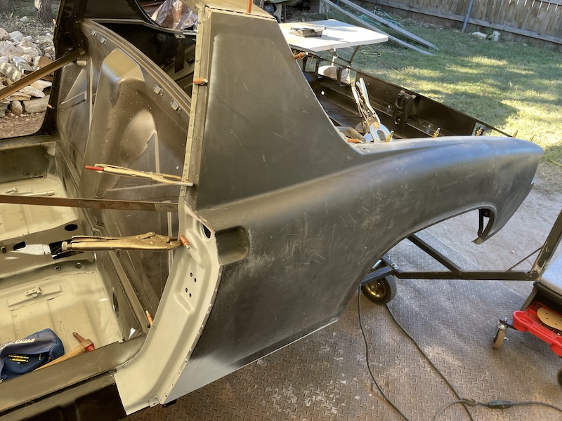

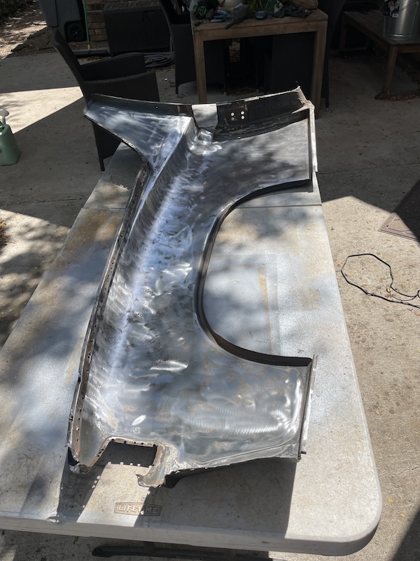

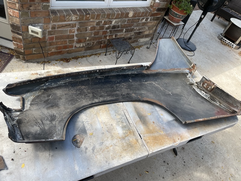

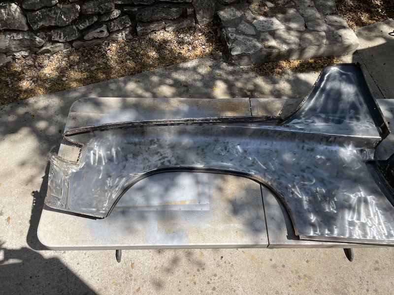

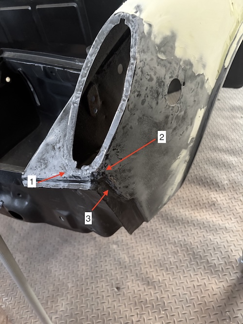

friethmiller   Rear Fender Removal (1/2023): The following photo...   Dec 16 2023, 09:50 PM

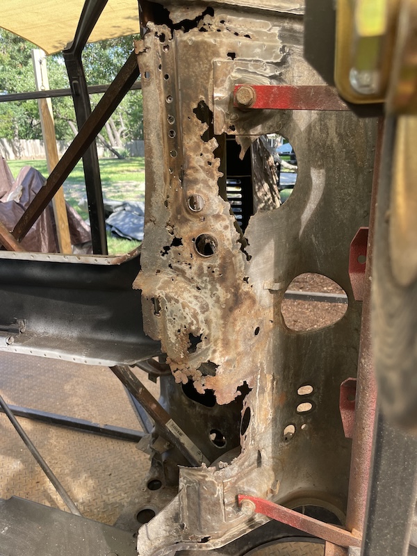

friethmiller   Passenger Side Longitudinal - Part 1 (1/2023): It...   Dec 18 2023, 11:02 AM
technicalninja   Nasty! Now I'm worried about my heater tu...   Dec 18 2023, 11:51 AM

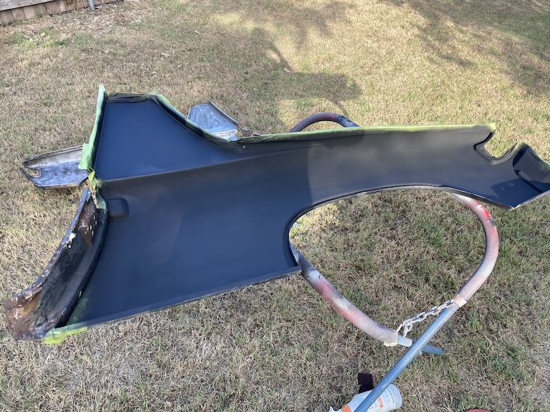

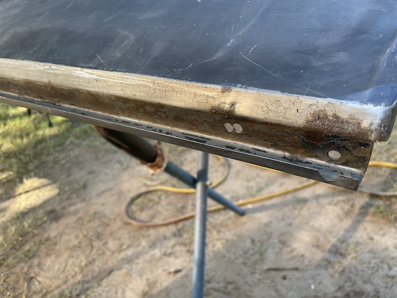

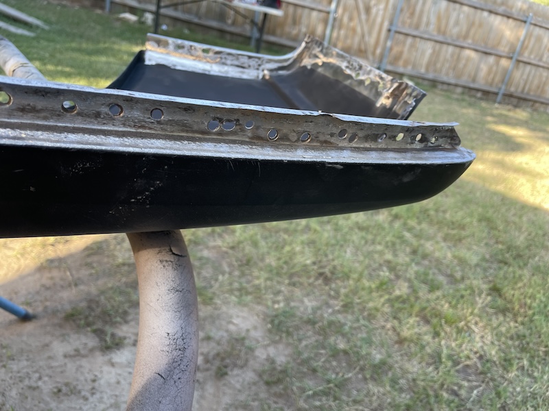

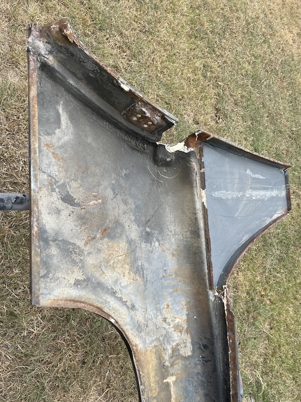

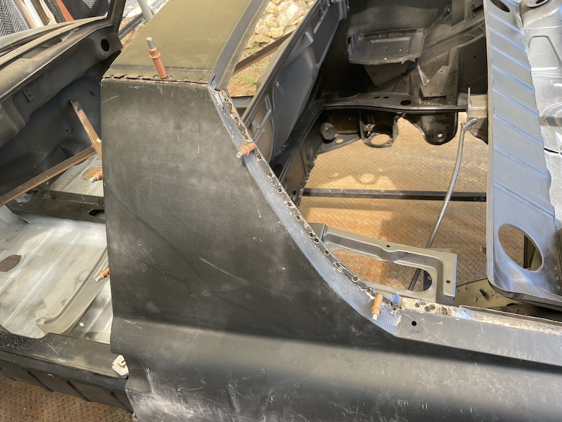

friethmiller   Inner Fender Replacement (3/2023): Before getting...   Dec 19 2023, 05:03 AM

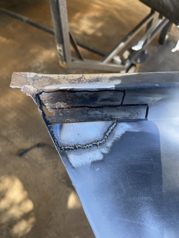

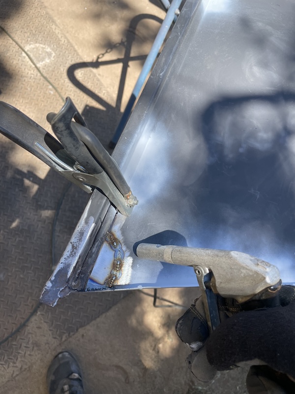

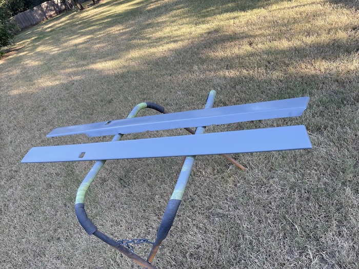

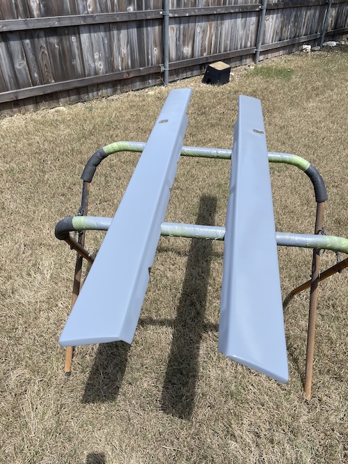

friethmiller   Rocker Panel Replacement (3/2023): I finally get ...   Dec 19 2023, 05:15 AM

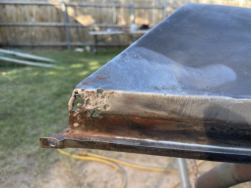

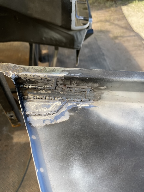

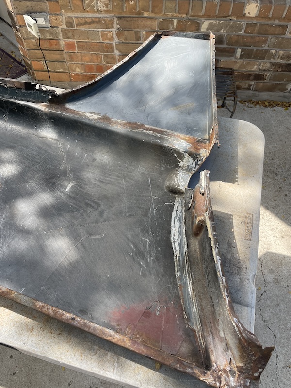

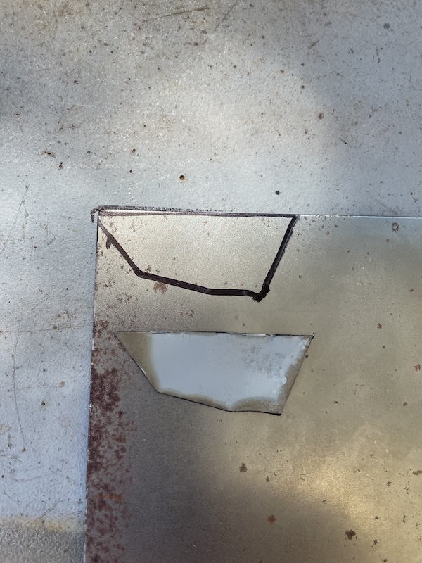

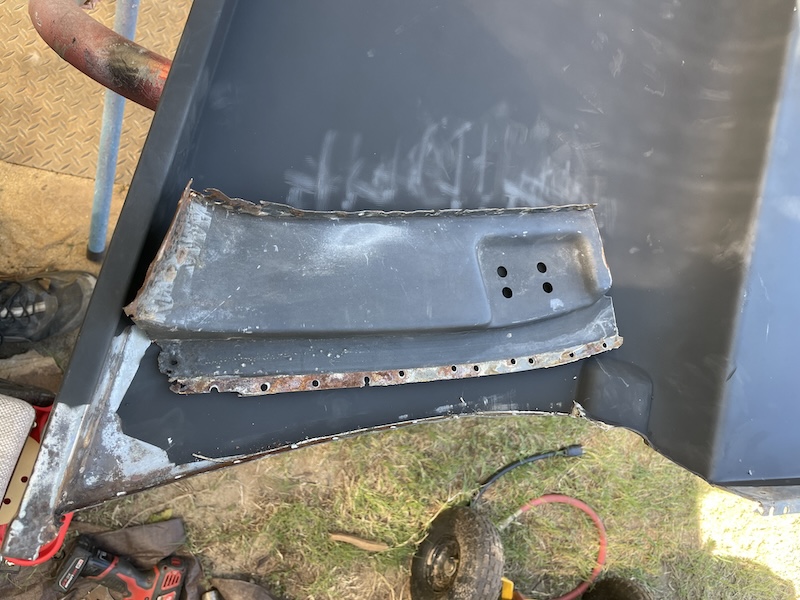

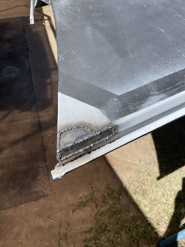

friethmiller   Fender Support Repair (4/2023): The final step in ...   Dec 19 2023, 08:29 AM

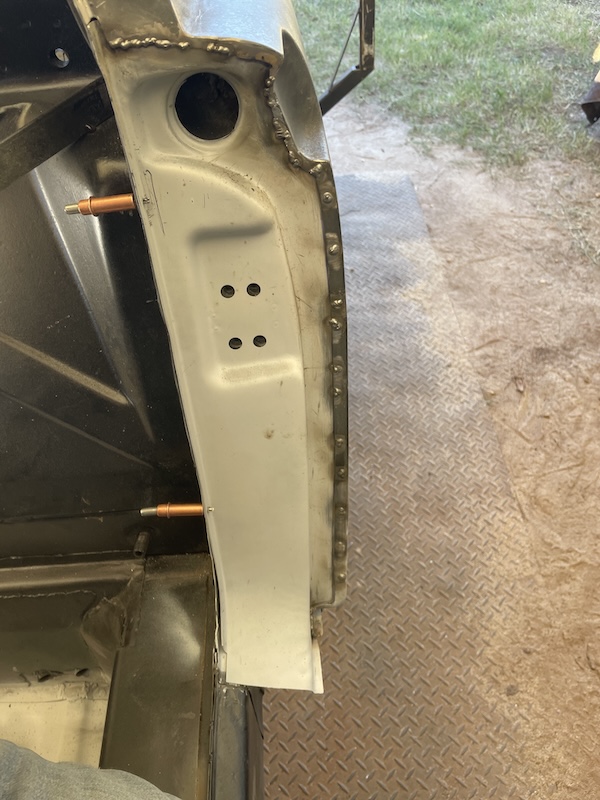

friethmiller   Outer Hell Hole Repair (4/2023): Here we go! ...   Dec 19 2023, 04:05 PM
friethmiller   Inner Hell Hole Repair (5/2023): The first photo s...   Dec 19 2023, 07:30 PM

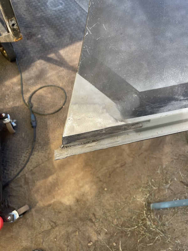

friethmiller   Inner Rail/Fender Repair - Part 1 (6/2023): After...   Dec 23 2023, 09:00 PM
friethmiller   Inner Fender Repair - Part 2 (7/2023): In the ini...   Dec 23 2023, 09:26 PM
friethmiller   Inner Fender Repair - Part 3 (7/2023): The follow...   Dec 23 2023, 09:38 PM
friethmiller   Inner Fender Repair - Part 4 (7/2023): With the in...   Dec 24 2023, 08:37 AM

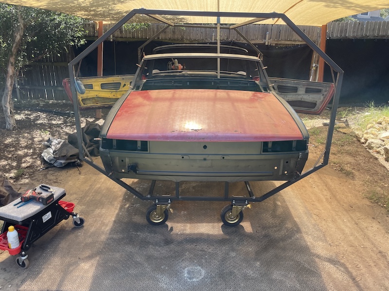

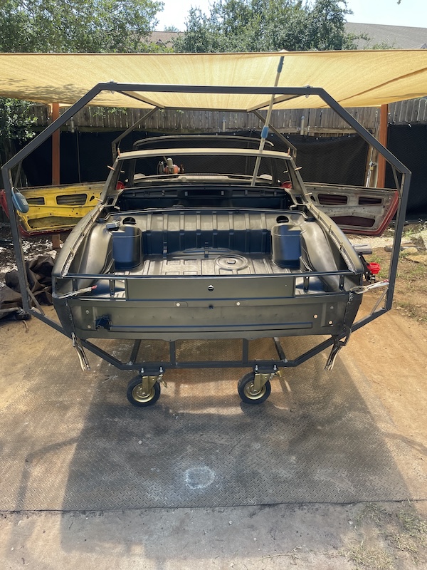

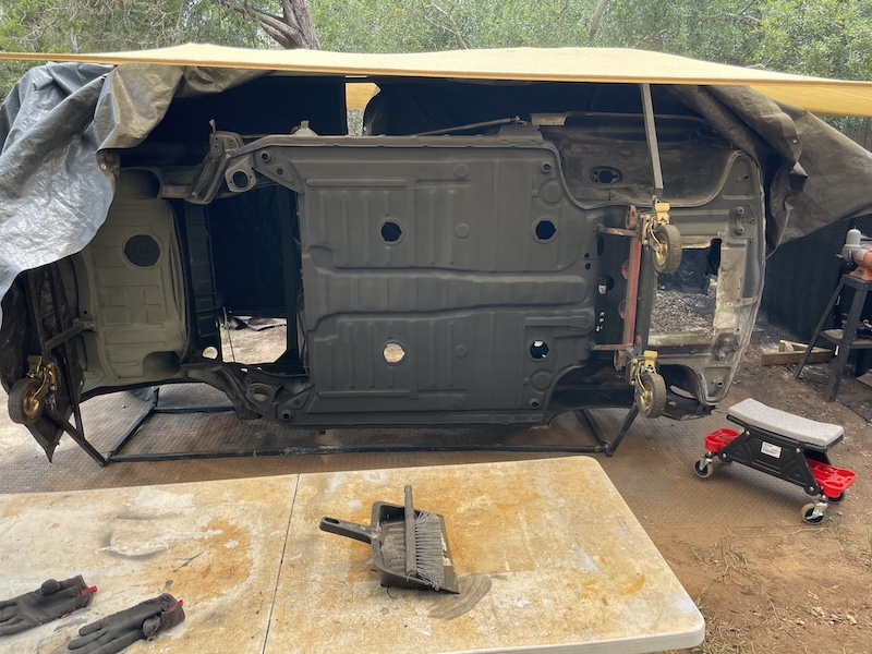

friethmiller   Rotisserie (10/2023): Having completed the repairs...   Dec 24 2023, 11:22 AM

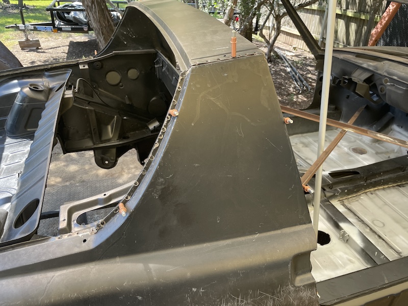

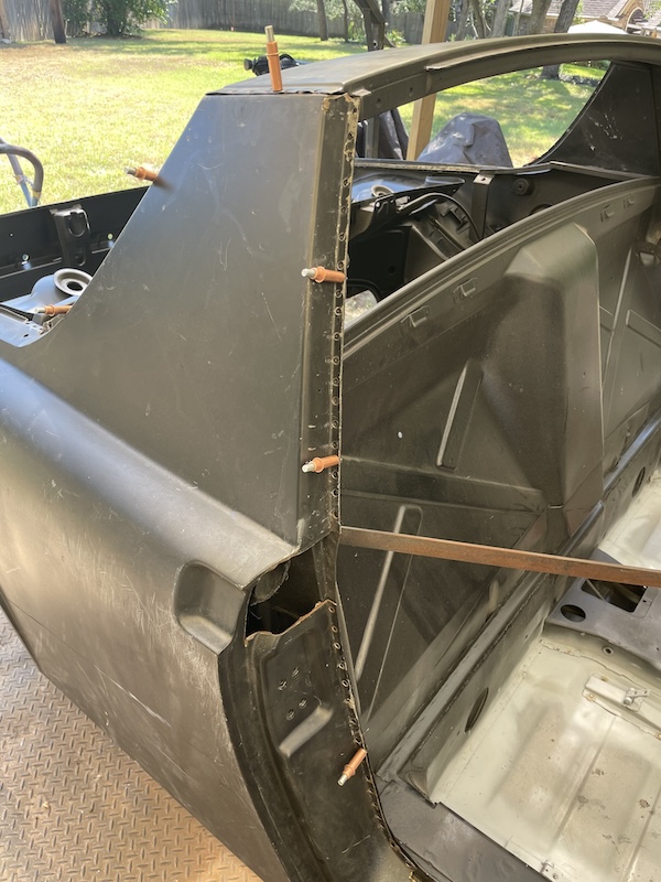

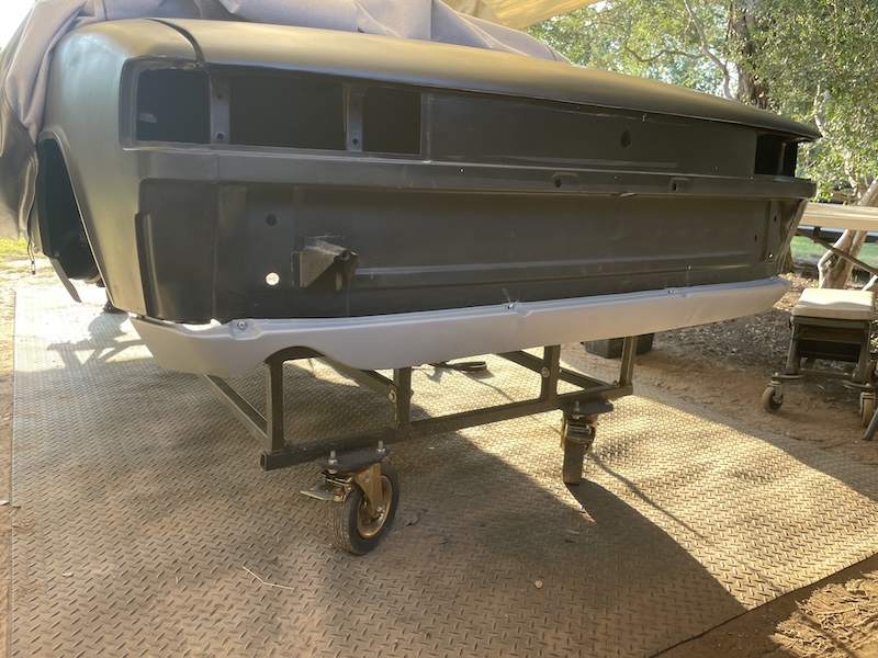

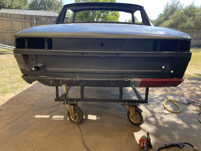

friethmiller   Back Panel Install (11/2023): Even though the car ...   Dec 24 2023, 10:24 PM

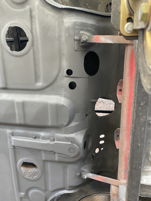

friethmiller   Passenger Inner Suspension Console Replacement - P...   Dec 28 2023, 08:27 AM
friethmiller   Passenger Inner Suspension Console Replacement - P...   Dec 28 2023, 10:32 AM
friethmiller   Passenger Inner Suspension Console Replacement - P...   Dec 28 2023, 10:50 AM

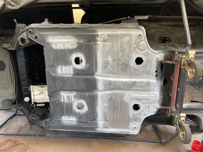

friethmiller   Trunk Bottom (12/2023): Another area that received...   Dec 29 2023, 10:20 AM

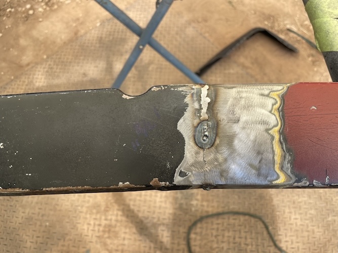

friethmiller   Drivers Side Longitudinal - Part 4 (1/6 - 1/7/2024...   Jan 7 2024, 08:10 PM
