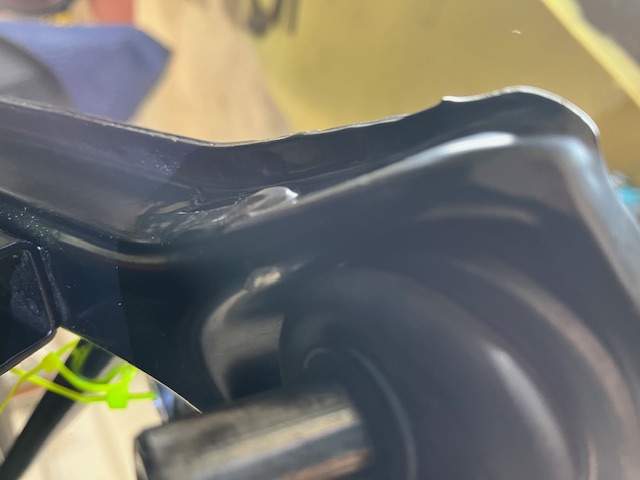

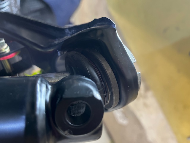

QUOTE(TonyA @ Dec 17 2023, 12:27 PM) *
Why would the bottom of the spindle be hitting the A arm when turning just above where it enters the ball joint. Not hitting on the other side. Seems like the ball joint wants to engage the spindle lower. Using URO parts 90134104900. Any ideas? Did anybody ever have the same problem? Also pet and schematics show a washer above the ball joint. What is the thickness? I don't have one on the other side where it's not hitting so that is not the problem.
i found the problem. I switched out the ball joint. The one I had (brand new) had the slot to receive the special wedge screw lower than the other one. Not much but enough.
See the pictures of what was hitting.
