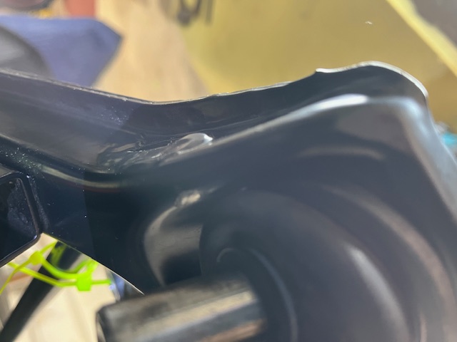

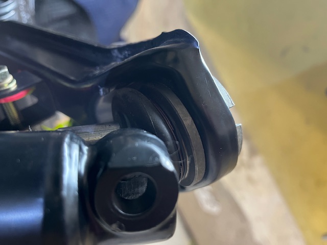

i found the problem. I switched out the ball joint. The one I had (brand new) had the slot to receive the special wedge screw lower than the other one. Not much but enough.
See the pictures of what was hitting.
