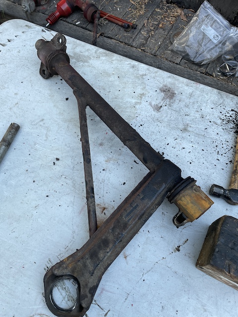

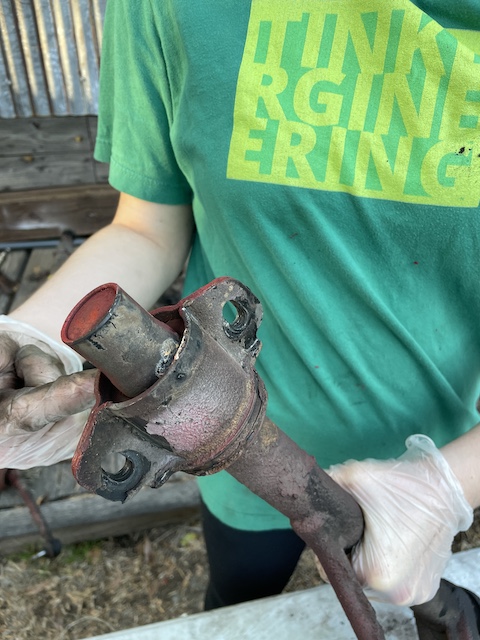

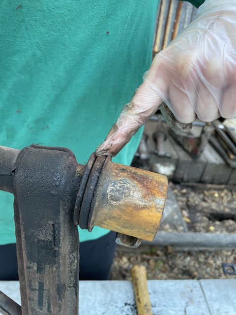

Hi. Frances and Dan from Tinkergineering here. Do these [see photo] end mounting brackets need to get pressed out, and if so how do I do that? should I need to heat it up? We got the front and rear suspension all removed. I know Ian had talked about the turbo tie rods. Why is this upgrade important/wanted?

I’ve used their rubber bushings on my LCA’s. They properly grip the control arm and don’t slip per design intent. Highly recommended. You don’t want the LCA rotating inside the bushing.

A press will make removal and install much easier but you can certainly get the job done with an inexpensive pipe clamp.

Bushings are a good example of 'if it ain't broke..." They are not easy and a press is recommended. I'd leave them be and just clean up the metal.

Easiest way to remove the bushings is to heat with a torch (outside your garage) until they smoke a bit and then pull them apart with some channel lock pliers or similar. New turbo tie rods don’t cost much more than stock ones but they are worth the upgrade. When it’s time to reinstall the new bushings, either use some all thread (plenty of YouTube videos or have a friend with a press set them in place for you. Ian’s videos are very good for the home diy suspension refresh.

Search through Ian's videos. Yes, those pieces come off. The new ones need to be installed at the right angles. Ian's videos do a great job of explaining that process. If you already have it removed, you might as well do the job right. Those bushings do de-form over time and become hard and lose compliance. It's not that difficult and is a very satisfying job to do.
