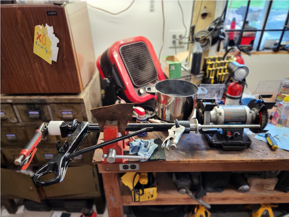

Hi. Frances and Dan from Tinkergineering here. Do these [see photo] end mounting brackets need to get pressed out, and if so how do I do that? should I need to heat it up? We got the front and rear suspension all removed. I know Ian had talked about the turbo tie rods. Why is this upgrade important/wanted?

A press will make removal and install much easier but you can certainly get the job done with an inexpensive pipe clamp.

Bushings are a good example of 'if it ain't broke..." They are not easy and a press is recommended. I'd leave them be and just clean up the metal.
Turbo tie rods are not that much better or I should say the stock rods are not bad. The inner bushing gets worn so if it's sloppy do the change over. Check for slop in the rack too. Also the rubber coupler between the rack and the steering shaft.
Easiest way to remove the bushings is to heat with a torch (outside your garage) until they smoke a bit and then pull them apart with some channel lock pliers or similar. New turbo tie rods don’t cost much more than stock ones but they are worth the upgrade. When it’s time to reinstall the new bushings, either use some all thread (plenty of YouTube videos or have a friend with a press set them in place for you. Ian’s videos are very good for the home diy suspension refresh.

The rear bushing is probably the only one needing replacement as it carries most of the vertical load and over time collapses so the torsion bar starts rubbing inside the LCR destroying the protective coating. That leads to failure due to corrosion fatigue cracking.

Search through Ian's videos. Yes, those pieces come off. The new ones need to be installed at the right angles. Ian's videos do a great job of explaining that process. If you already have it removed, you might as well do the job right. Those bushings do de-form over time and become hard and lose compliance. It's not that difficult and is a very satisfying job to do.

I don’t agree. The fronts always need replacing, at least on all the 911’s that run through our shop. They are 50 years old. It’s one of those things that you do when you are rehabbing the suspension. Who’s going to blast and repaint the a-arms and not replace the old bushings. When they start to collapse, the torsion bar rubs on the a-arm and causes damage.
On a 50 year old car, you really have to look at every nut, bolt and bushing and plan on rehab and replacement. You don’t want to send Frances down the road in a car that’s not 100%.
