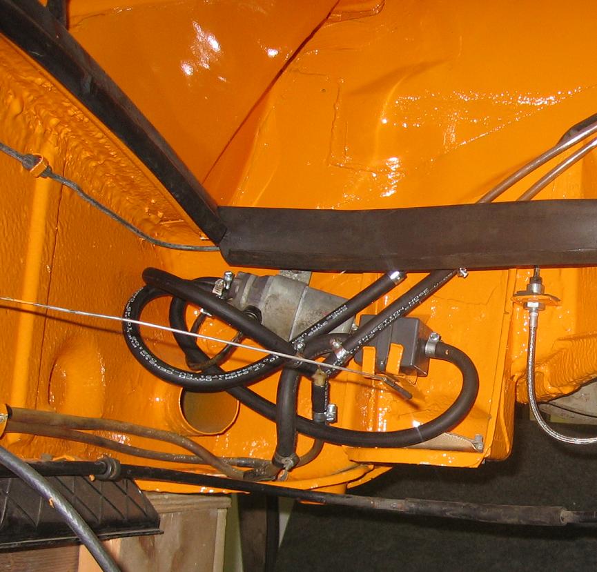

Hello this is the mounting for th Filter. See the attached picture
Greating from Vienna Cornelius

Question as to the hoses, the lighter colored hoses seem like the old plastic that was original equipment? can you verify if they are stainless (that is stained) or plastic?

QUOTE(ctc911ctc @ Jan 5 2024, 09:14 PM) *
Greetings!
Thank you,
CTC911CTC
QUOTE(cpeter @ Jan 5 2024, 10:23 AM) *
Yes, that is original plastic fuel tubing. And the original plastic Y junction.
Very unusual to see those original parts still in use.
The hose routing is difficult to follow and could be made neater but it was
a crowded arrangement from new.
On a 914 6 one plastic tube extended up to the carb supply
