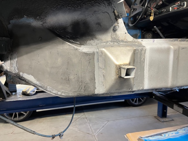

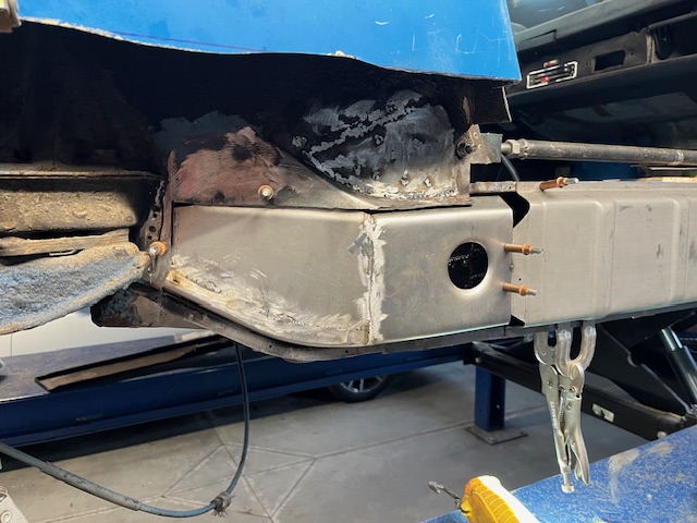

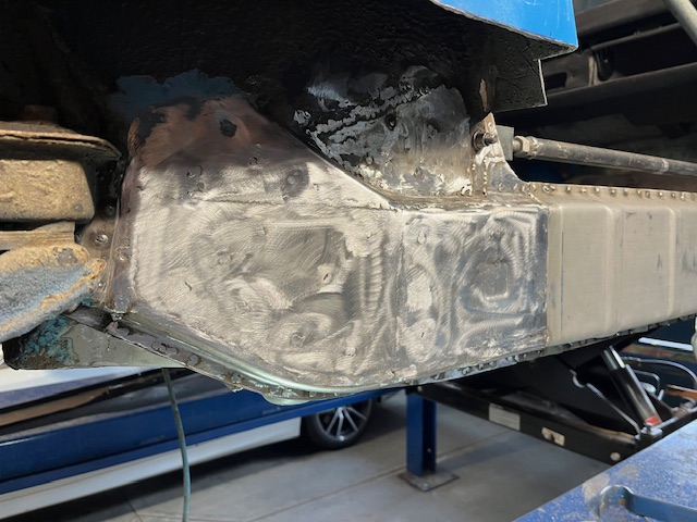

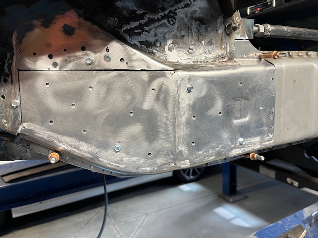

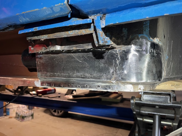

Making good headway on the repairs on the right side. Got the inner long repaired, and rebuilt the front corner of the long by the A pillar. Fabricated the inner and outer skin of the outer long ahead of the suspension console. Reinstalled the heater piping and welded in the outer skin of the long.
Next up is finishing welding in the newly fabricated parts and a whole bunch of grinding.

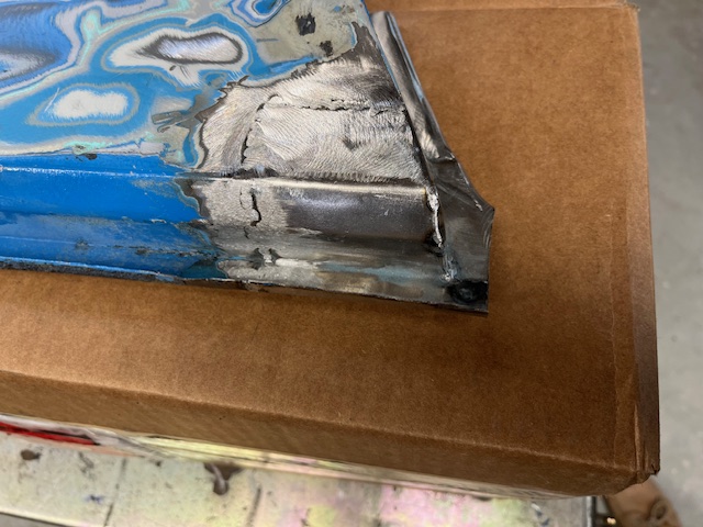

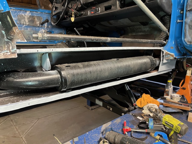

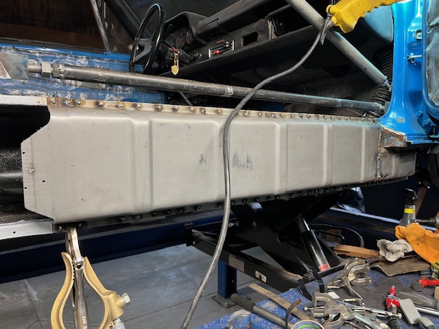

Got the rear long panels all welded up and installed the jack pad and seam sealed it.

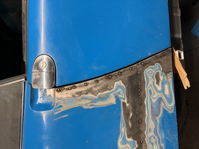

Addressed rusty portion of the fender panel before tack welding it into place. Door gap was tight when we started, but really tightened up more after all the welding on the long even with the door braces. Had some good input earlier from @Superhawk996 to wait to address this.
With the fender tacked in solidly, went to work on the door gap and got that looking pretty good, by slitting the fender and repositioning the door frame edge and tacking it.
It feels good to have the major structural repairs done and to have the door closing ok and restoring the door gap.

If I wasn’t so attached to doing things the hard way, I would have cut my rear quarter in order to better control the gap. (IMG:style_emoticons/default/laugh.gif)
Looking really nice!

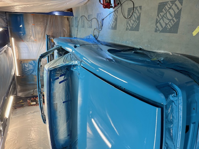

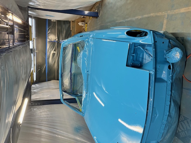

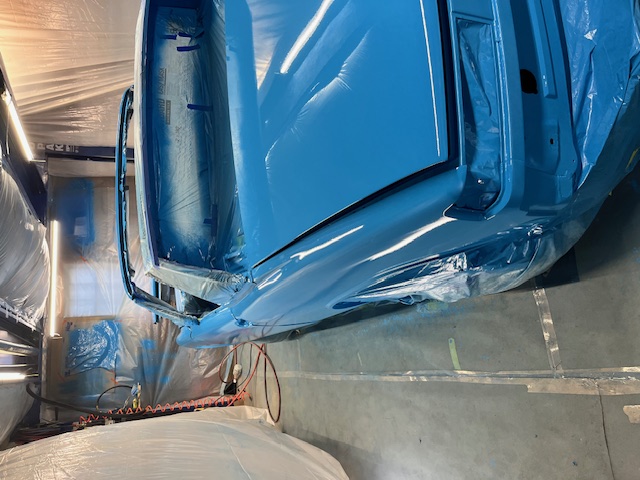

After taking to summer off on this car, we spend the past month prepping the body for paint and shot the paint on it today. The PO had painted it something similar to Laguna Blue, but we returned it to its original color. This is single stage 2K urethane. Looks like with a little wet sanding and buffing we’ll have a pretty decent paint job.
I really like this color.
Tim
