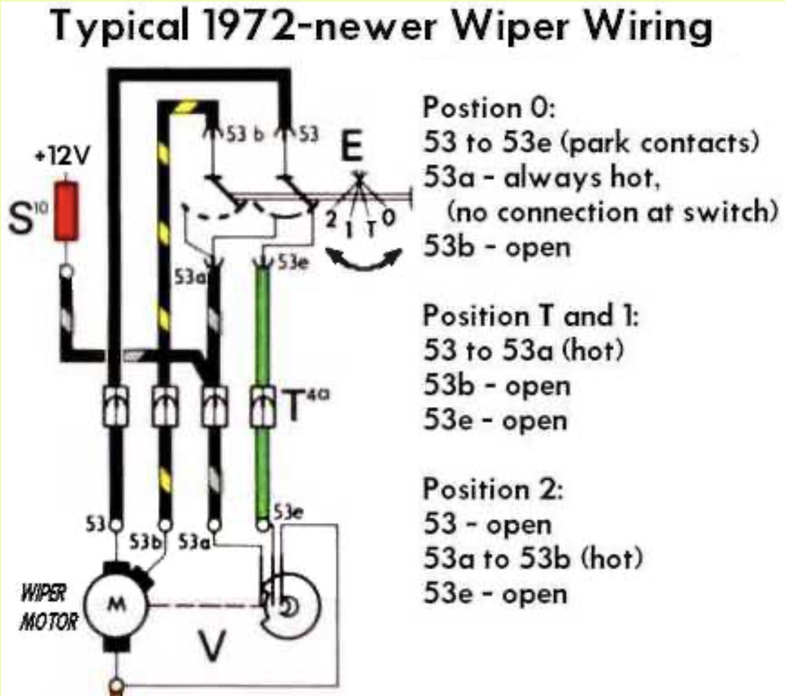

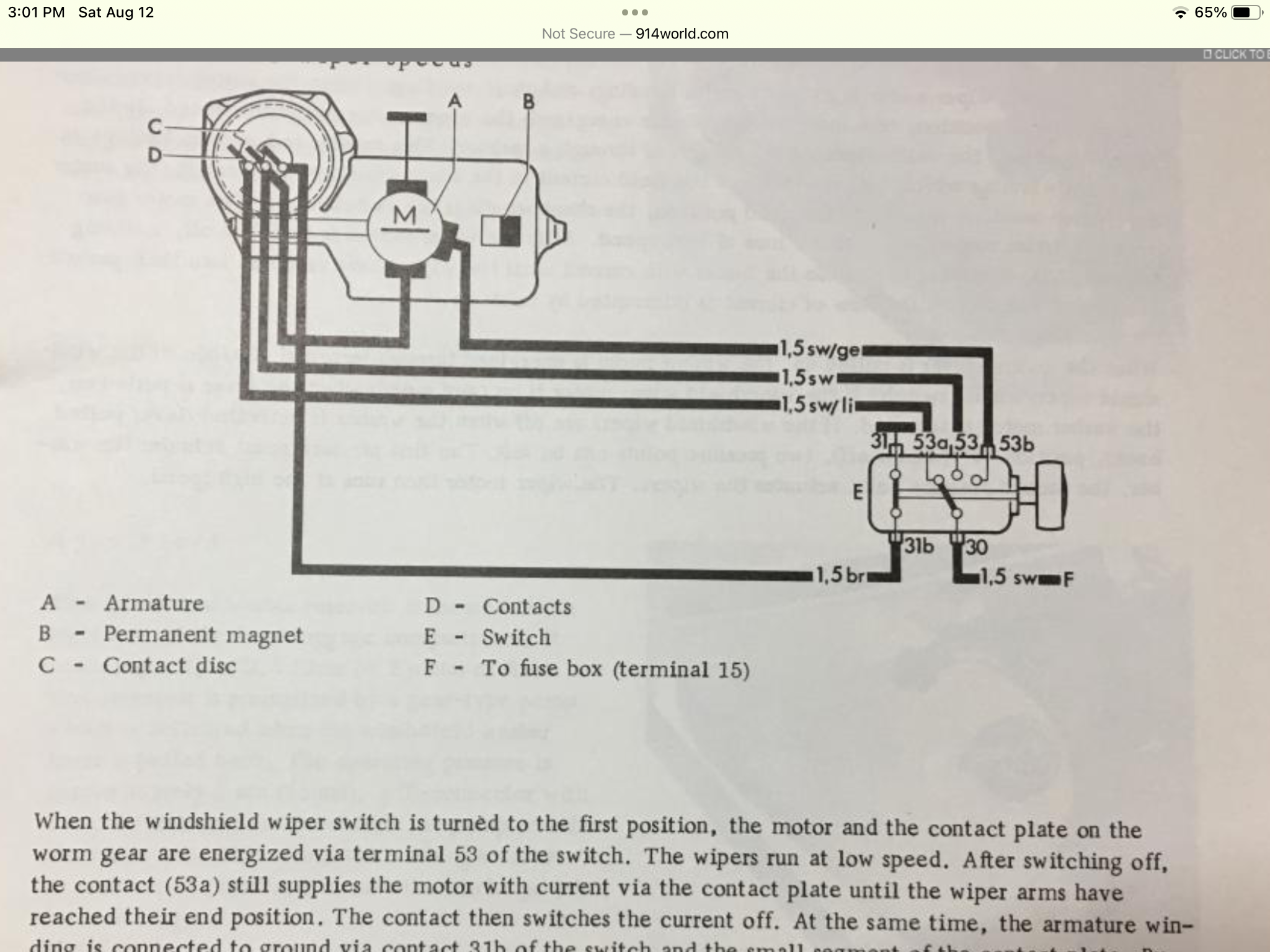

A bit ot, but which wire is for parking the wiper arms?
mgarrison
post Jan 9 2024, 08:32 AM
Posts: 398
Joined: 14-February 20
From: Chandler, AZ
Member No.: 23,922
QUOTE(pek771 @ Jan 9 2024, 05:33 AM) *
I could really use the answer to this question as well!
#53 = slow speed
#53B = fast speed
#53A = UNKNOWN
#31B = UNKNOWN
Hoping the 914 World Gurus have an answer... (IMG:style_emoticons/default/pray.gif)

This is what I used/referenced when I wired my wiper motor
