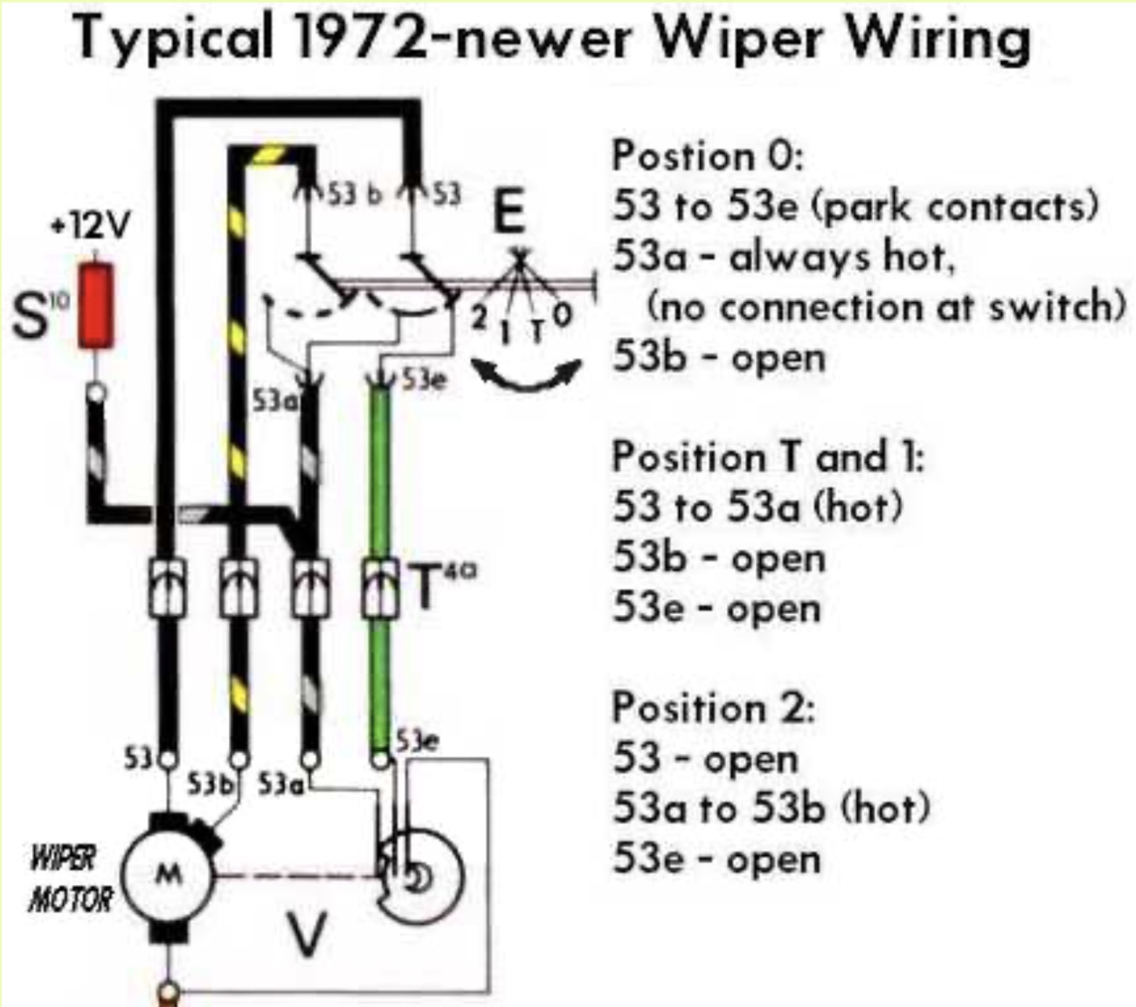

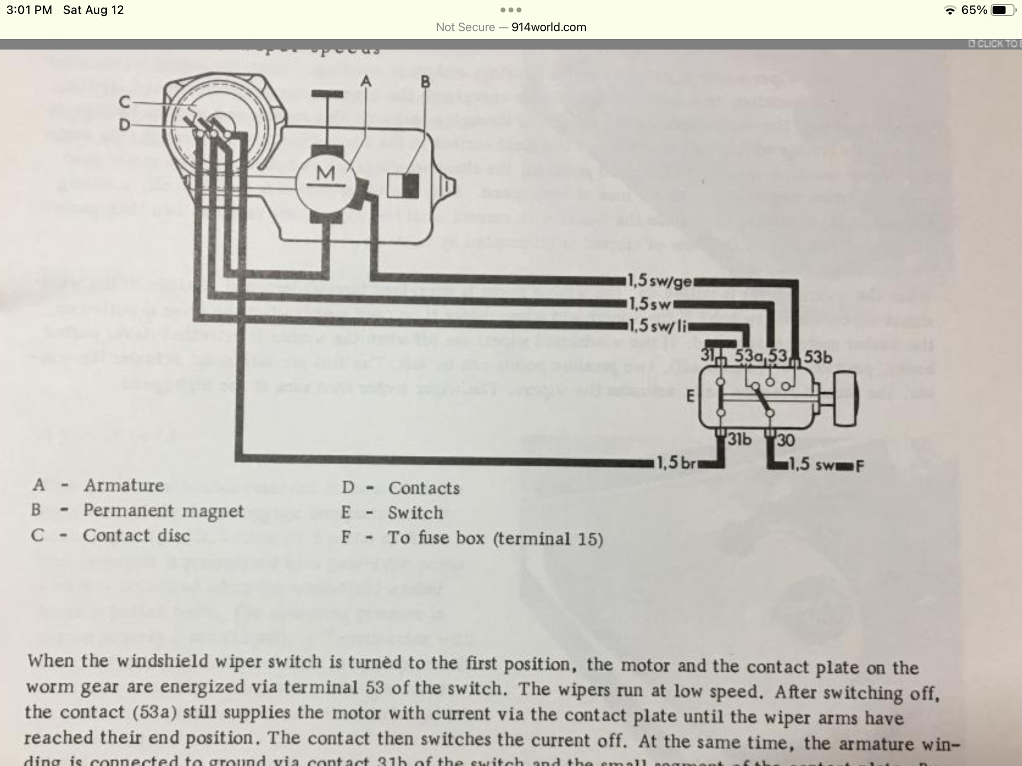

A bit ot, but which wire is for parking the wiper arms?

I could really use the answer to this question as well!
#53 = slow speed
#53B = fast speed
#53A = UNKNOWN
#31B = UNKNOWN

This is what I used/referenced when I wired my wiper motor
